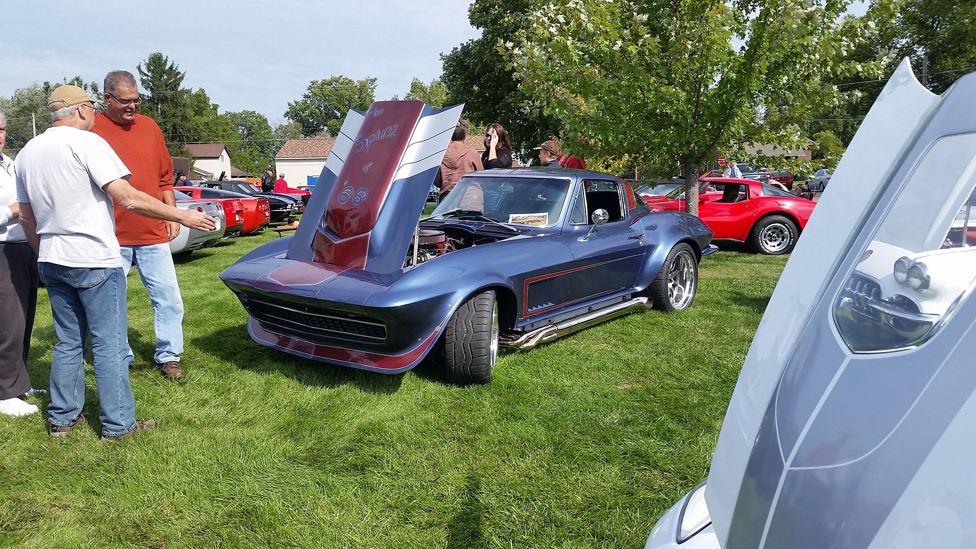

Made it out with the SO66 today. Had fun watching people walk up to it and see there facial expressions, like what the...
Met with Dave, in orange shirt, the guy that built it in 75/76. It was fun talking with him about the car. He didn't know we were coming and said how happy he was seeing it again. Brought back lots of memories for him.
