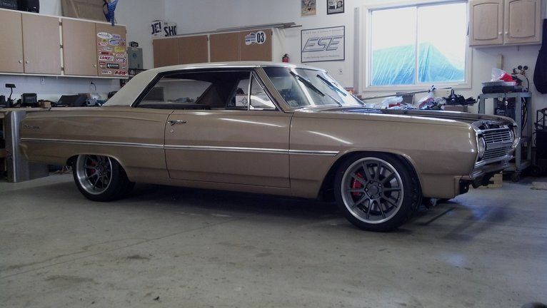

Pics, took this the other night:

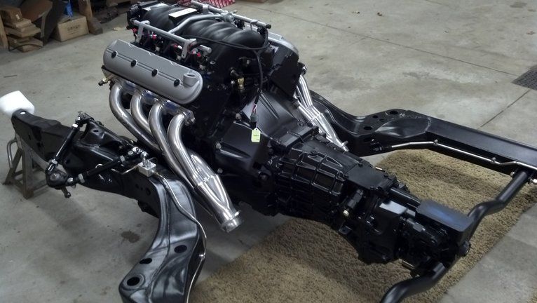

Some of the motor/trans (basic LS1 rebuild, small cam, intake, Holley HP)

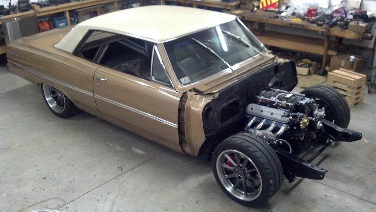

Some more of it on the chassis:
Sitting a bit high, but I'll take care of that

I'm a fan of the "grandpa gold" and white. I like how it looks and the wheels tie it together. 42 days.....
j/k. Good luck, keep up with the pictures.

Looks like a really nice platform to start with and I'm not seeing much patina. I personally love the patina look.... pure wabi-sabi

Yeah I've seen the. The patina is pretty limited. It's a sharp looking car and the wheels look awesome on it. Lot's of cool details over on TC to check out and I'm looking forward to seeing this one done next month.

Oh, it looks better in pictures. Still, a very solid 48 year old girl. Still has a lot of the original paint and some that's not. Interior is all there and original minus the bench seat. Using the T/A bucket seats. Some day I'll recover them to go with the saddle interior.
