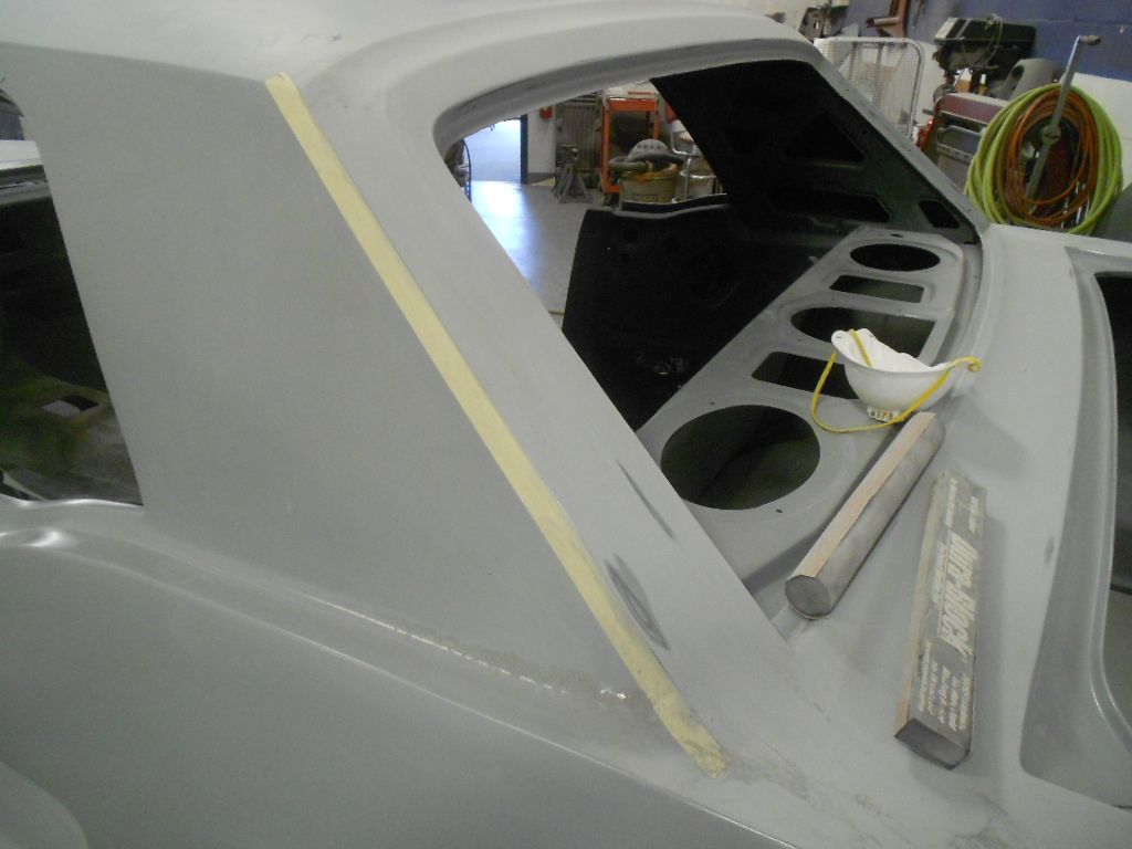

In the middle of a lot of block sanding and looking for any imperfections
http://img.photobucket.com/albums/v3...psgpi9lwis.jpg

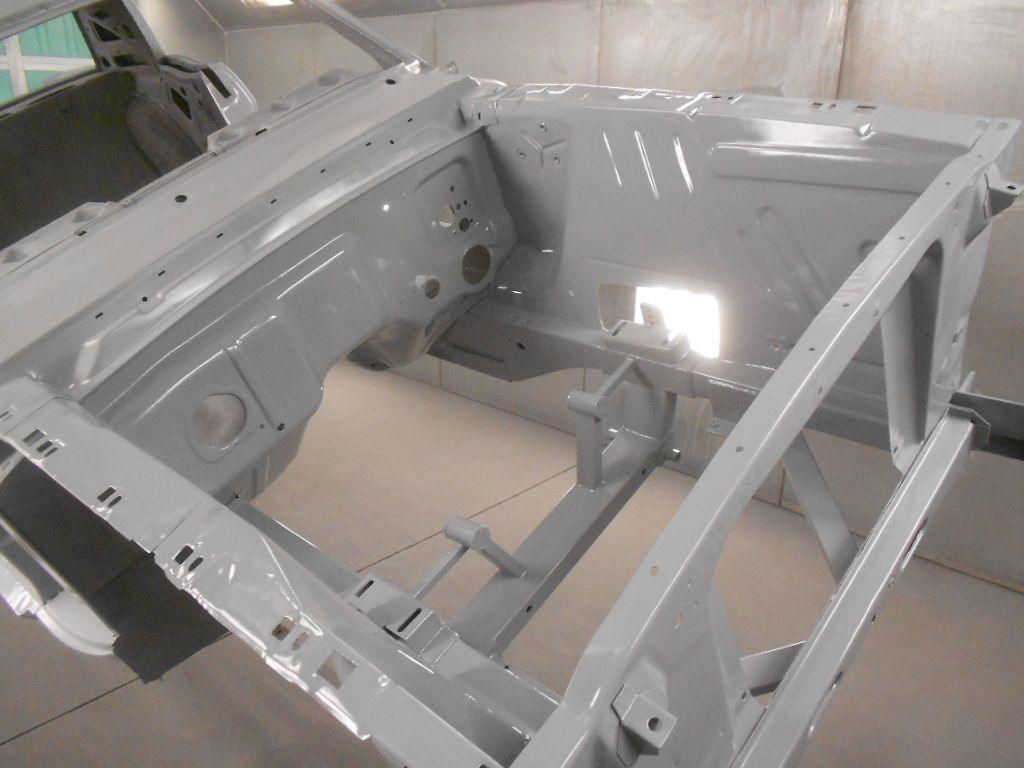

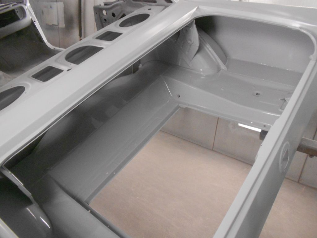

The engine compartment was sanded and epoxy primed
http://img.photobucket.com/albums/v3...pstvud6uff.jpg
http://img.photobucket.com/albums/v3...psphpnjjhw.jpg
