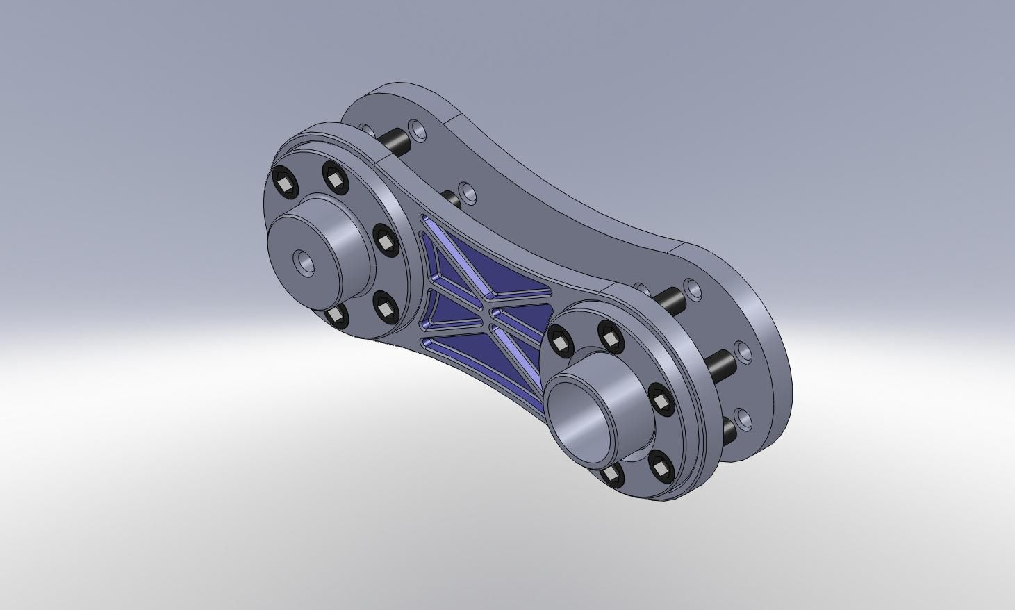

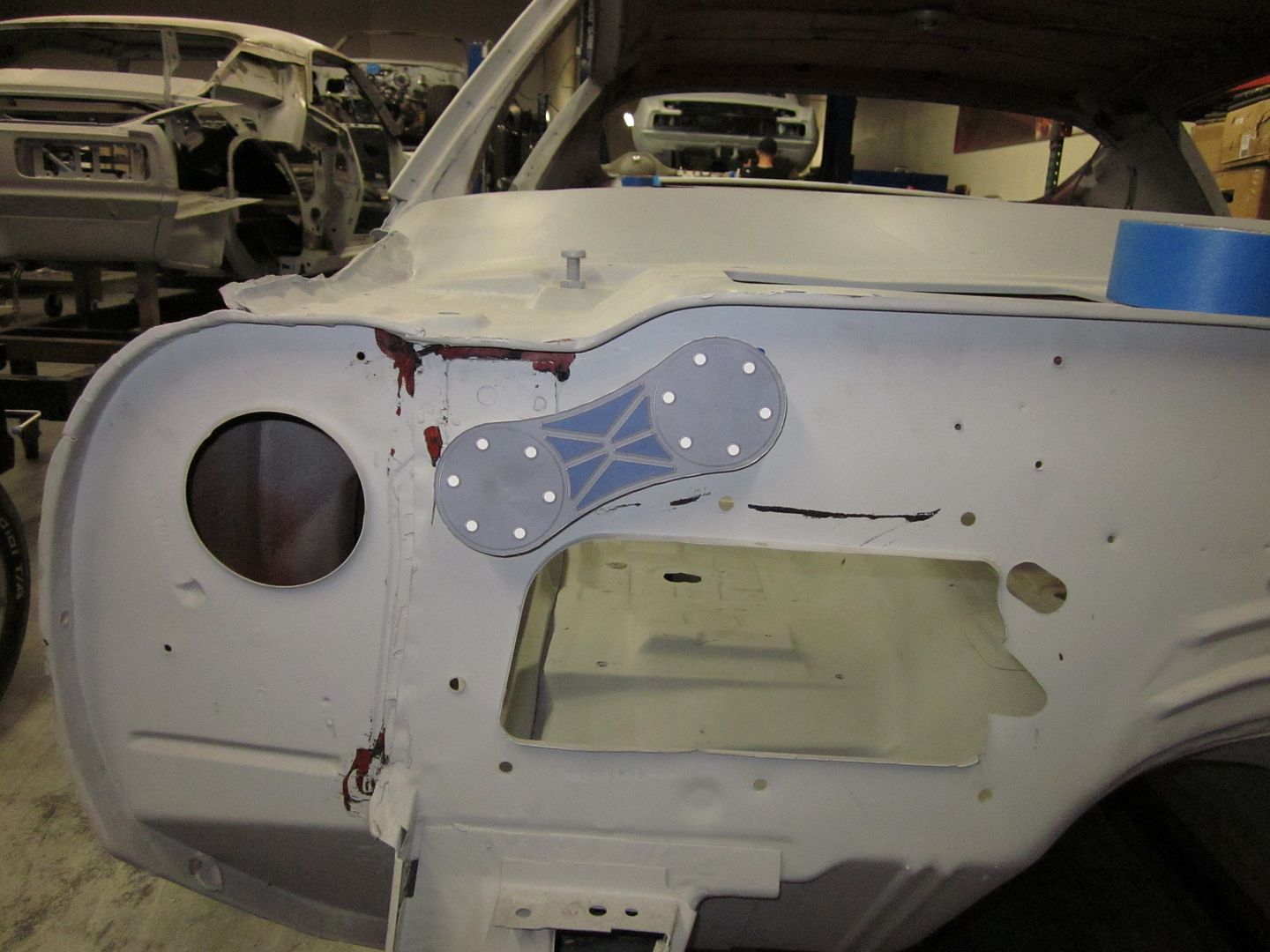

Firewall Roll Bar Flanges
So, we want to make tie down bars from the firewall to the sub-frame.. Here is what we designed tonite.. I will be machining parts in couple of weeks & see how they work..
http://i1015.photobucket.com/albums/...CAGE_Assem.jpg
http://i1015.photobucket.com/albums/...n/IMG_0445.jpg
HWY Nova 09-21-2010 07:36 AM
Cris,
It looks like the downtube will attach to the right-end of these machined pieces. What attaches to the other end?
--Eric
Cris@JCG 09-21-2010 07:45 AM
Eric,
The view of the model shows that left side will elimnate the factory mounting for the fender & replaced with machined pcs.. The right side will be for the down tube that slips over the & has a chamfer so that when welded it has a nice clean bead.. I have to mount my sub-frame & see how we are going to tie it in but more than likely will be another machined flange welded to the sub-frame.. Still trying to decide if we are using a factory frame or aftermarket.. Wanna design one??? LOL
Getting tube benders quoted right now & we will have one in the next couple of weeks..
Originally Posted by HWY Nova (Post 306683)
Cris,
--Eric
