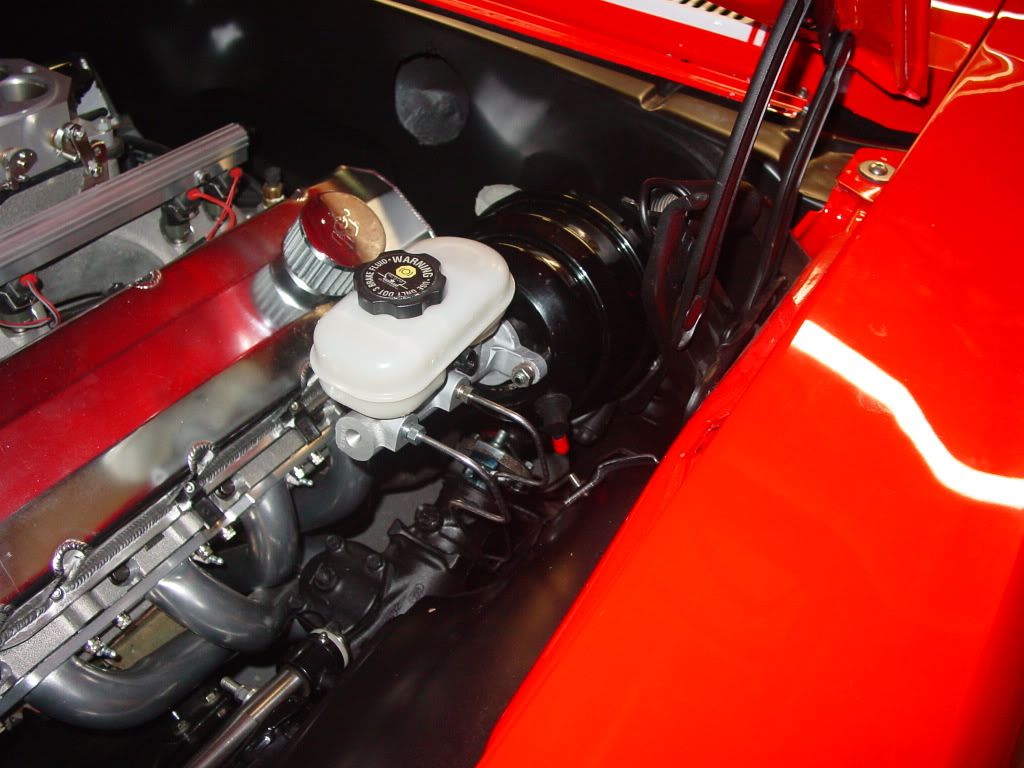

That's the type of tubing I used...it wasn't too bad to bend, but you will need a good flaring tool...my cheapy tool from Jegs broke after two flares.
I ended up buying a Rigid and it worked perfect.
Jason
http://i519.photobucket.com/albums/u...o/DSC02329.jpg
