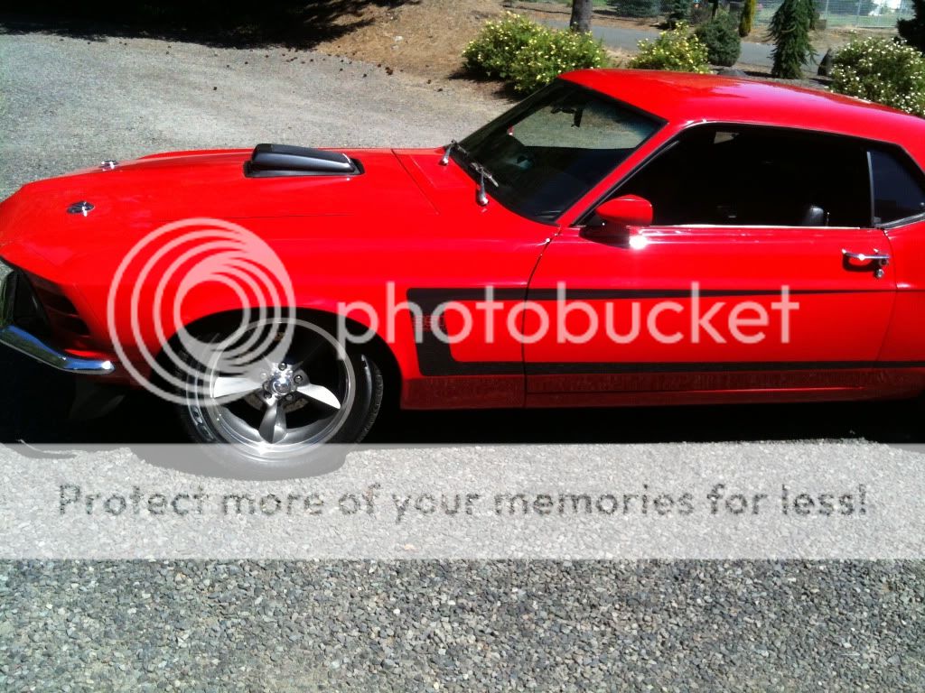

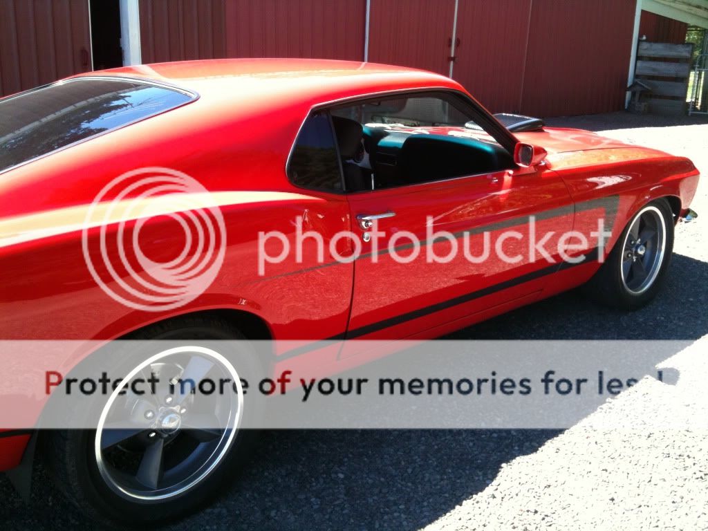

we painted the body torch red and then decided to put a graphic on the sides that we stole the idea from the GT2 fastback

byndbad914 08-17-2010 06:09 PM
I had a 70 Grabber Sportsroof that had reverse C stripes just like a 69 Boss 302 (without the words) and look similar to what you have painted, so there was a 70 Mustang with similar striping available from the factory. FWIW ;)

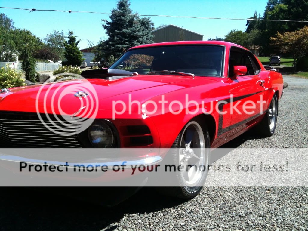

Couple more pics. almost finished with the car had to finish wiring in the flaming river tilt column and a few other wires for the vacuum pump for the booster as the engine only makes 12 in vacuum. just have to install the new 1" bore wilwood master to up the line pressure as we only had 800 psi with the 1-1/8" bore master, bleed the brakes and give it a final polish and its back to the owner.

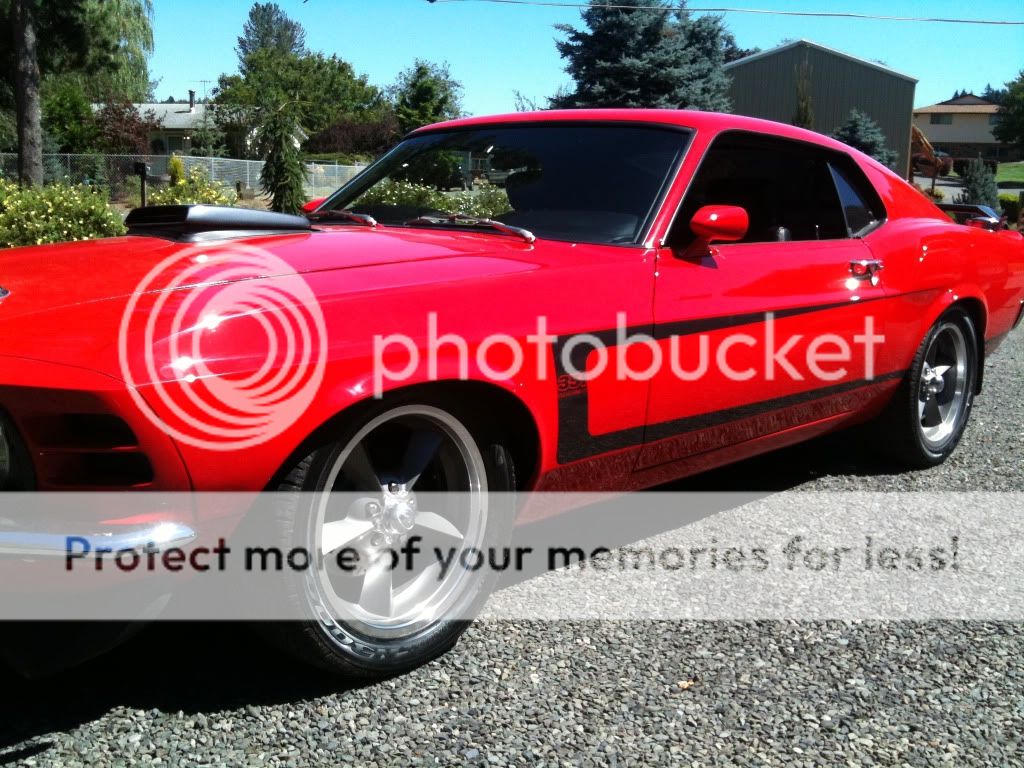

Well except for a final detail in the morning She all done for now. Got the new 1" bore master installed and finished the wiring and took her out for a spin this afternoon. I'll post some better pics tomorrow after she's all detailed.

lhkustoms 08-24-2010 08:14 PM
Well we got the car finished up today and delivered it to the owner. Now onto the next project :)

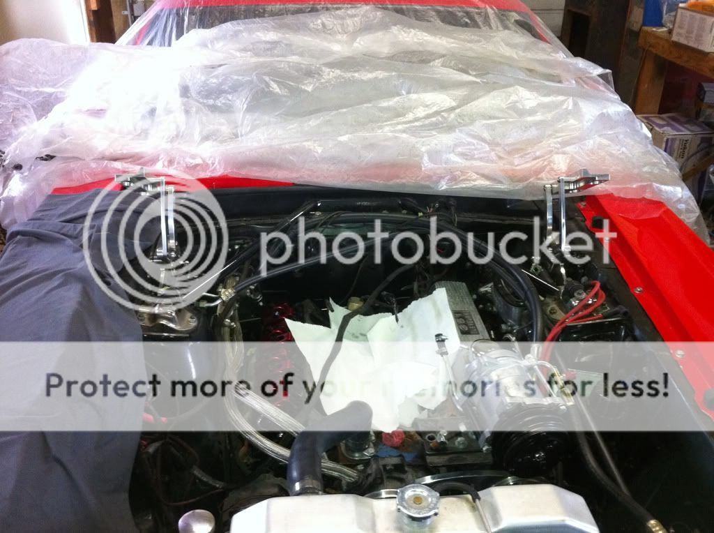

Well the mustang is back for more power. The owner decided he needed more power so we are swapping the factory 4V heads for aluminum AFD 4V heads and intake. So I began teardown last week and were gonna get the new heads on and just waiting for the intake. It's stuck in Customs right now but should be here by the end of the week. We're taking about swapping in a set of Ridetech coilovers and a 4 link in the rear but we'll see.
I'll get some more pics up later this week.
