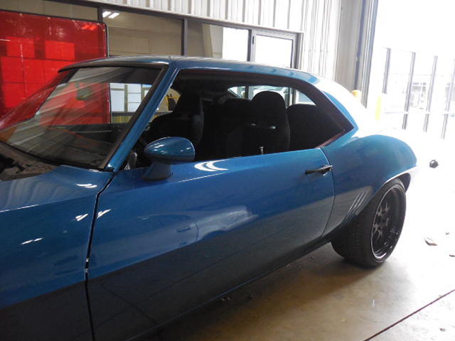

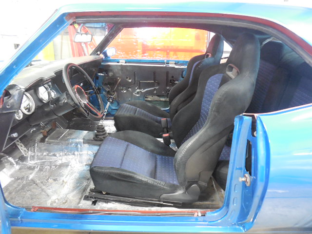

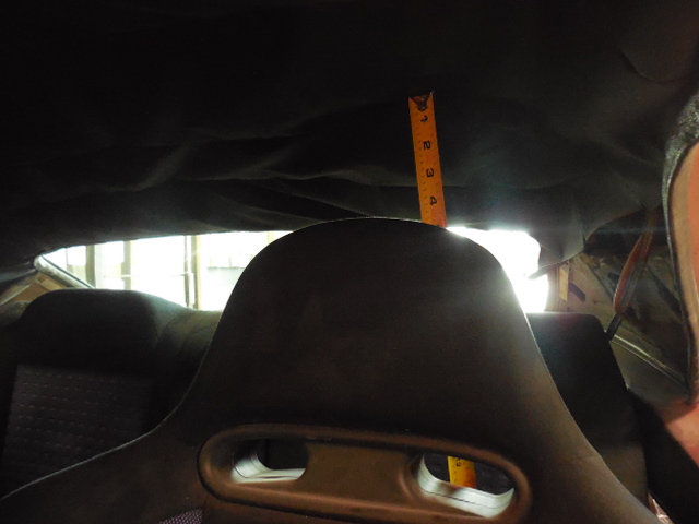

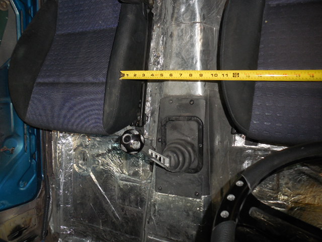

5 Attachment(s)
Attachment 47407
Attachment 47408
Attachment 47409
Attachment 47410
Attachment 47411
colburn22 04-10-2014 03:58 PM
I'm 6'4'' and have couple inches of headroom with these evo xiii seats and wedge brackets...I'm also going with the rear ego seat as well but still a work in progress

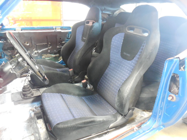

1 Attachment(s)
I have the same seats in mine.
