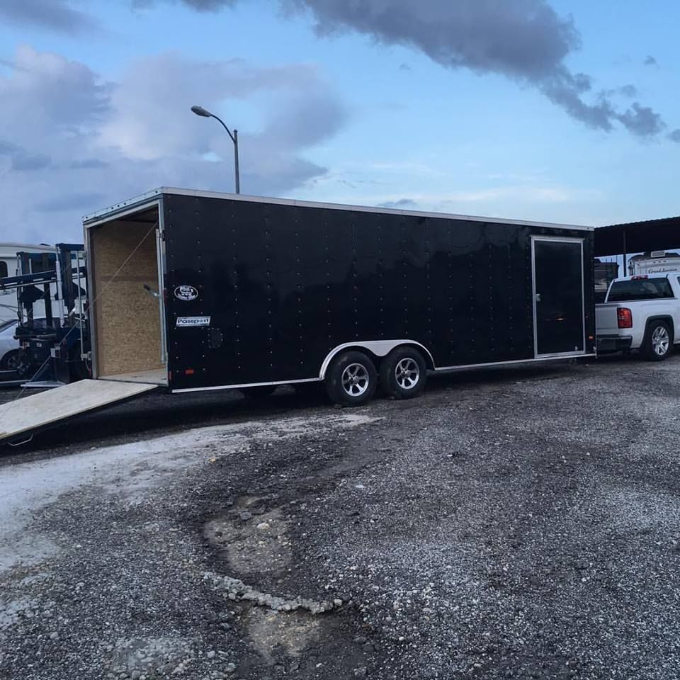

Nate, this is what we used for Thunderhill earlier this year. The trailer is a 20' and doable but you end up running out of room after the track supplies are loaded.
The truck, no issues. Super comfortable, quiet and would pull any hill from Seattle at 70+. I'd look down and realize I was doing 85, never felt like the truck was working. The bad, even on the flats of Northern Cali we couldn't get any better than 9.5mpg. Hackster was laughing at us as he was pulling his truck down on an open trailer with his older Cummins knocking down 16-17mpg.
:cheers:

I think it's a Continental and am almost positive the axles were 5200lb. It's basic, cheap carpet, diamond plate on the ramp and thin ply half way up the walls...no frills. Everyone around here has open trailers, we rented this one to make the trip down not wanting to deal with the winter weather, which we ran into, none.
As far as the truck, I can't say much because I don't buy anything new. I do know it had the power and was nice and comfortable. If it's anything like the older diesels you'll see better mpg the more miles you put on it. Come to think of it, we were laughing about how it seems to go into regen when you need the power...:lol:

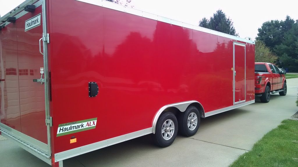

I just bought a new 2016 24'x8'6" Hallmark Passport V-nose enclosed trailer a few weeks ago for $7300 out the door with 5200lb axles, upgraded lights, floors, and .030 metal.
And before anyone says anything, no my truck isn't hooked up to the trailer in the pictures, it had a 4/7 drop on it and I traded it in last week on a diesel anyways.
