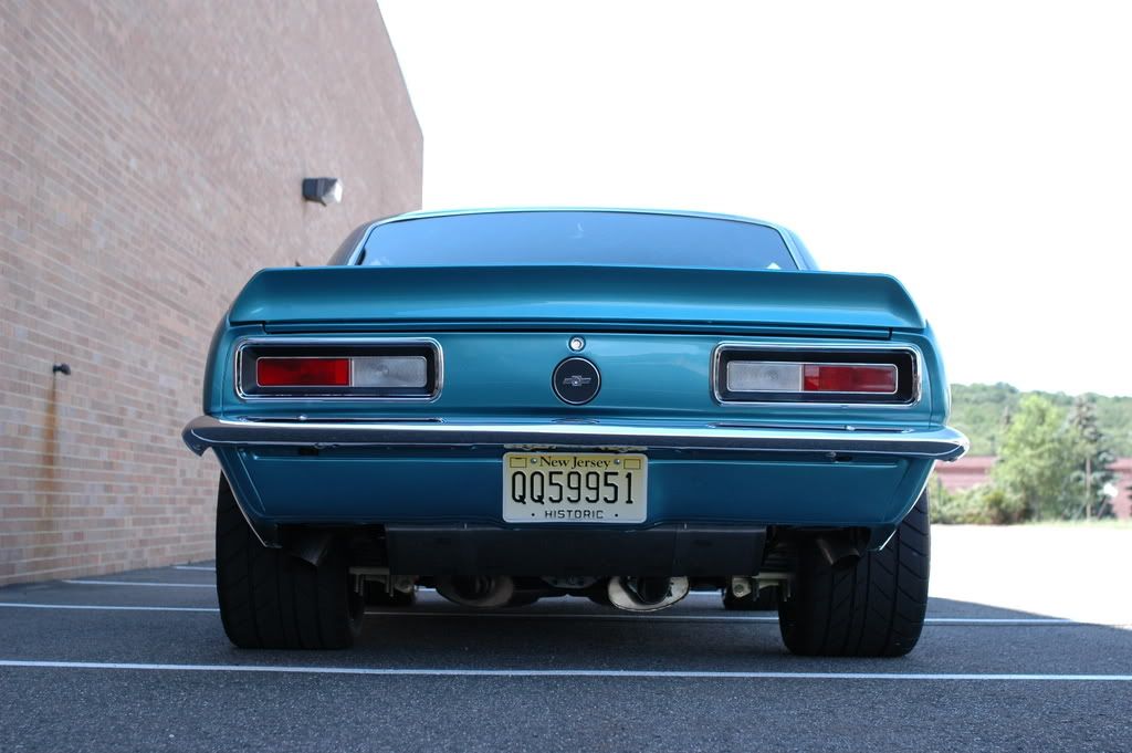

67ragtp 07-25-2007 04:44 AM
That probably would have helped, unfortunatly I had to have that shiny SS tank. Now Im cutting these tails and screwing around with band clamps trying to piece it together. I got frustrated a couple months back and tore them off and put 60 degree dumps on the back of the muffs but its just to loud. I really want to drive the car and dont want it to drive me crazy.
http://i168.photobucket.com/albums/u...p/DSC_0041.jpg
Rich
