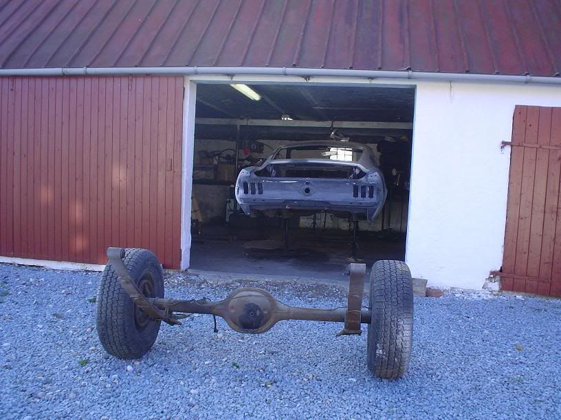

http://i168.photobucket.com/albums/u182/Riisager/5.jpg

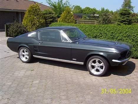

Before 2004
http://i168.photobucket.com/albums/u...isager/4-1.jpg

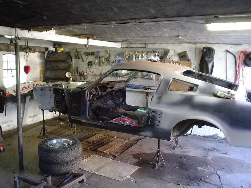

The disassembled is started
http://i168.photobucket.com/albums/u...c00453_172.jpg

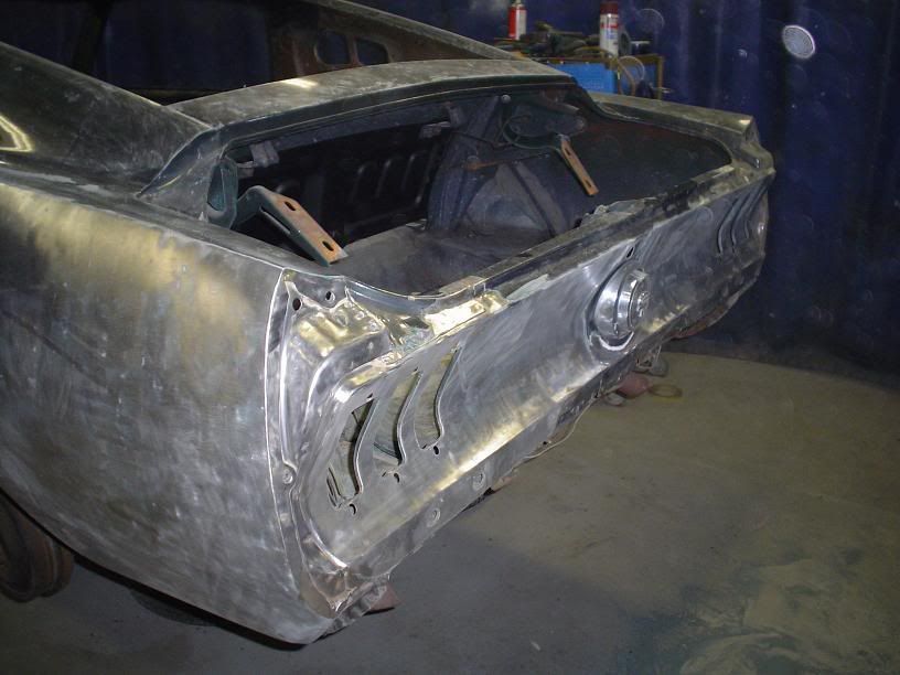

The paint comes off.
http://i168.photobucket.com/albums/u...c00457_163.jpg
Luckily not alot of rust

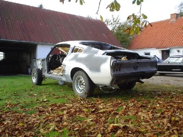

http://i168.photobucket.com/albums/u...ger/Garden.jpg
Primed

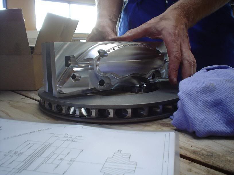

http://i168.photobucket.com/albums/u182/Riisager/3.jpg
The new brakes rear are almost done too.
They are custom made, so that the brakes wonīt be like all the other ones.

dave96dcm 08-26-2007 11:17 AM
I like the looks of that caliper alot, I will be following this thread.
