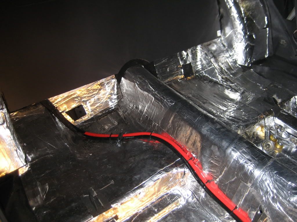

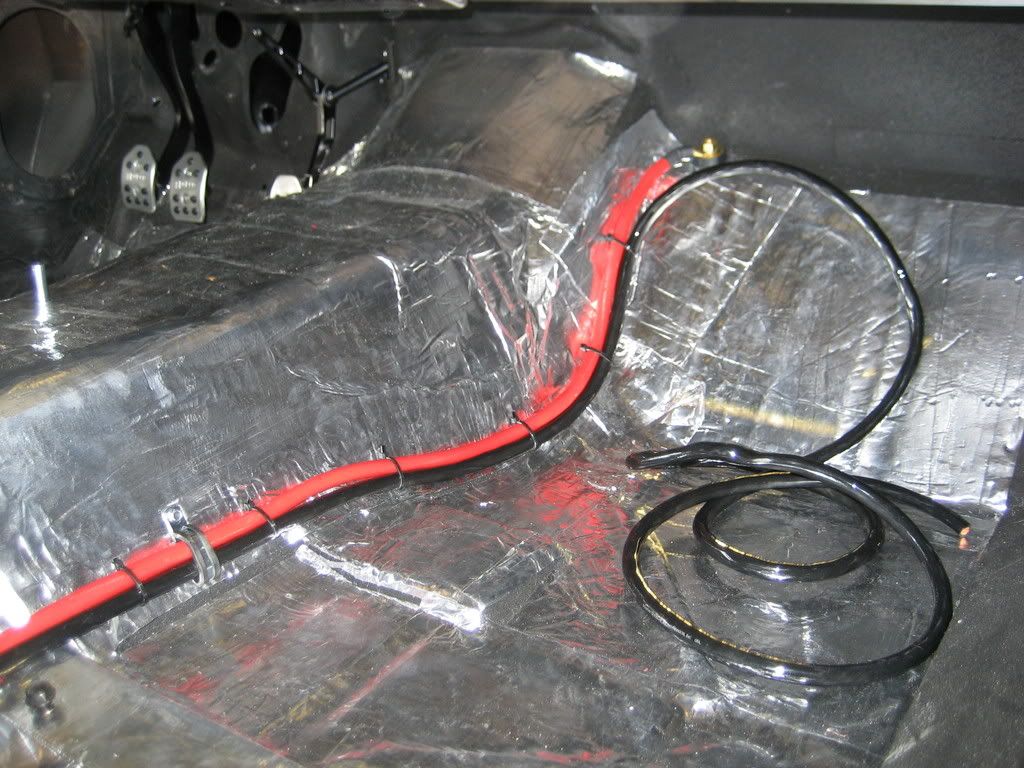

Vegas69 11-20-2008 07:20 AM
Can't tell mine exist where I routed mine.:unibrow:
http://i200.photobucket.com/albums/a...9/IMG_0773.jpg
http://i200.photobucket.com/albums/a...9/IMG_0757.jpg
Then I installed 3/8 jute on top of my sound deadener and cut it around the cable so they were recessed. If you want you could even tape over them with aluminized tape like I sealed my joints with on the jute. Didn't think it was necessary. Then I used a bulkhead for the positive on the flat shelf above the kick board. Grommet for the negative.
