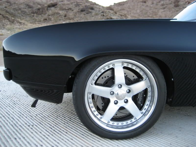

Have almost 2000 miles on mine. The black was completley gone in less than 50 miles. If there is still black towards the outside of the rotor they haven't shimmed the calper correctly.
http://i57.photobucket.com/albums/g2...s/IMG_1270.jpg
