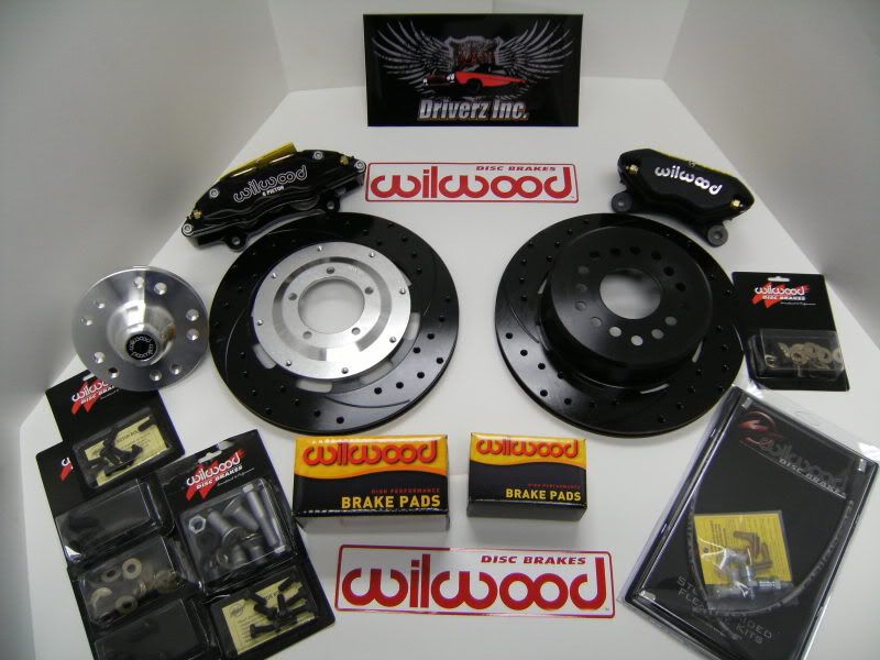

Dion, Wilwood is a good way to go. We have set up a lot of guys on the forums with the 12.2 6 piston front/12.2 4 piston rears with tons of positive feedback. Wilwood does not have a 6 piston rear caliper. Either way I can get you into the mentioned above with all the goodies to make it work ie. drilled/slotted rotors, Wilwood master cylinder, Wilwood prop valve, Wilwood front braided lines, etc for $2400. Feel free to give us a call if you need any help picking a kit.
http://i2.photobucket.com/albums/y8/...z/DSCF2457.jpg
