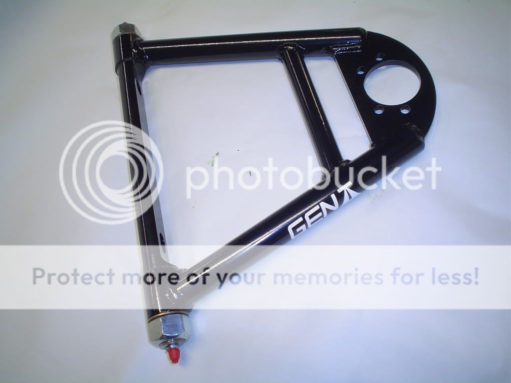

Jake, the king pin angle (kpi) on a stock spindle and ours as well is 8 deg and the B body kpi is 10 deg which makes your upper a arm 1/2" too short. We do offer the 10deg taper ball joint inserts as an option but you will need to replace the upper A arm. We do offer the Gen II uca for $299 including stock ball joints and we can install the stock taper upper inserts and the b body 10 deg taper lowers in the spindles to fit your application if needed. We offer the Gen II upper & lowers for $800 as well. Here is a pic of the Gen II uca.
http://i370.photobucket.com/albums/o...e/AbodyUCA.jpg
I would stay away from 2" drop spindles if you are wanting to really improve the handling as you would want to install our non drop spindle and then lower the car with springs to get the lbj pivot level with the mounting bolts and the car will be too low to do this if using drop spindles. Feel free to give me a call if you have any questions.
