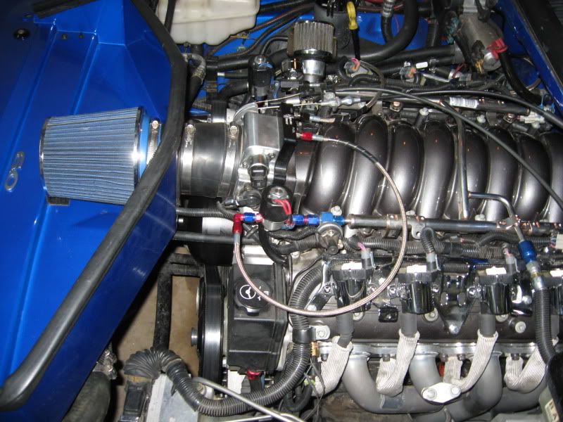

tooblue 09-17-2011 11:21 AM
I sanded smooth Primered ,sanded, basecoat clearcoat,, 5 years no flakes no problems. I used normal automotive finish paint..
http://i141.photobucket.com/albums/r...5/IMG_2412.jpg
