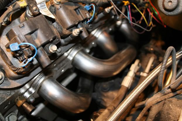

http://img.photobucket.com/albums/v4...p/IMG_1553.jpg ...you can see here, the primary for cyl #1 is probably less than 1/2" from one of the corner bolts on the steering box, and cyl #3 runs slightly better clearance, probably between 1/2 and 1". It fits, but you probably need some sort of heat shield between the lines and the headers - my PS pump whines badly when the car gets hot, and I'm sure that's why... I will add, I removed my Z-bar when I swapped to a T56, so clearance with that part is not an issue for me. -Adam |

I agree the headers are nice.Also they don't make there own motor mounts. The problem is I wanted to keep the motor in the stock location for f/r balance and that the perfect-fit rs-600 from keisler would work. I might be wrong but dont the ats mounts move the motor foward a considerable amount? The problem is I spoke with and emailed SW and told them just what I had and wanted to do . There answer was they would definitly fit. Just for the record the rs-600 doesn't fit well either the tower is at least a 1/2" to far back from hitting the factory hole.
