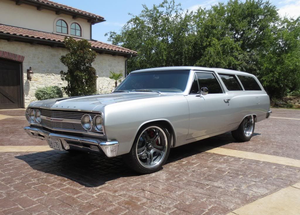

Kenny probably said that because 8 and 8.5 are standard 20" widths. 9.0 is not. The 9 is snug but we've done it on them before in 18 and 19
http://i256.photobucket.com/albums/h...psb1ffeadb.jpg
