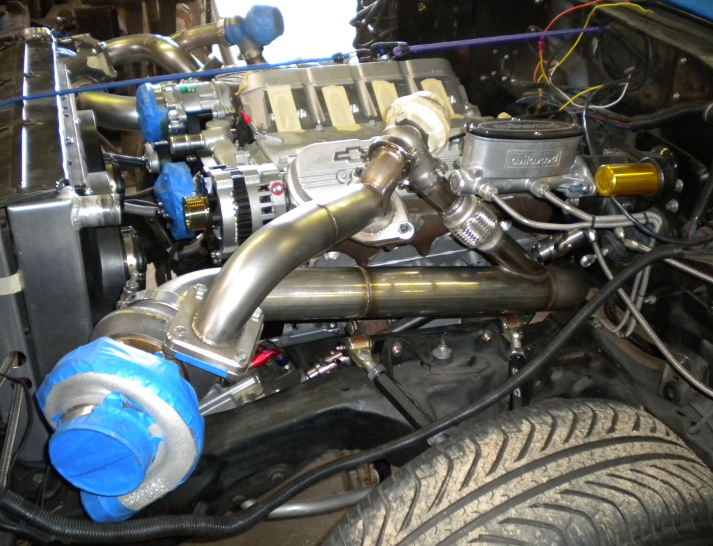

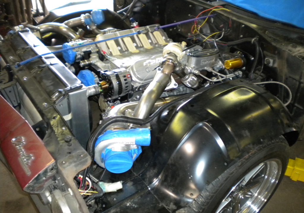

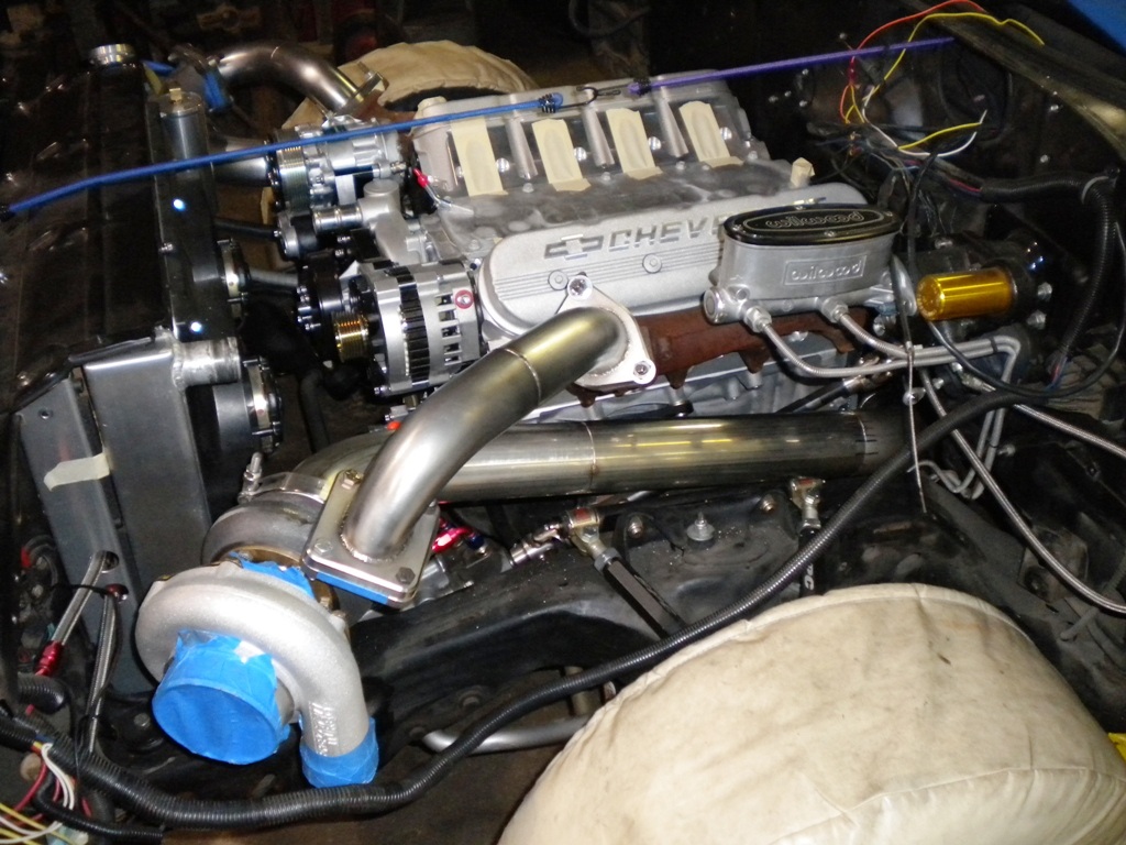

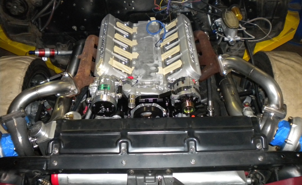

I understand looks, symmetry, artful and tasteful placements, BUT form follows function, right?
You had it by the ass in this initial mockup:
http://www.hydratechbraking.com/images/turbotubes1.jpg
http://www.hydratechbraking.com/images/turbotubes2.jpg
It is my opinion that you then did the Ooopsey with the placement of your waste gates:
http://www.hydratechbraking.com/images/turbo2.jpg
http://www.hydratechbraking.com/images/turbo7.jpg
I do indeed understand the money you have into the "silly little exhaust pipe"

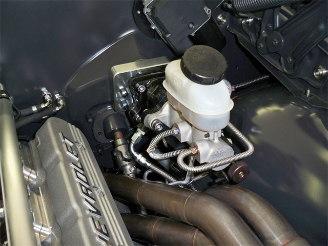

Then there is also Jody's previous TT build sporting the 17 degree upward system with the Viper MC:
http://www.hydratechbraking.com/images/hydroboost.jpg
http://www.hydratechbraking.com/images/hydroboost2.jpg
This is our 17 degree upward model that connects to the power brake hole in your brake pedal:

Hindsight being 20/20 I'm not sure exactly why I put the driver's side wastegate where I did several years ago. Back when I fabbed them I remember putting that was the best spot I could come up with at the time for the wastegate based on the bend radii of the mandrel bends available, clearances to the inner fender/hood/steering/spark plugs/master cylinder, and also where I could dump the waste back into the downpipe (I didn't want dump to atmosphere wastegates.)
Looking at the driver's side now I could have done things differently and left a lot more room for the master cylinder-- but redoing it now will be money that I'd rather put towards the floater rear end and new brakes rather than reworking things that I already did. It may have to happen in the end though.
