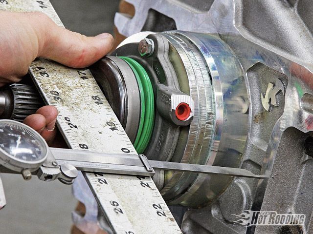

Rod P 11-04-2015 07:14 AM
the spacers stack behind the throwout....here is a pic there are a few companies that make them...I think all the conversion companies do
