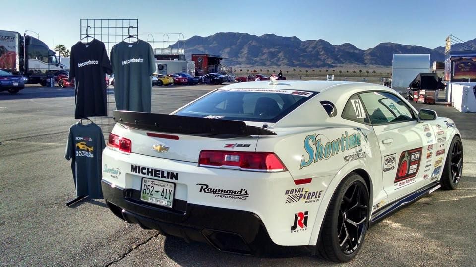

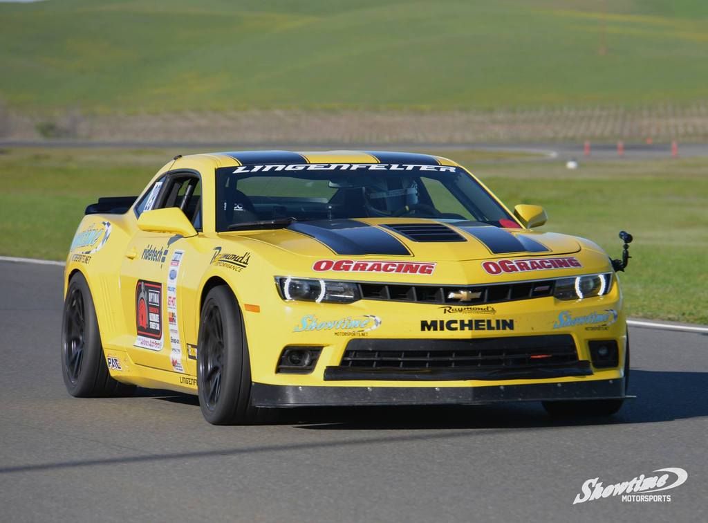

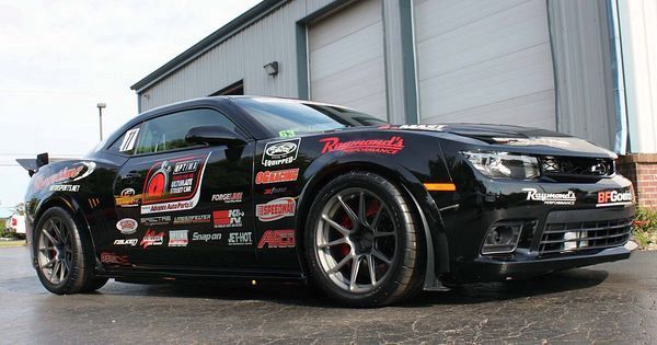

Rod P 01-05-2017 07:06 AM
the 5th gens are fun cars and even the z needs some help it was tamed down for street use, I was lucky enough to build and maintain several 5th gens, we raced then all over the US in the Optima series .....I think the basic DSE Speed ! kit would help you the most, it adds springs and better sway bars and you keep the z dampeners
here is the some of those cars
this one has the full DSE speed kit 3
http://i1195.photobucket.com/albums/...psao1zm4gj.jpg
this one we kept the stock z dampners and use the DSE speedd kit 1
http://i1195.photobucket.com/albums/...pskhkmpt15.jpg
this one we used Phadt and it sucked so it was changed to ridetech
http://i1195.photobucket.com/albums/...pszrkghcy1.jpg

Rod P 01-06-2017 10:01 AM
Originally Posted by ArisESQ (Post 651865)
Also, did you have an opportunity to drive the speed 1 and 3 equipped cars and a standard Z? Would be interested in hearing your impressions.
yes the white z we had was fully stock springs. dampeners and bars, we spent a test weekend at Thunderhill race track in California and JRI/Ultimate performance and Ridetech/Fox both had engineers and tuners there and we equipped the white tester from stock to ridetech and gained a second+ in lap times from stock and white/ridetech vs Black/JRI car was only a 100ths of a sec between them, later we went back to factory dampeners on the white car and the speed 1 kit, and won the GT class at Optima that year in the white car(we damaged the engine in the black car and was unable to repair it before the finals and that's the reason we ran the white car)
