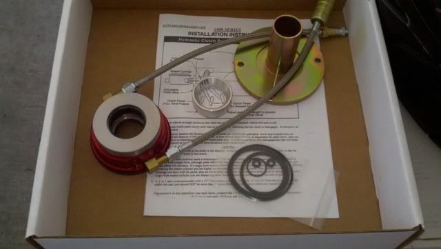

A few months ago I picked up Mcleod PN 14-302 for the T56 Magnum. I hope it works better than what you guys have experienced cause pulling the tranny multiple times is no fun!
Ron in SoCal
69 Camaro in progress
