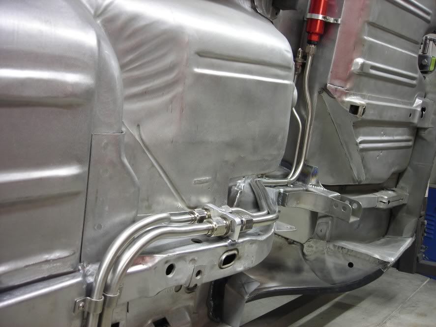

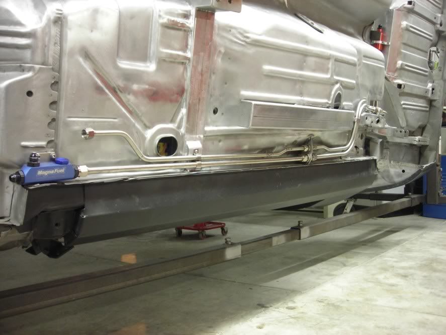

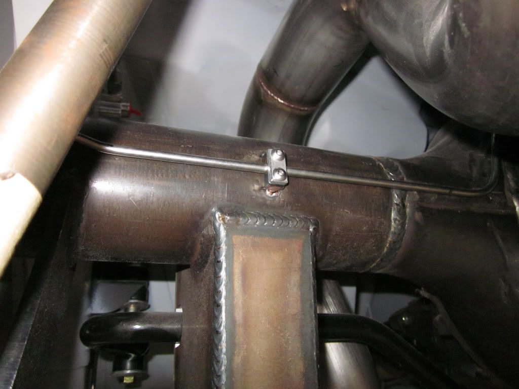

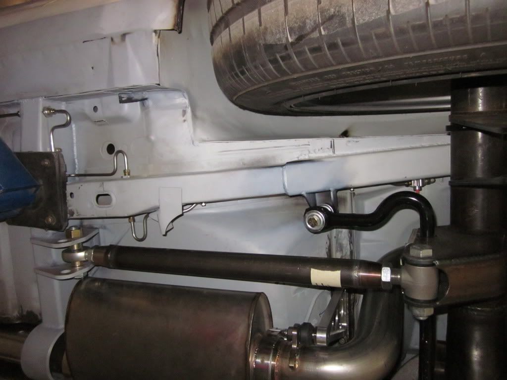

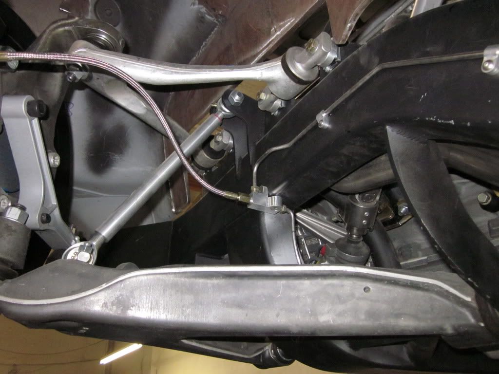

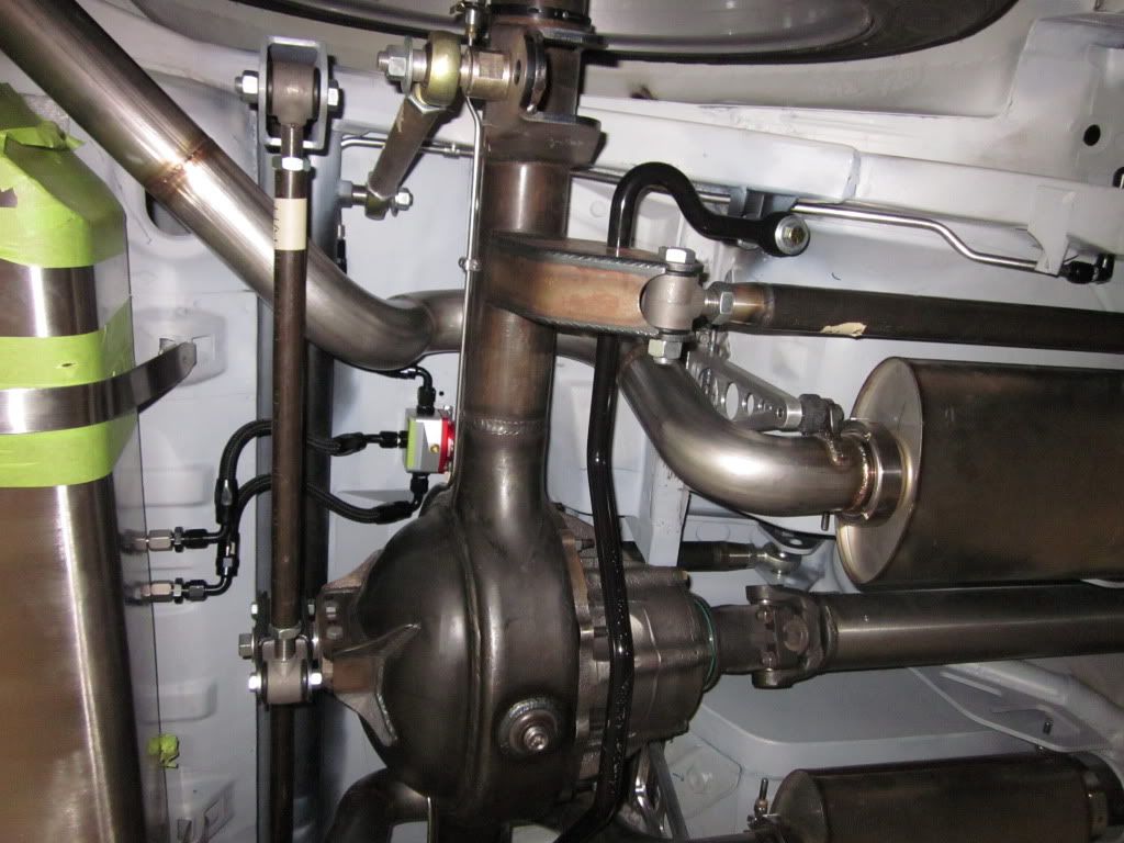

I've been thinking of this for a good while now and thought I would share some of my past and present plumbing projects and call it Tubular Tuesday's. Every Tuesday I or anyone else with plumbing pics,ideas or tech would be a pretty cool idea to help and share with the community.
Plumbing on any car is probably one of the most over looked and neglected aspects of a car. Trust me I've seen it all ! It blows my mind when I see $100,000.00 + cars with dangling brake and fuel lines zip tied and shoved into a crevice of the car or run under the carpet for that so called "clean look". Take a little pride and patience and do it write. After all it's your LIFE !
So let me start it off with a few pics and see how things go !

Where did you get the clamps that hold the brake lines onto that tube chassis with the cantilever coil overs? Those are slick!

We water jet our own. They just suck to sand and smooth.

Yeah they were slick. About 8 years ago I had a few made and they cost me my left leg. So if you see me limping you'll know why.
Problem with this style of clamp is you might need 3 or 4 different size radius's to run one line from front to back. So when one clamp is made you need to make the most common used sizes 1/4, 3/4, 1, 1-1/4, 1-1/2, 1-5/8, 1-3/4, & 2. There not easy and any machinist would want to have a min. of 250 to 500 to make it worth while for both parties.
Let's just say at that quanity they would be $3.50 ea. That's 2000 to 4000 peaces X $3.50 = $7000.00 to $17,500 for ONE FREAK-EN SIZE
Now you know why I haven't made them !
