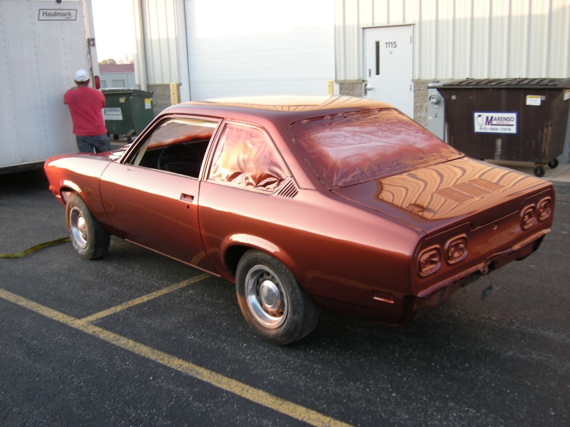

Kind of a lower buck customer project.

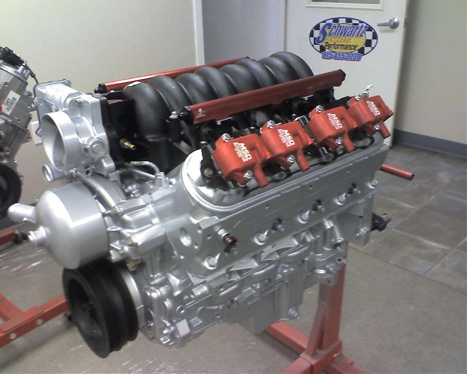

It's getting an LS engine and a lot of suspension work.
We got a complete 38,000 mile aluminum 5.3 from a Buick Ranier for $700.
The rear end is a 3.42 posi 8.5 inch 10 bolt from an S10 2wd 5 spd 4.3 which is the same width as the original Vega unit and it has disc brakes.
We're calling it the "Flying Turd"
