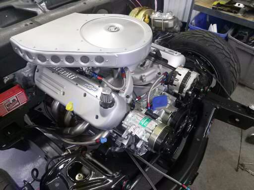

New motor installed

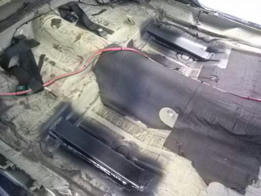

Subframe connectors from DSE. I thought this was a fun and easy project.
