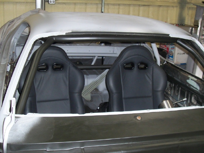

https://lateral-g.net/forums/show...ght=gutterless
Here check this out.
