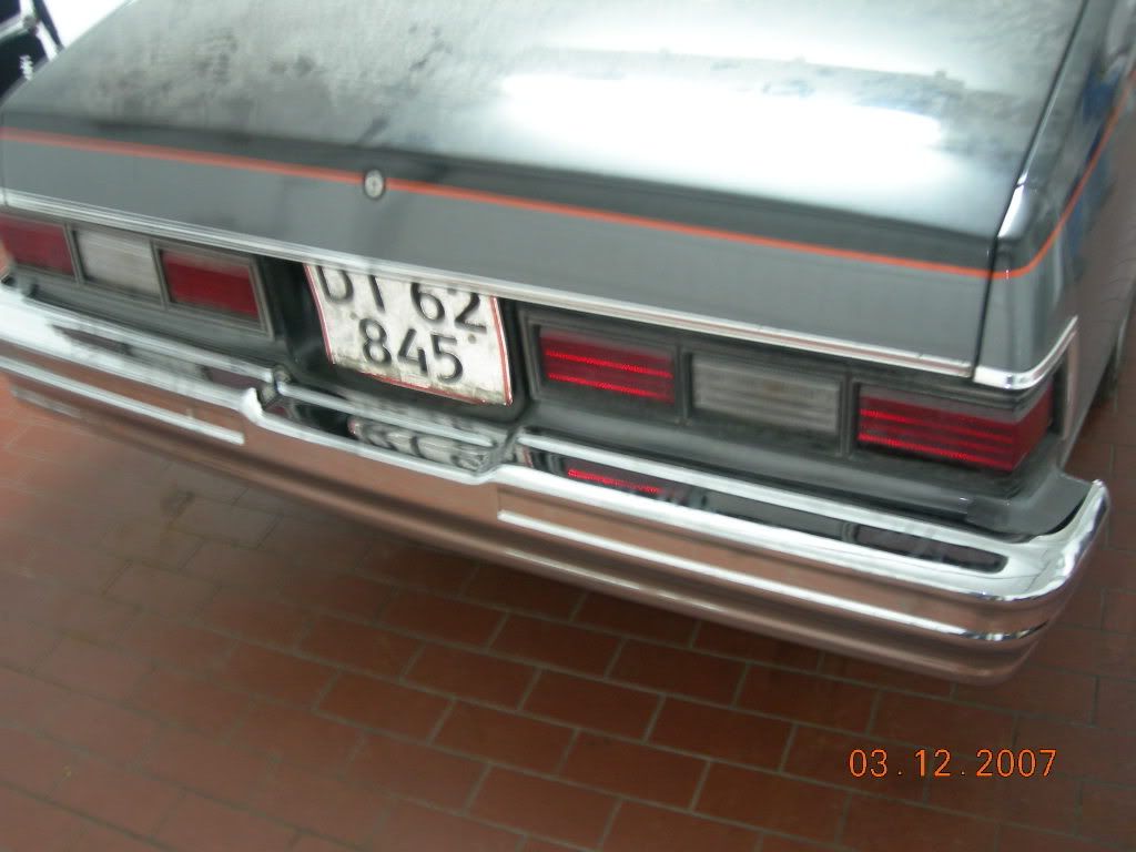

Ok ive not posted updates for ever it seems, simply for lack of progress... ill just recapitulate what ive done, post a before picture and some during... finishing with the recent ones of the leather being fitted...

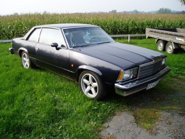

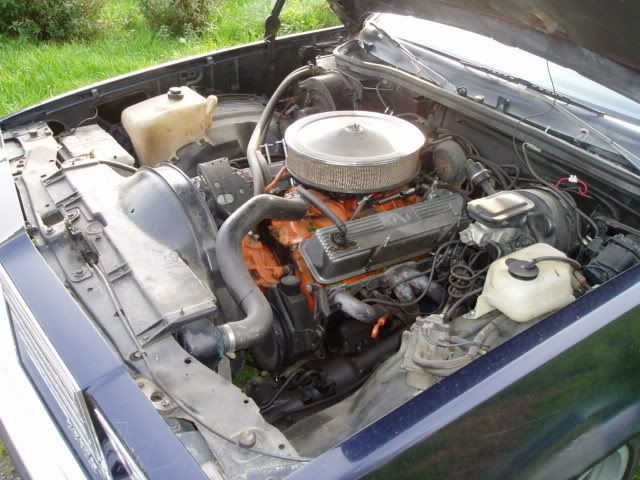

the car was a prety sad 79 malibu, 305, 350 tranny... the previous owner had a halfhearted attempt at pro touring by adding 17 inch bmw rims (very cheap ones at that) and some koni shocks...
some of you might remember my first post "help malibu handles like a canoe"... somone here pointed in the direction of ATS and SC&C and with their help it has progressed a far ways from what it was...
first a pair of before pics:
Jake: Hit it.

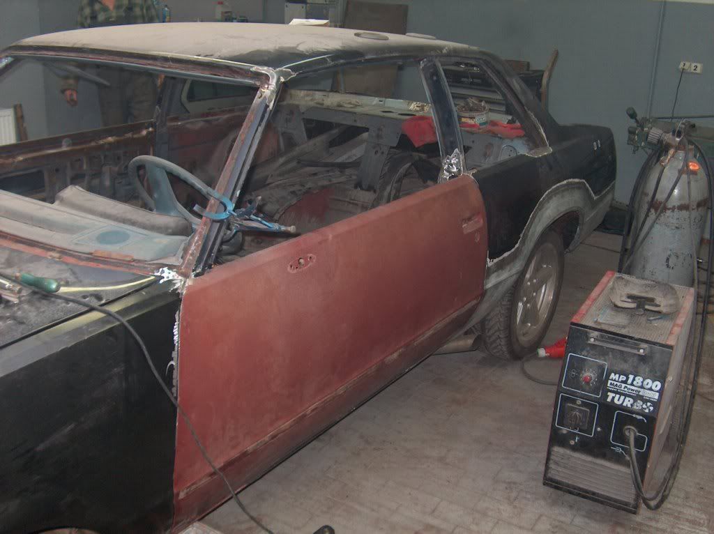

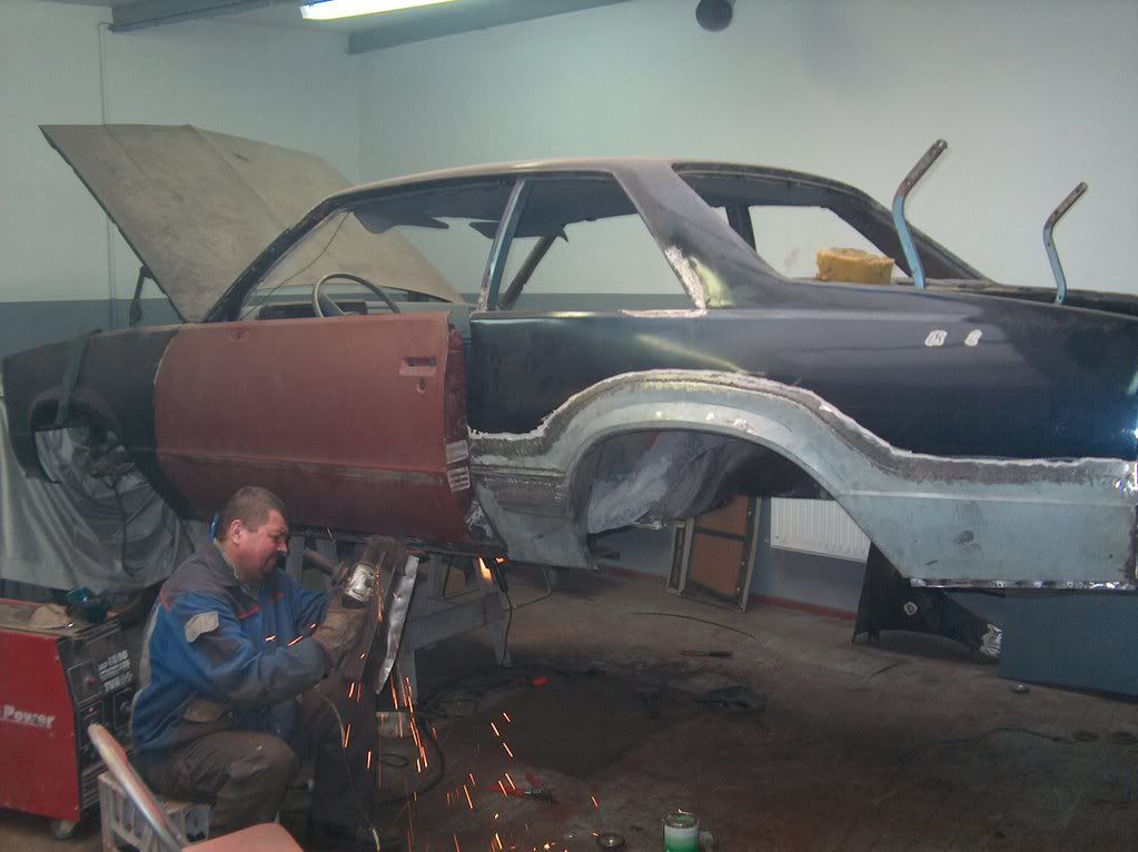

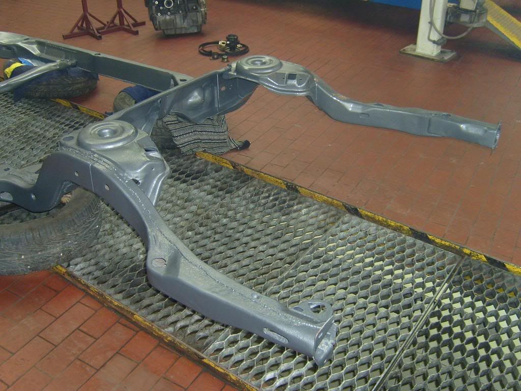

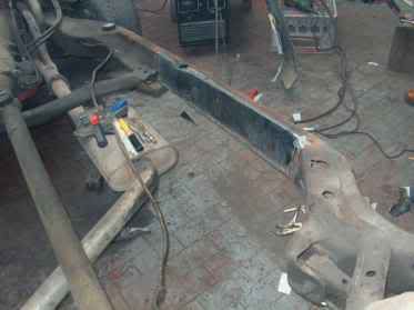

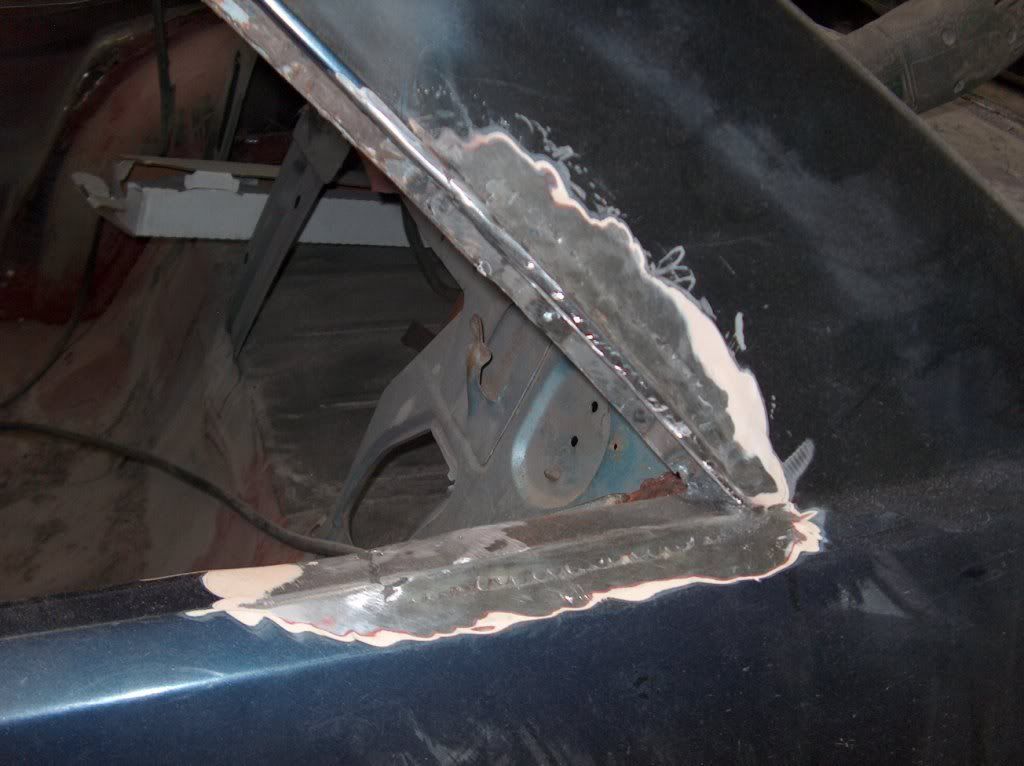

next came the work... a frame off deal, where i after conferring with marcus decided to box the frame and make aluminum bodymounts.. here are some pics of the frame and bodywork:
Jake: Hit it.

next was ofcourse the body...
Jake: Hit it.

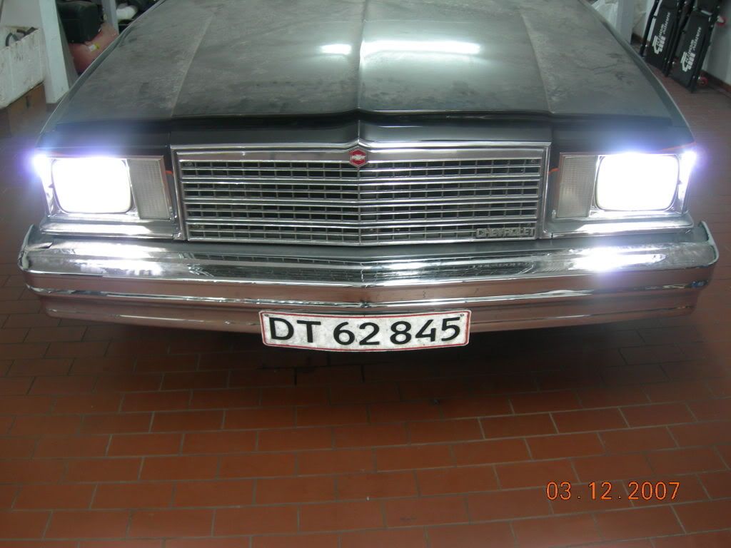

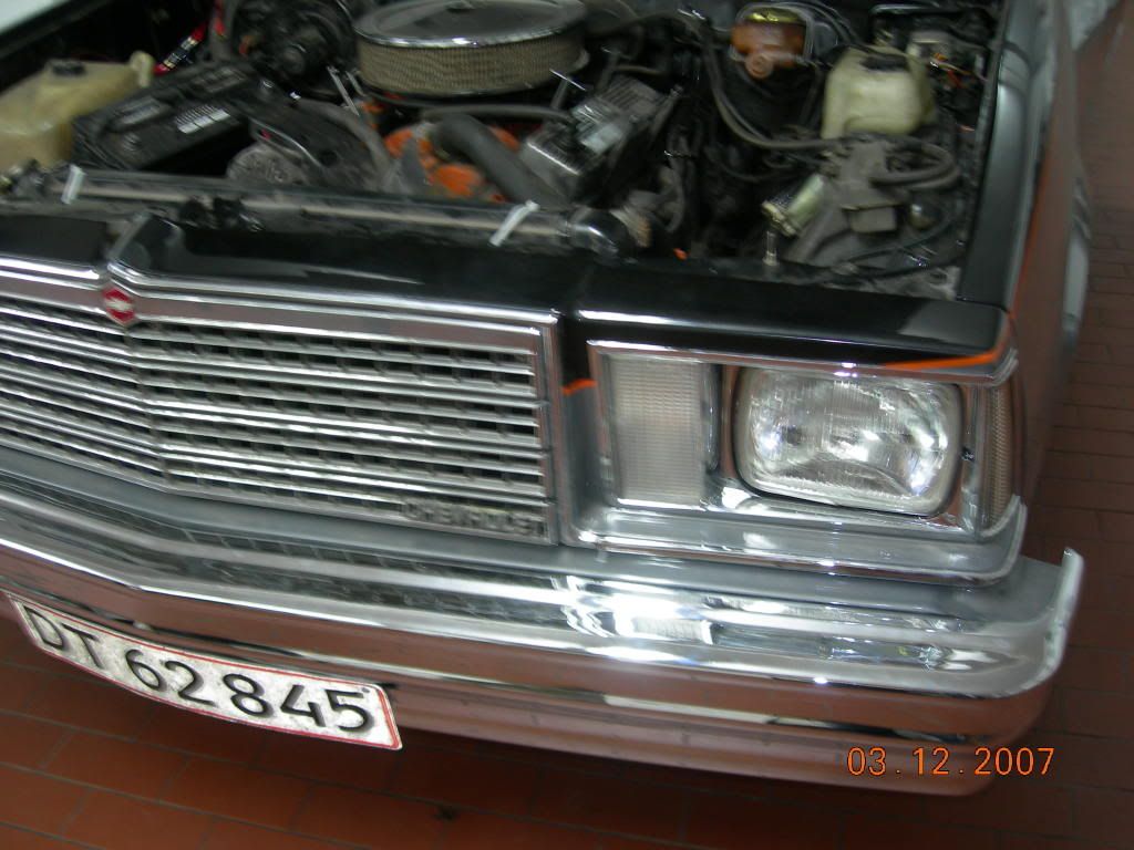

some callong arround procured a nice set of bumpersm new header-panel trim and aome dual HID headlights.. (nothing wromg with alittle bling right?)
the bumpers were simply to nice to cut... so ill have to find some crap ones to cut and tuck some day... but for now its stock
Jake: Hit it.

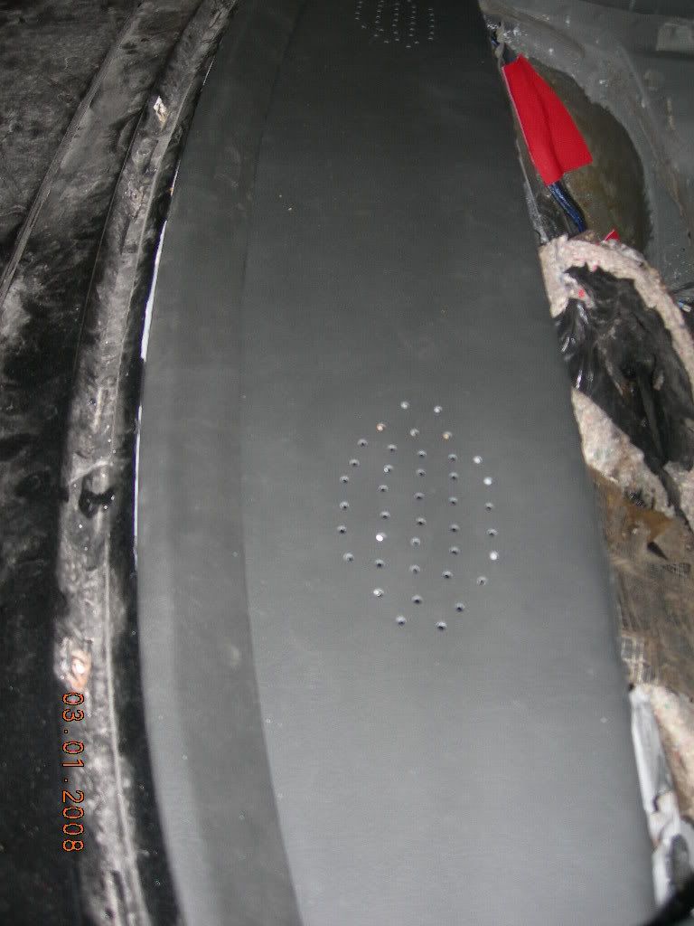

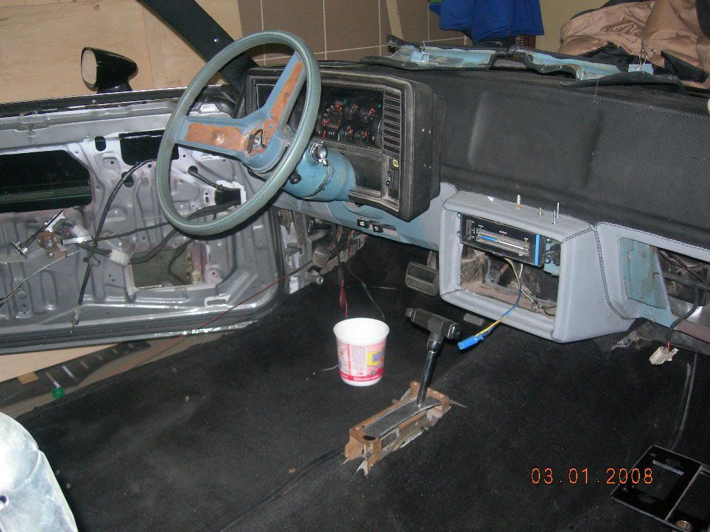

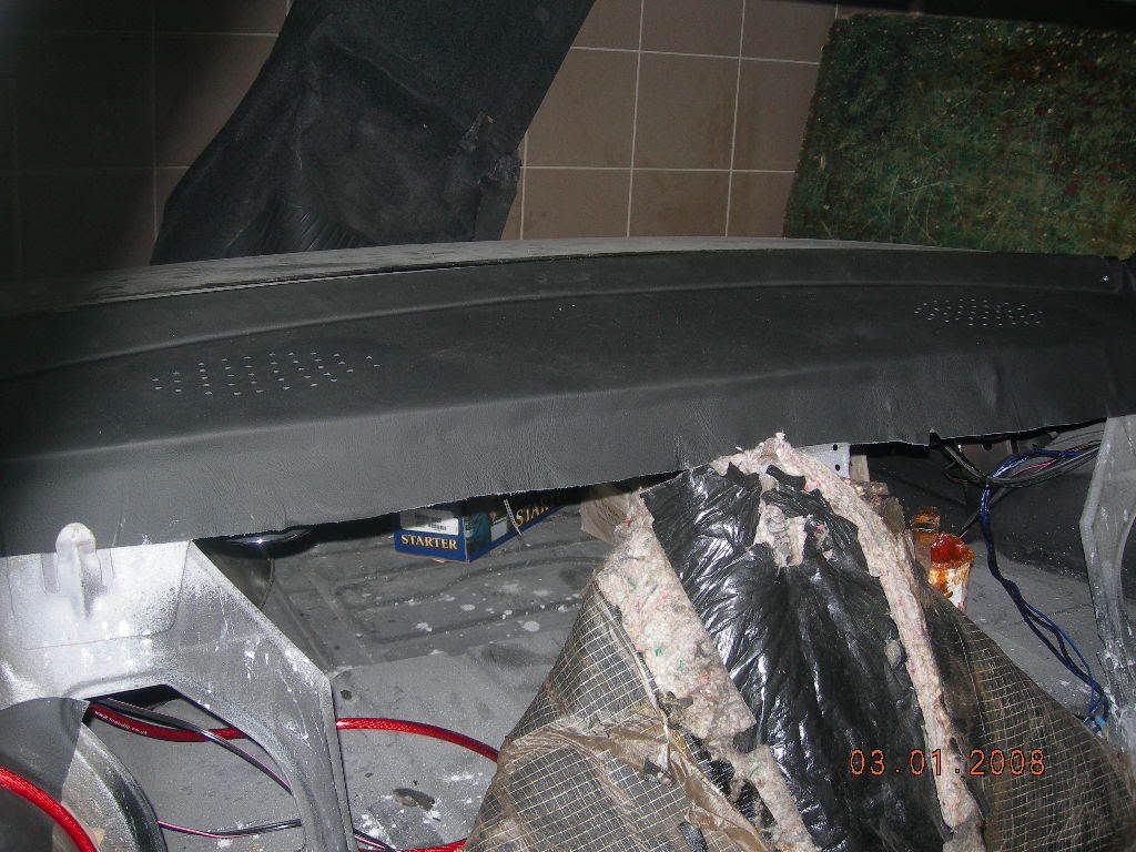

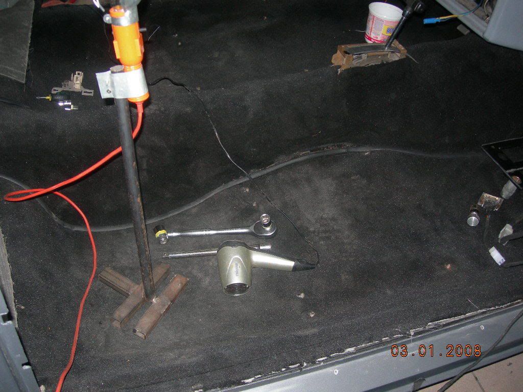

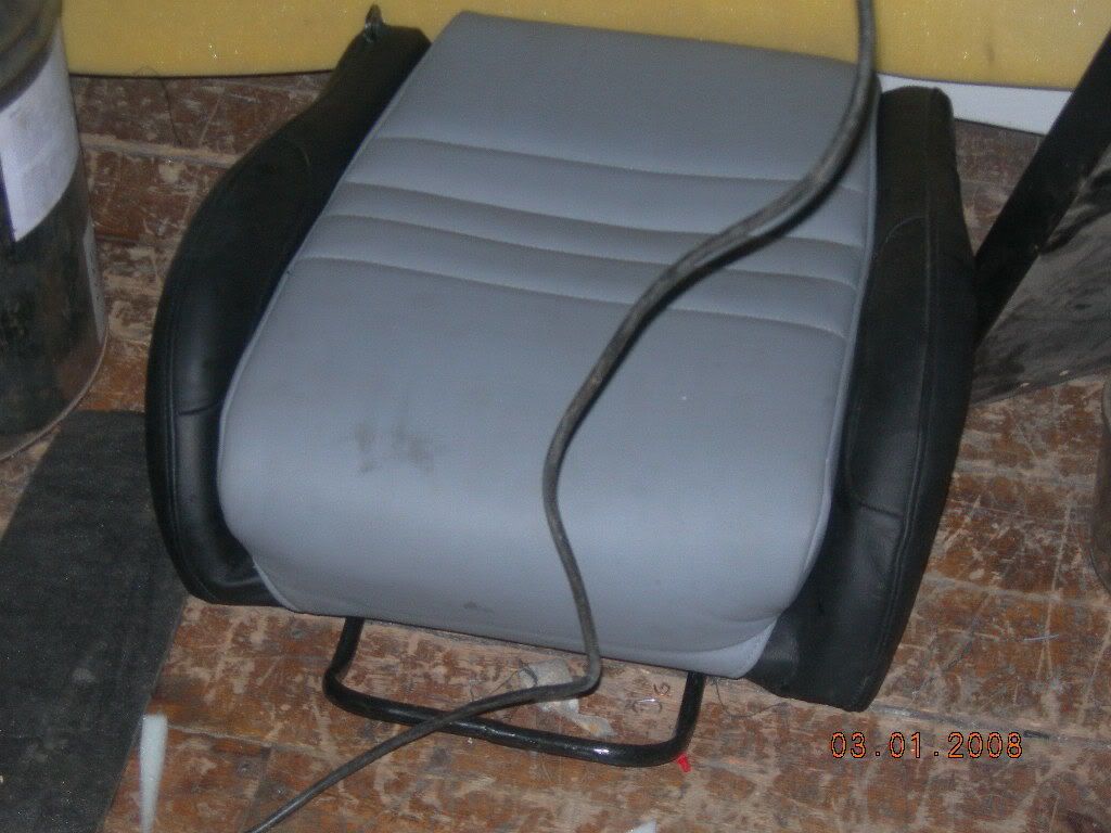

and the last of the update os that the stereo is in, the leather is getting finished up... in matching colors .. the recaros have even gotten a malibu like stitch in the seat to malke them fit in better...
yes thats leather on the dash and pillars :-)
Jake: Hit it.
