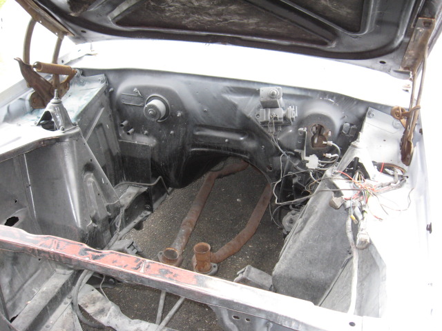

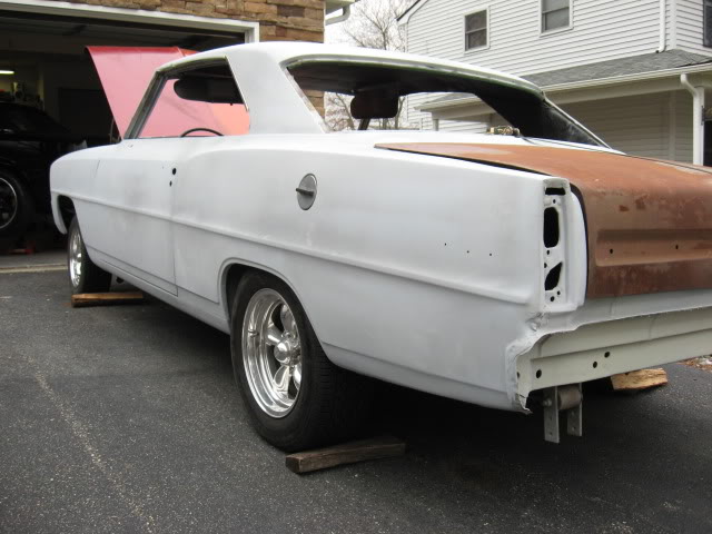

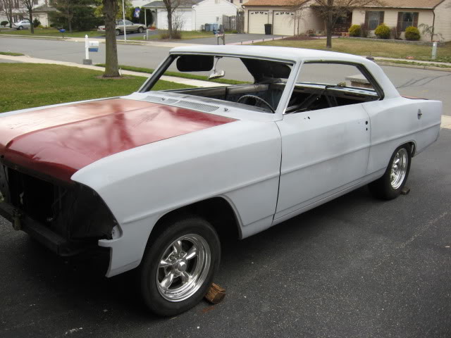

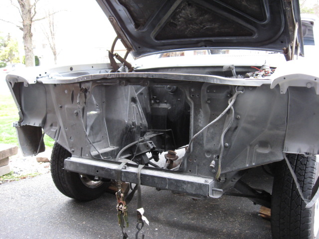

Here is what the car started out like:

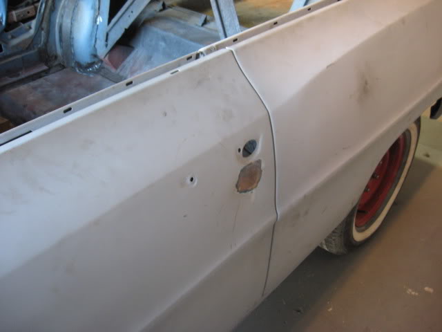

Minor body Shaving:
HRBS on Facebook

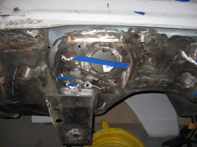

Posts: 1,190

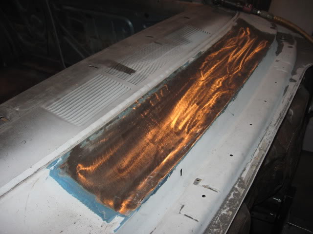

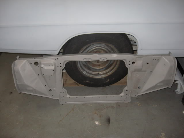

Filling the cowl vent and smoothing the radiator support:
HRBS on Facebook

Posts: 1,190

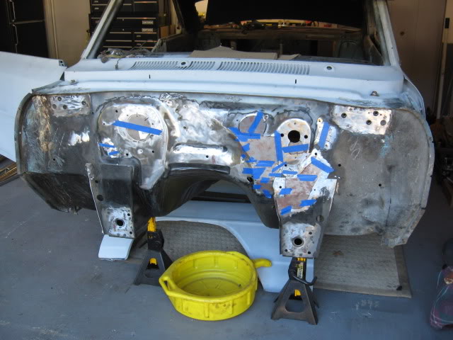

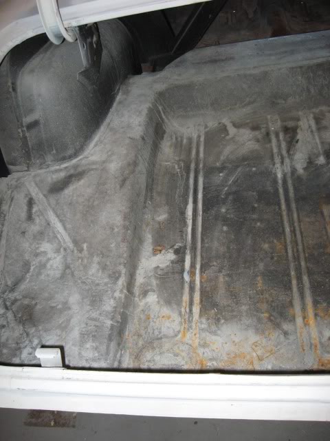

Shaving and smoothing the firewall:
HRBS on Facebook

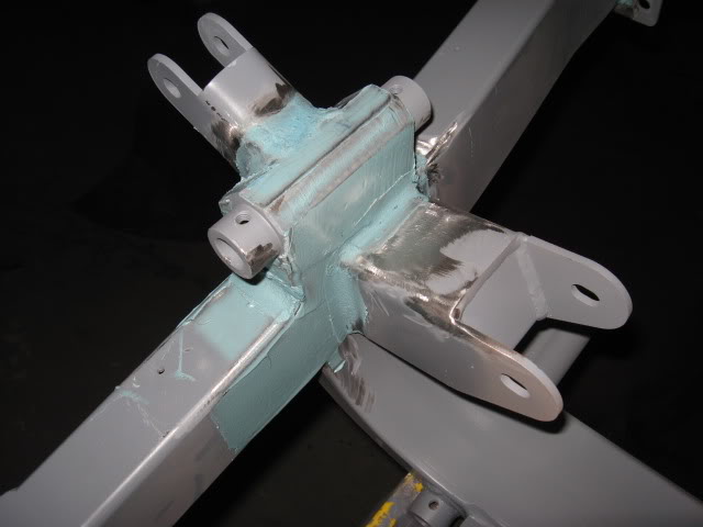

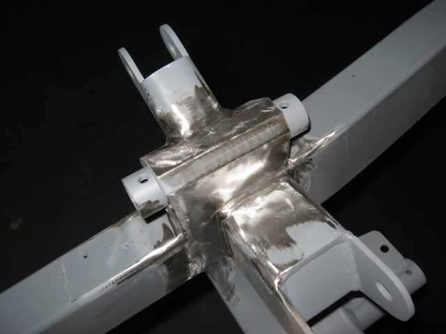

Posts: 1,190

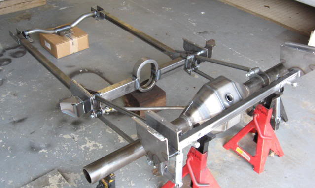

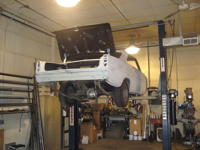

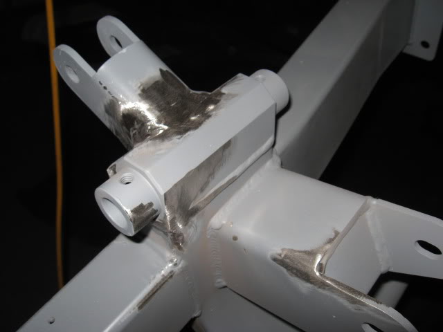

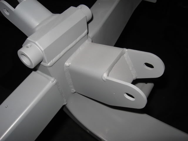

Chris Alston Chassisworks Front clip and TCI 4 Link Assembly.
Shaved and ground welds smooth.
HRBS on Facebook

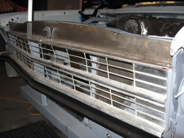

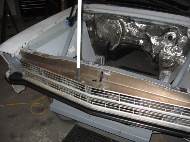

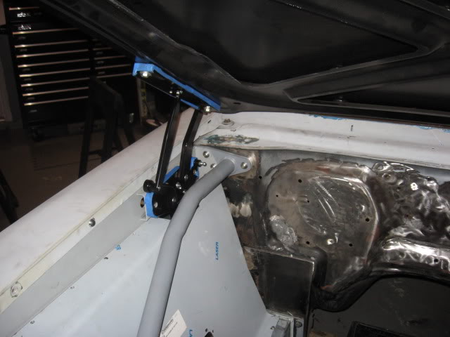

Ring Brother Hinges (slightly modified to fit CA clip).
Fabricated Front Radiator Support Valance:

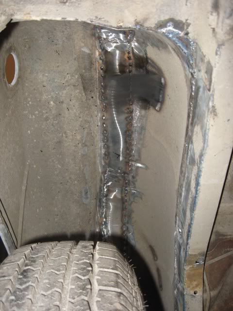

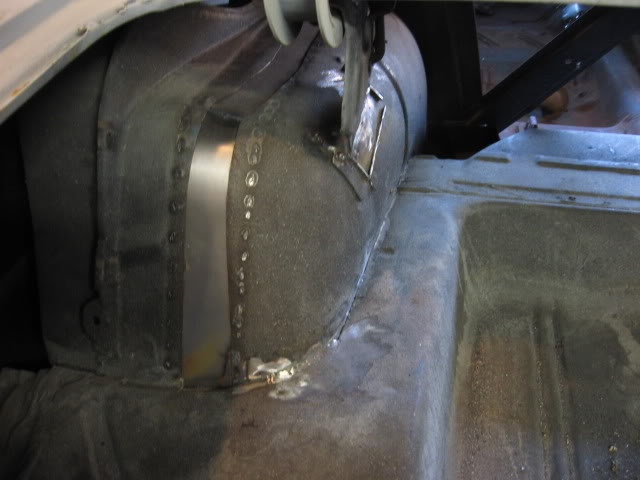

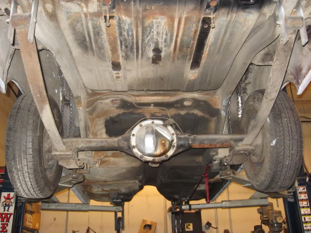

Mini Tub.
Sliced Inner well and moved inward to fit flush with stock frame rail.
Picked up 2-1/2":

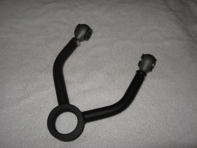

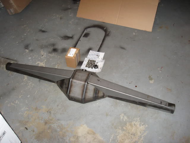

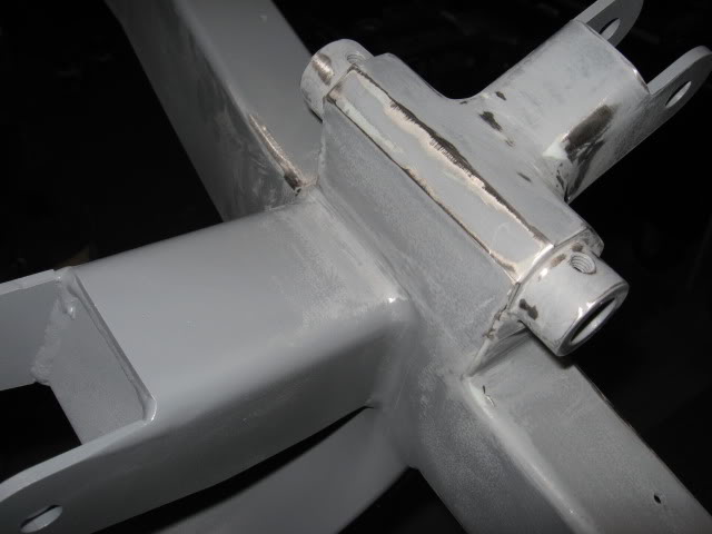

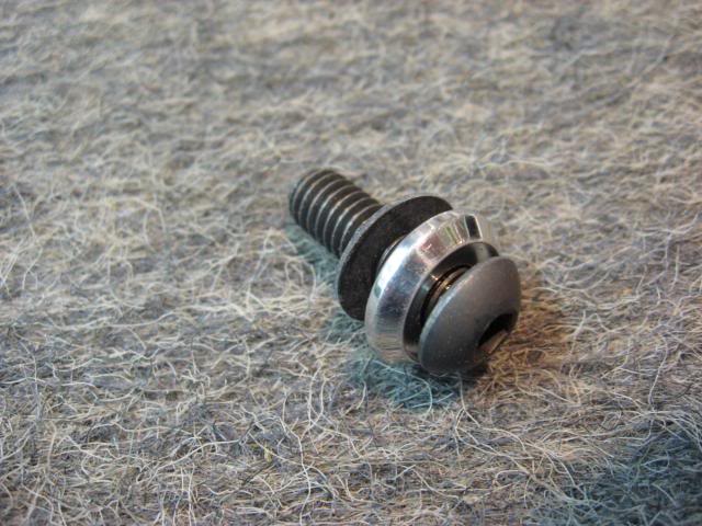

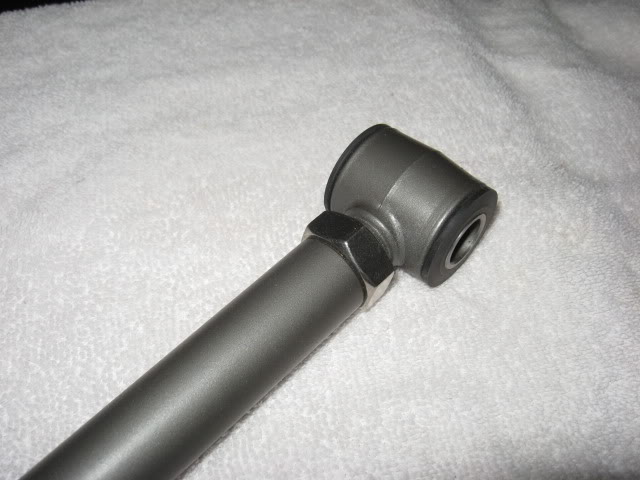

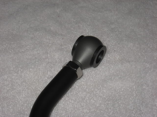

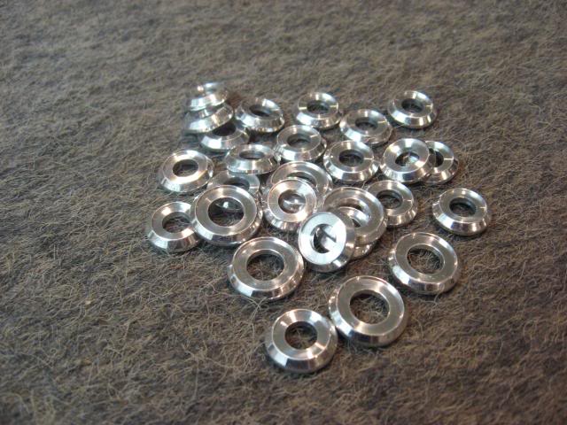

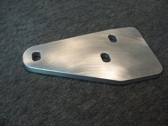

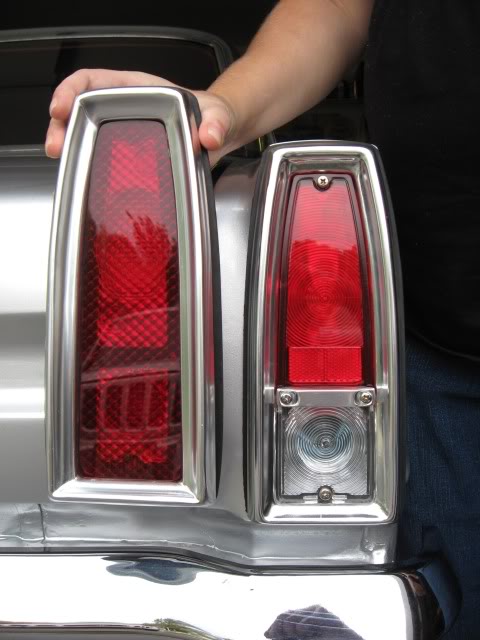

A few CNC'd parts and detailed photos of components:
The CA clip usually reuses the stock body shims. We CNC'd our own "one-piece" version. We also created a "thinner" more low profile decorative bolt washer that we will soon produce for the public. Notice the rubber backer washer for a non-paint chipping installation. We also made up a set of CNC'd Billet Tail lights with one-piece lenses.
The suspension parts shown have all been media blasted and powdercoated in a Matte Black and / or Charcoal finish and all the factory Zinc "plated" mild steel hardware has been replaced with Stainless Steel.
HRBS on Facebook

Those taillights look awesome. I'll have to remember those if/when I ever find a nice Chevy II project.
Keep the pics comin'
