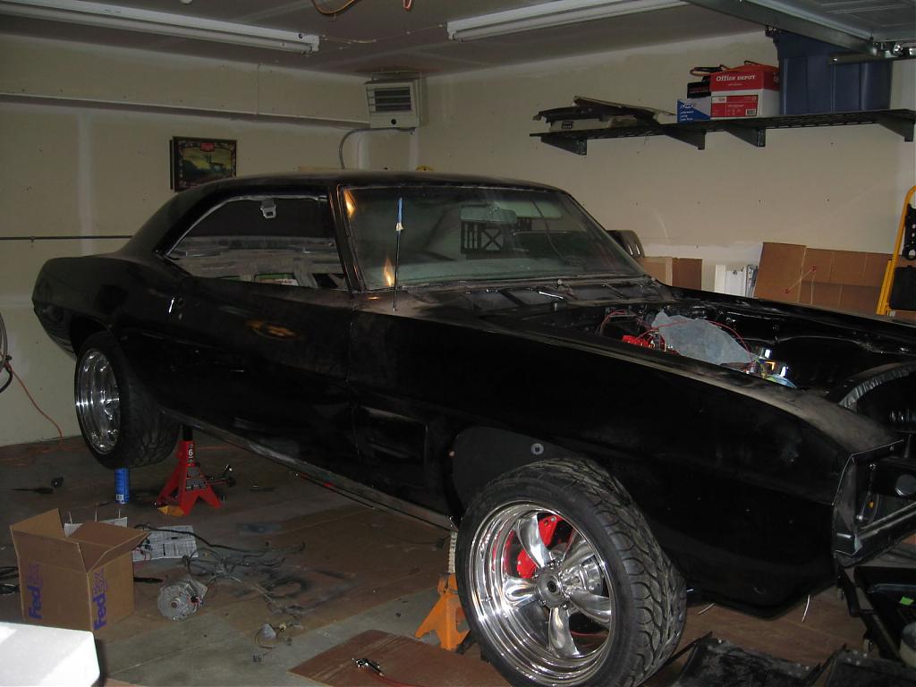

Here's a pic of mine currently, sorry, just got it out of the garage yesterday so don't have any off the stands ready yet.
1969 Firebird, Black w/Parchment Arizen interior, 383 Pontiac Stroker (350/428 crank), TKO600, Moser 12 bolt, 18" TTII's, Hotchkis, GW, DSE, Speed Tech, Vintage A/C, etc.
