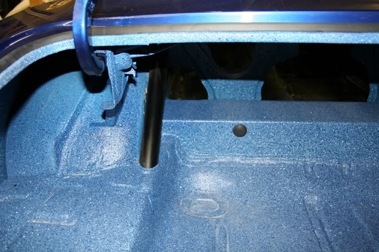

Ok here's what you do. Get the tintable Raptor Coating and do the splatter effect yourself using what ever colors you desire. This is what Chris did in my trunk...bad color choices? Yes....that's why I asked him to shoot it black. As you can see though you can simply splatter differant colors to get the factory feel...but be far more durable!
And what happened when recoating with something black?
Tony
'68 Camaro

anthony that is not a good example, i am sure you know that but raptor liner is much finer finish and not nearly so lumpy, he applied it with the wrong gun or something, here is how it should look
Jake's Rod Shop

I never said he did it right!
The blue looked totally differant than the black...the black well...yeah!
