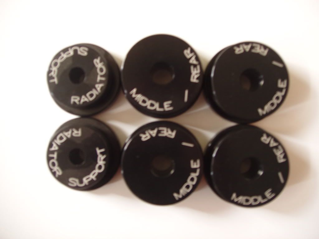

Here are some more parts that we machine! I have been making these sub-frame bushings for couple of years now.. I dimensioned them off factory NOS rubber bushings & this is what drove me to make my own.. The middle & rear bushing measure different thickness with a difference on the radiator bushing.. These bushing are made of 6061-T6 aluminum, e-coated, & laser engraved..
