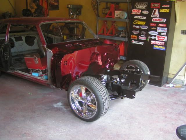

Hopefully on Monday I will get a chance to start wet sanding and then polishing the firewall. I'm probably going to get the Makita 7" variable speed buffer. I have wet/dry paper starting with 800 grit going up to 2500 grit. Does anyone have any advice/tips for doing this. I've never done either before so any advice would be greatly appreciated. Thanks in advance.
Here's a pic of the firewall I'll be doing.

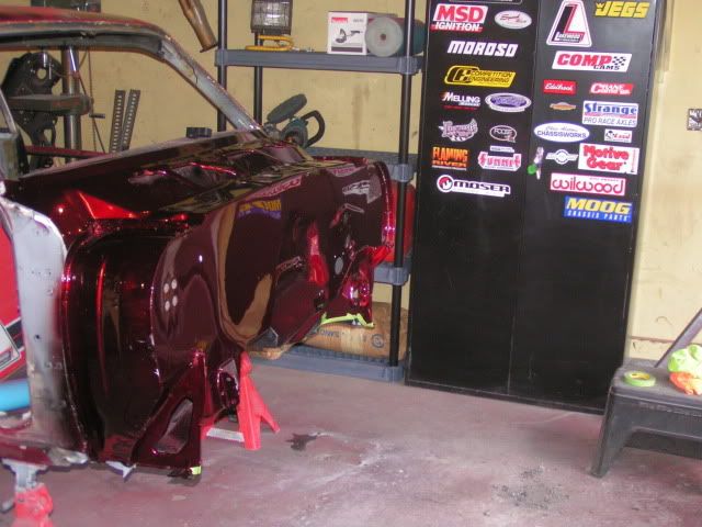

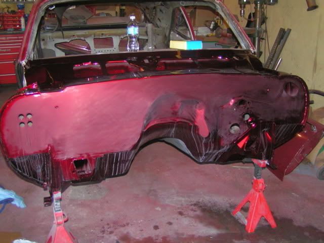

Thanks for all the advice guys. I ended up using 3m perfect-it pads and 3m compound and polish. It's neat how when you're wet sanding you can actually watch the orange peel in the clear disappear. I think it turned out pretty good. Here's some pics:
After wet sanding to 2500
After buffing with 3M compound
After final polishing with 3M swirl remover/polish
