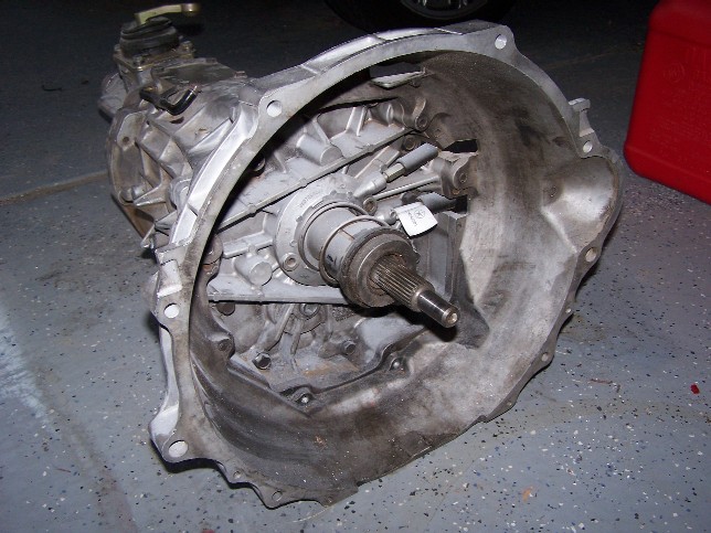

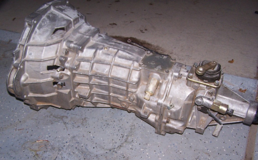

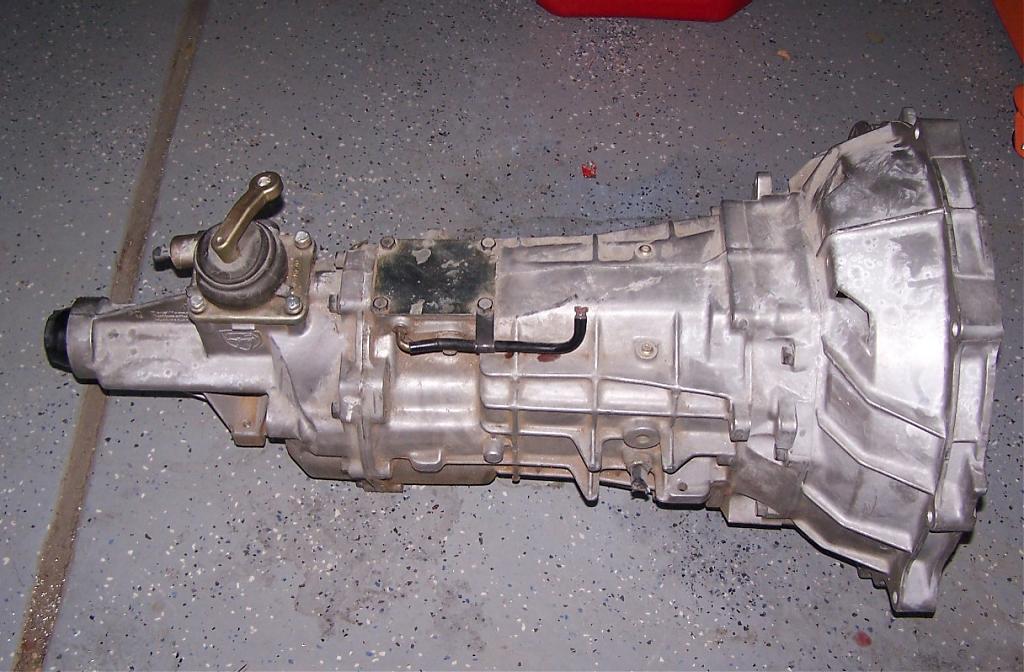

Thanks for all the info. My car is in the restructuring phase, so shifter relocation is not an issue. I picked up the trans. today (got it for much less than the asking price ). It came with the bellhousing and clutch slave (I think) - It's mounted with two bolts to the front of the trans, over the input shaft. Also came with the shifter stuff up top. I'd like to figure out what year it came out of but have not been able to decode the numbers yet. Here are some pics....

That clutch slave is the one that needs to be changed out for the GM piece.
You need to make sure whatever you do with the input shaft, make sure the bellhousing is setup to match.

Thanks; Based on the information I have found so far, I believe that McCleod may have a bellhousing and spacer setup which would allow me to bolt this to my motor and retain the existing input shaft. I just need to confirm.
