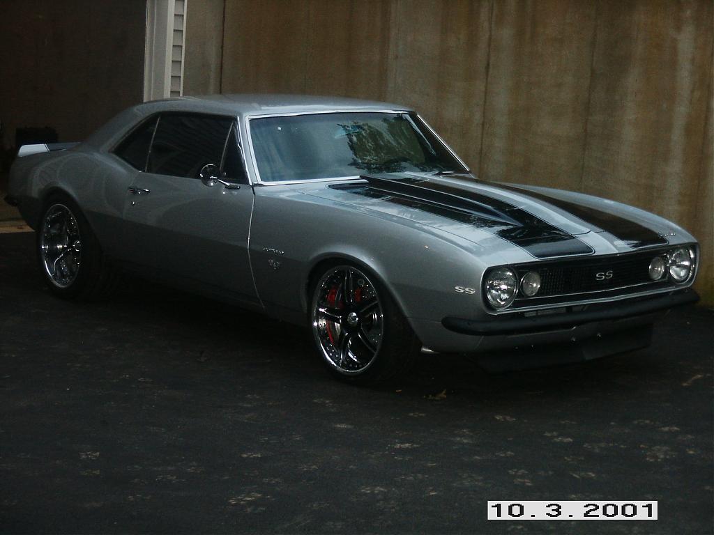

Old 12-05-2009, 11:02 PM
goob8869 goob8869 is offline
Posts: 91
I have 19x10 and 19x8 on mine and is not minitub
How did you fit those 10" wheels on the back without minitubs?
