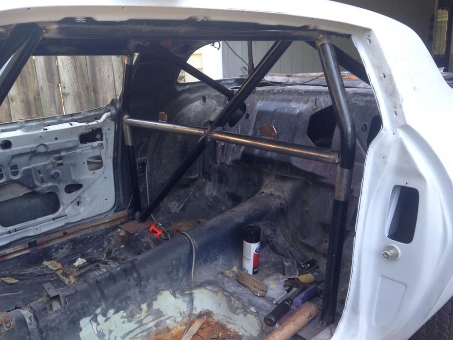

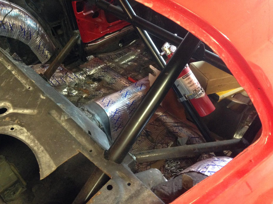

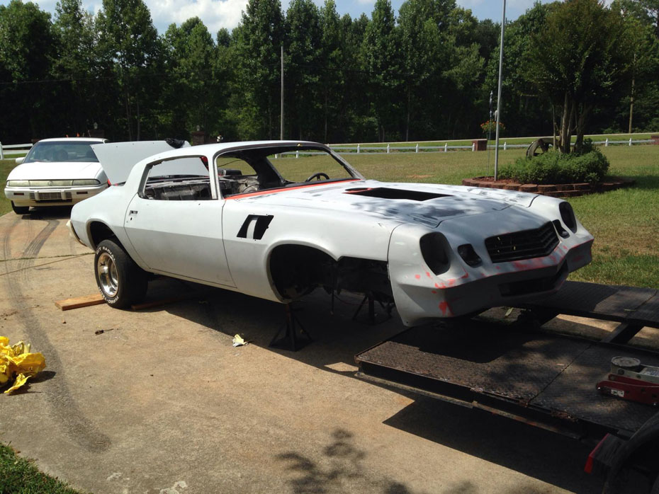

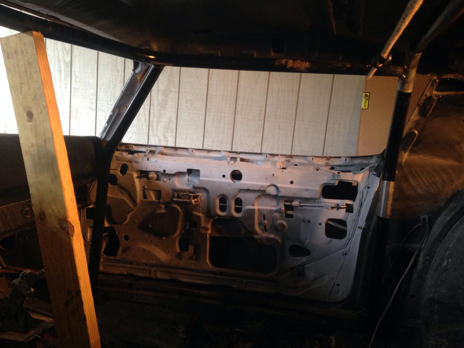

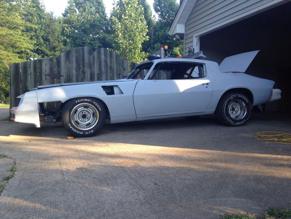

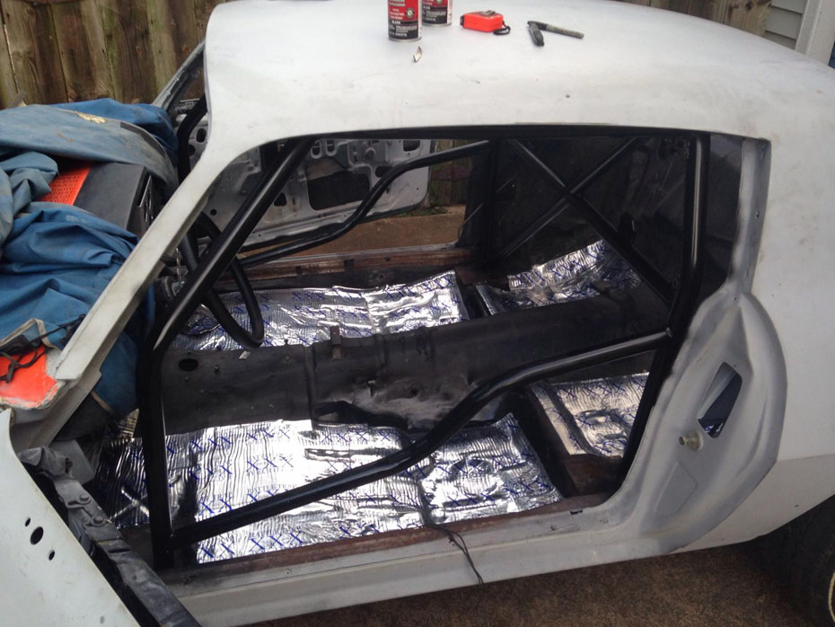

The car is a 79 z28 I bought a few months back. It was just a shell with no suspension or anything. But, the car had been sand blasted on a rotisserie and almost all the body work was done. So after getting it rolling, (about three hours after I got it home) I started on my cage.

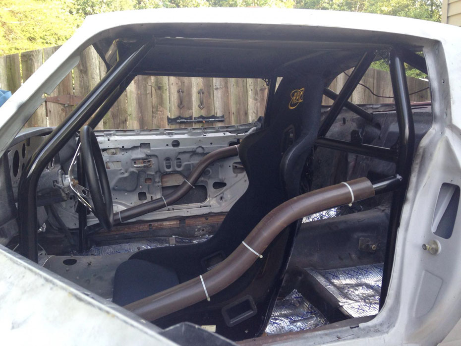

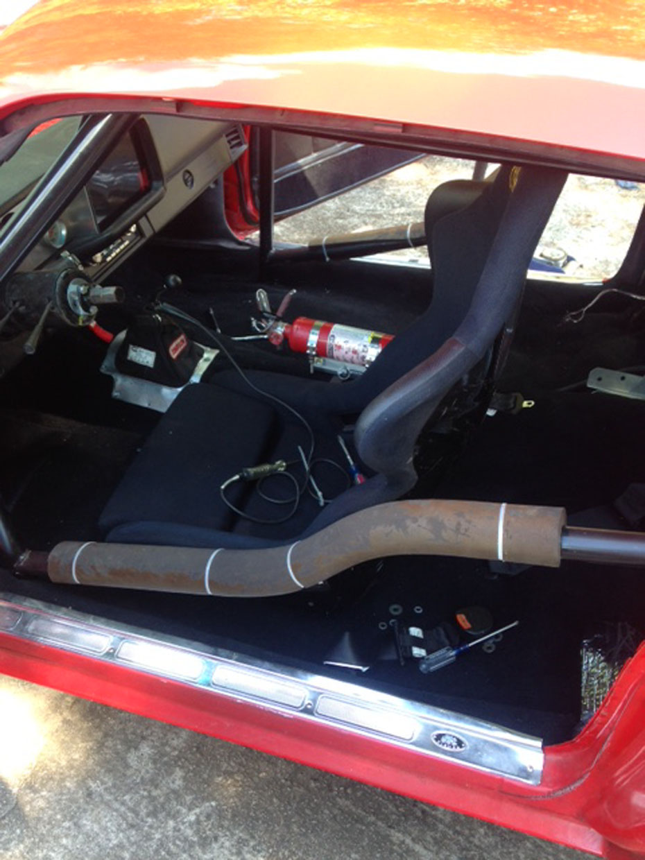

I found the seat on Craig's list for 60$ and the fire extinguisher and quick release mount for 10$! I was pumped about that!

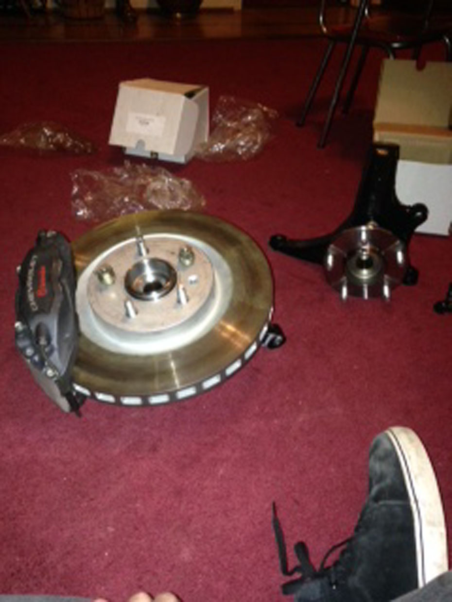

Now on to front brakes.

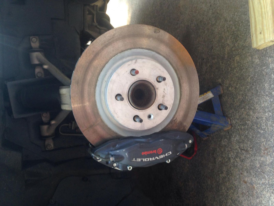

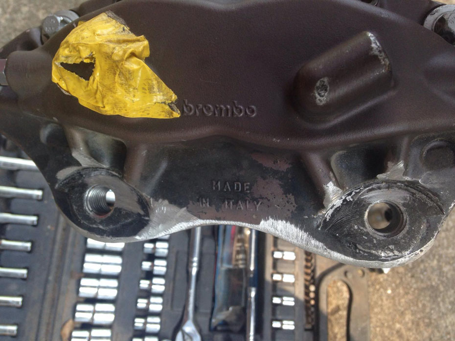

I bought a set of 5th gen Camaro Brembo's and rotors off a c6 race car at work. The calipers were welded up then drilled in tapped for a c5/c6 spindle (they were originally for my c5).

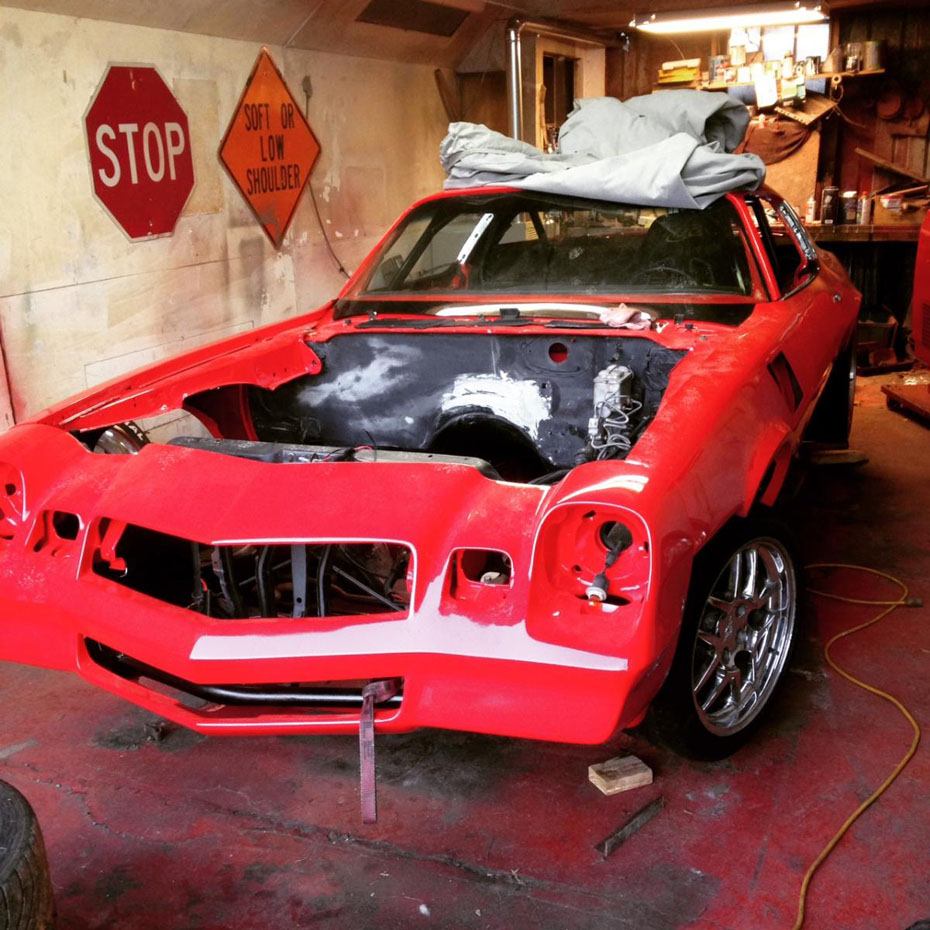

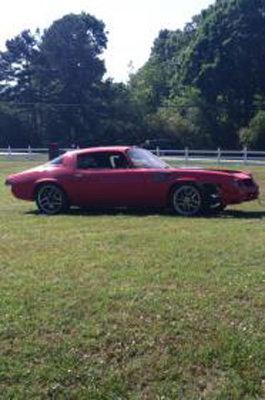

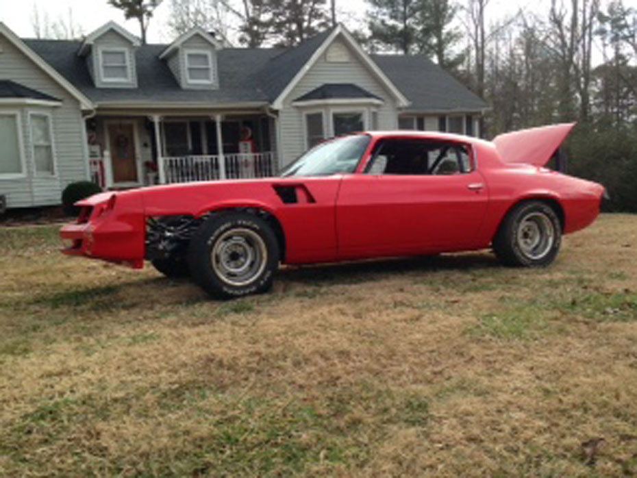

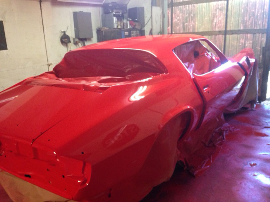

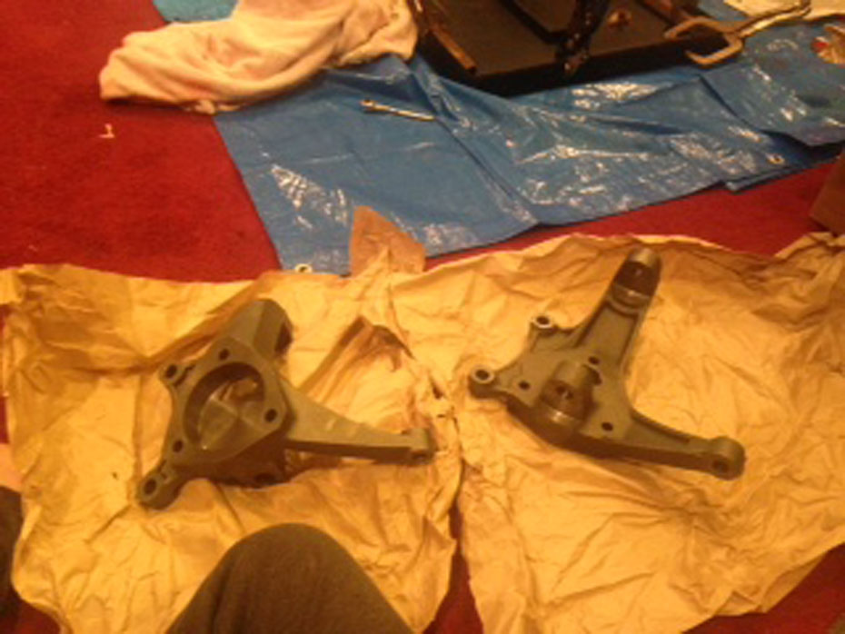

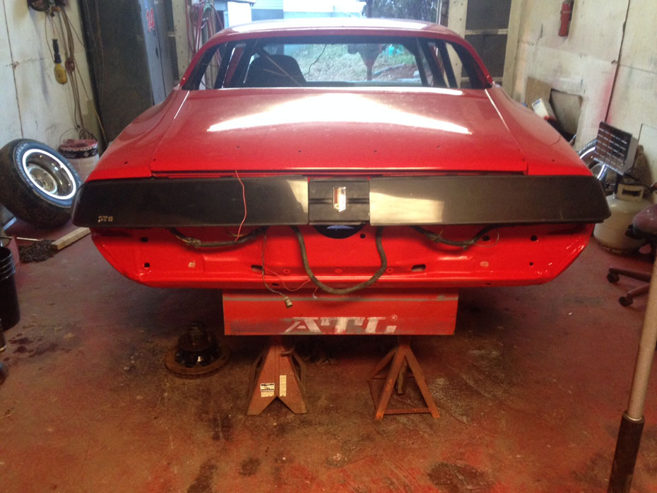

She's finally painted. And very, very red. Paint turned out good. I have my front wheels on and just got my CPP c5 spindles, hubs, and and brakes ready to go on.

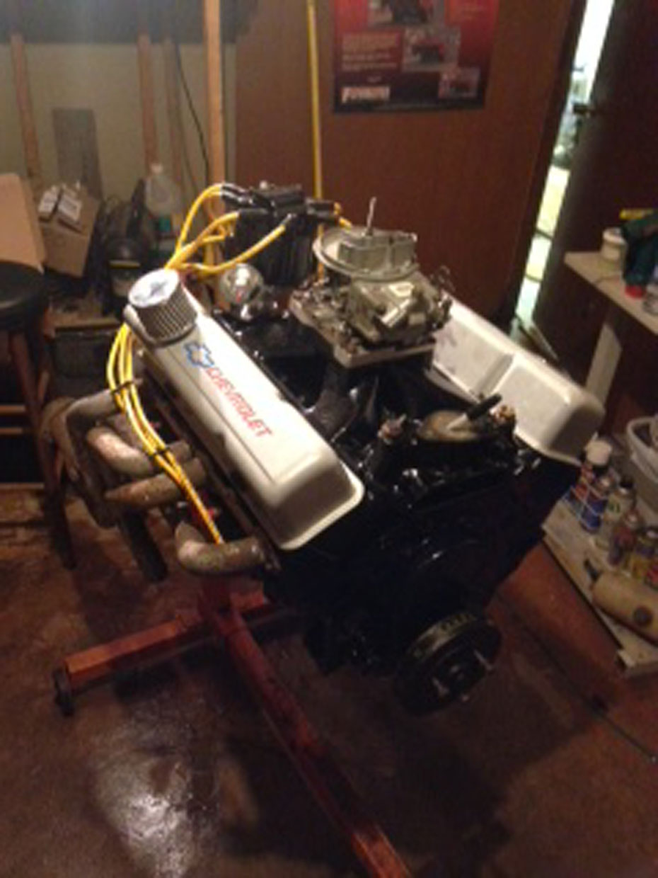

I just built the engine. 350, .040 over, custom grind cam, milled 041 heads, stock bottom end, victor jr intake. Mostly some of my old circle track parts.
My super T10 is being built currently so once its back it will be hooked to the engine and dropped in the car.
College just started back so progress will slow again.
BTW, the CPP spindles seem to be great quality. Really nice product for the money.

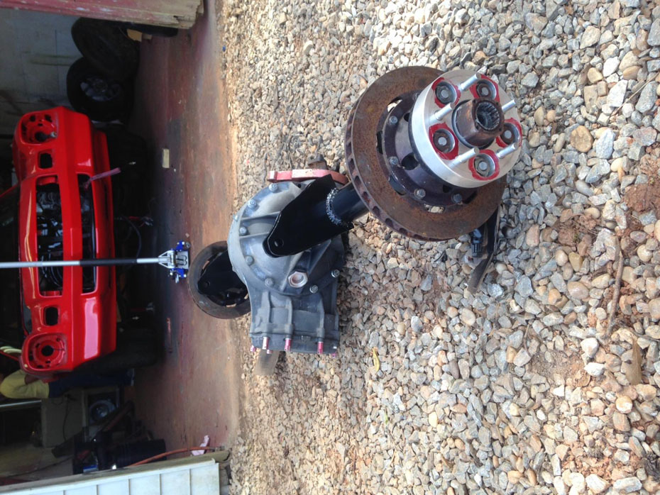

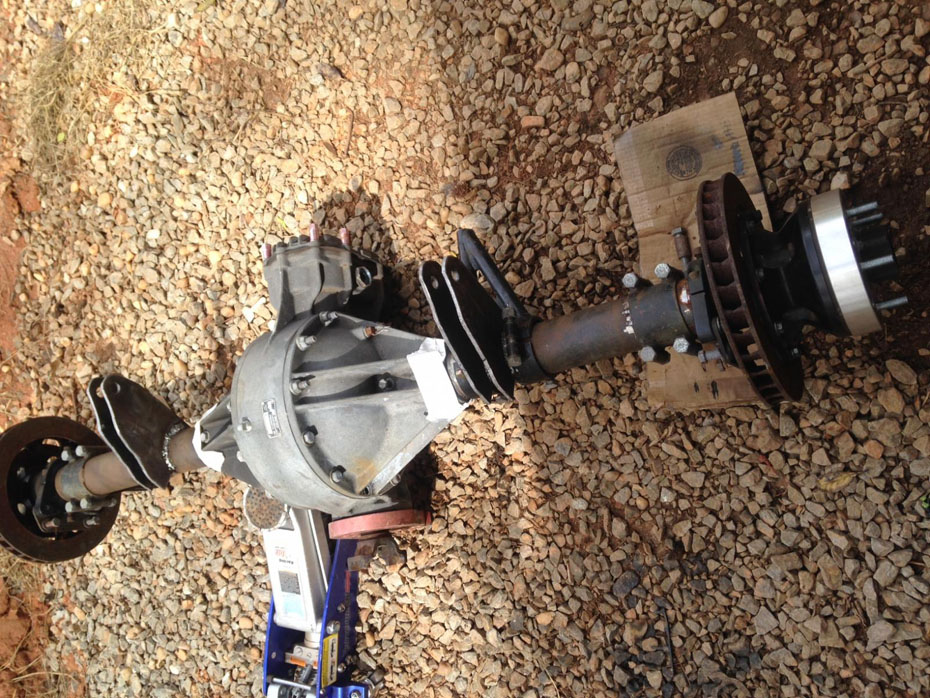

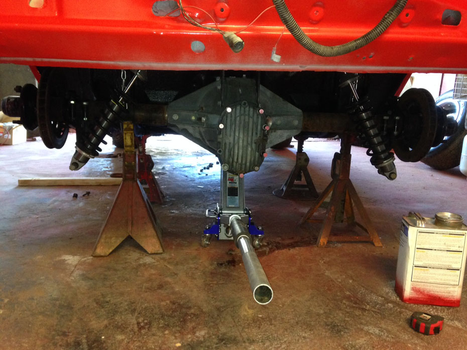

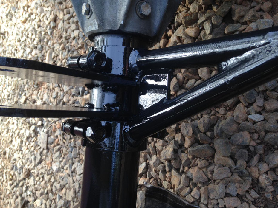

Got my quick change rearend mocked up. It will be a 4 link rear suspension.

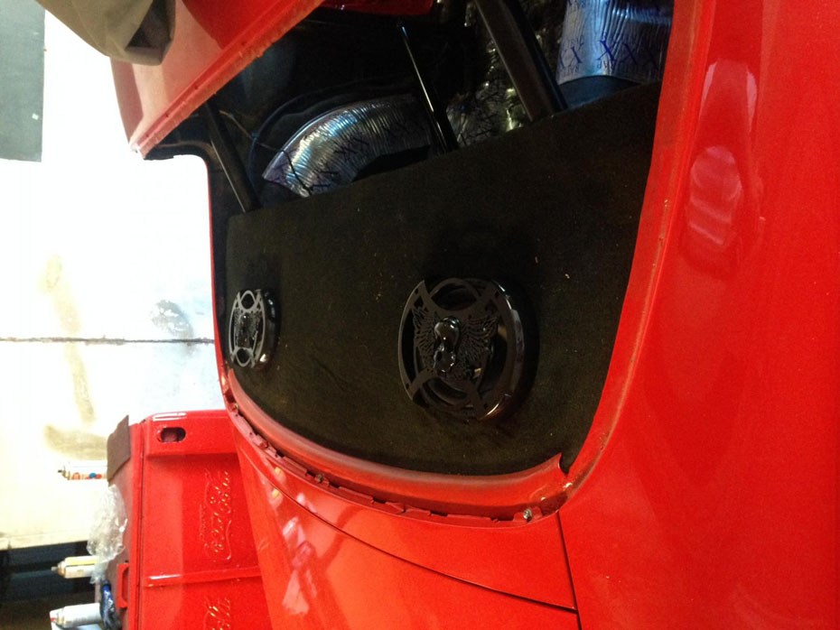

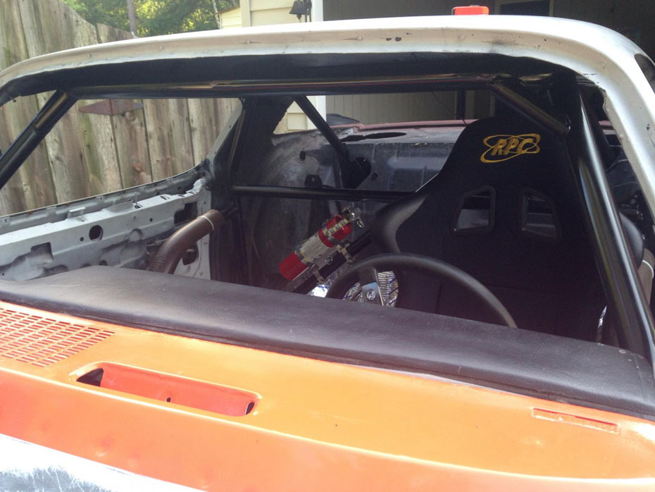

Finally got some more done. I made a rear package tray out of plywood then wrapped it with carpet. Turned out good.

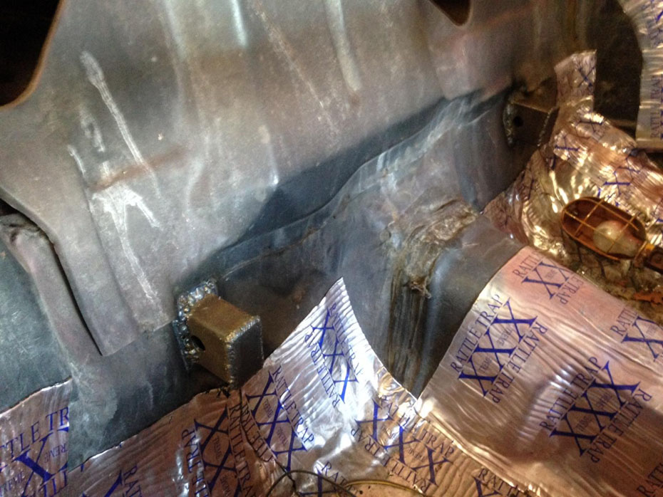

Made some brackets for the 4 link and quick change and made boxes where the 4 link will bolt to the car. Once upper links are here the 4 link will be finished thank god.

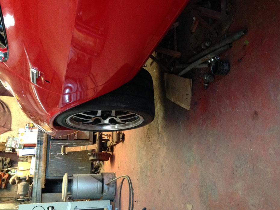

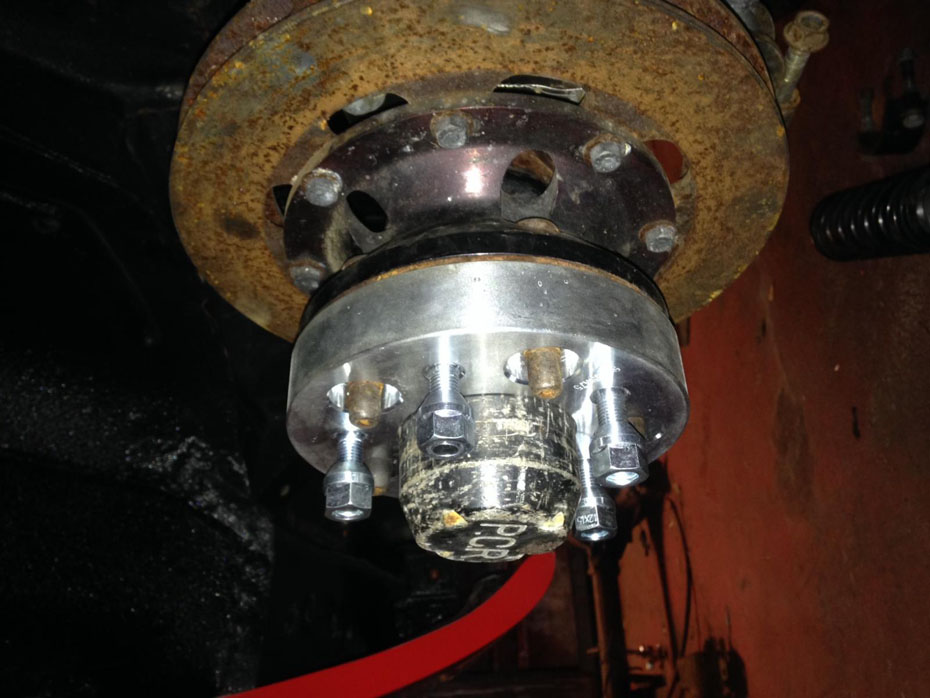

Got some wheel spacers but of course I had to make them work too. The 5/8 lug studs and 1 inch lug nuts on the rearend wouldn't fit in the spacers so I threw them in the mill at school and fixed that.

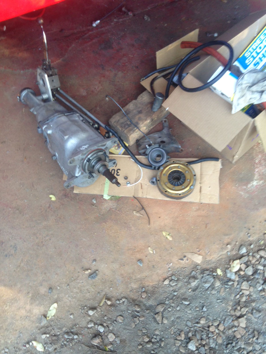

Now I'm waiting on my Super T-10 to be rebuilt then I can drop the engine and trans into place and start wiring.

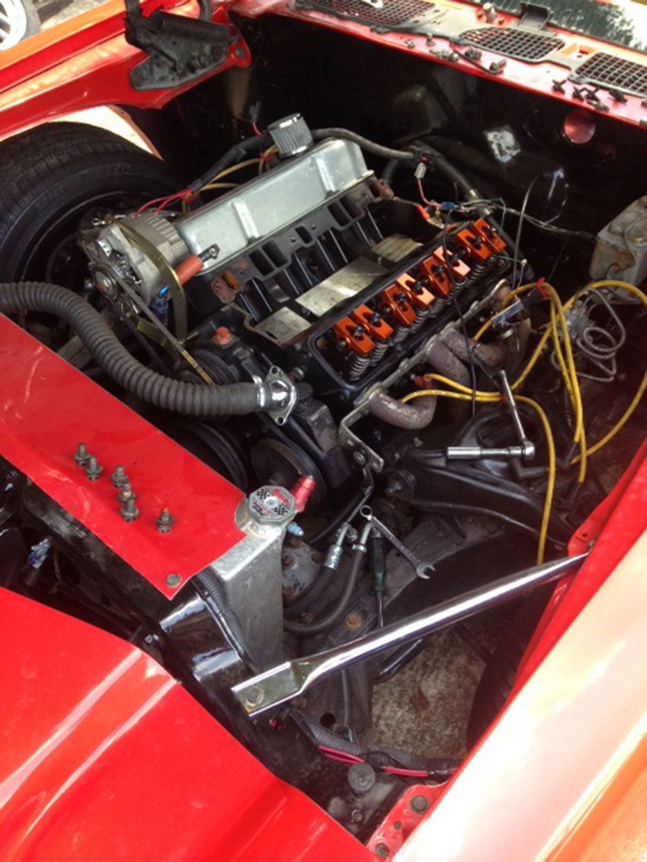

Well, the car is getting really close to being able to move on its own power. The last 20% of this build has really started to drain my wallet.
But, engine is in and wired up, heads lights and blinkers wired, radiator I bought from Bill Elliot is in with brackets I made, and front suspension is done.
I went with a 650 LF and 600 RF spring with Afco 7/7 shocks and spring height adjusters.
I bought a Super T-10 from a local latemodel racer, and no I'm not running the quarter master clutch.
So all I need to drive this thing around is a fuel tank, finish fuel lines, power steering lines, and driveshaft. My goal is to have it dialed in for the Optima race at Charlotte.

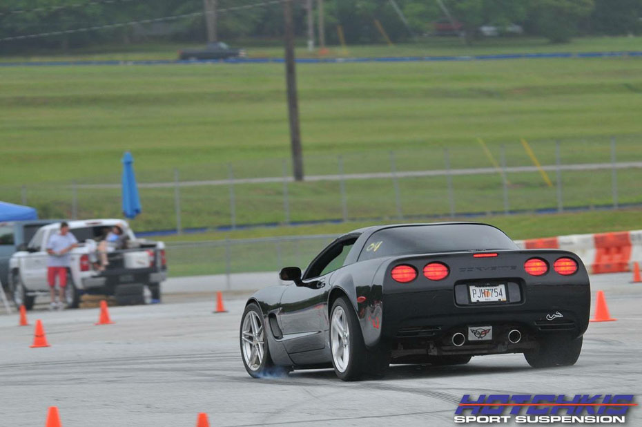

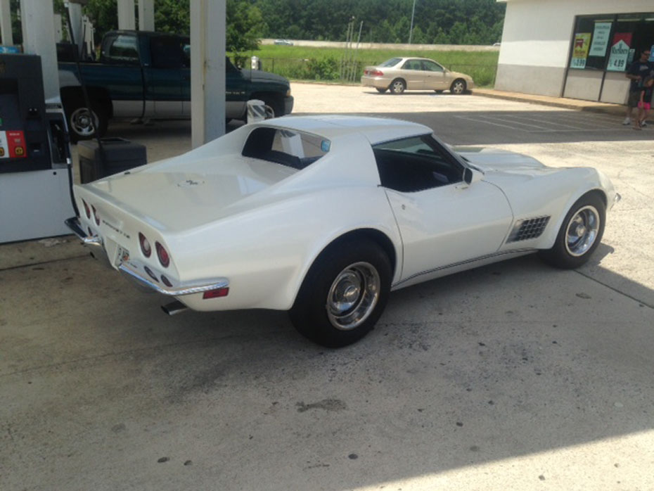

And my girlfriend and I got some autocross in in my Corvette the other day.

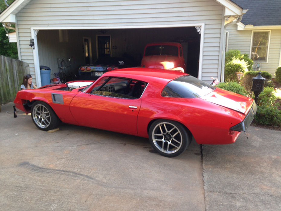

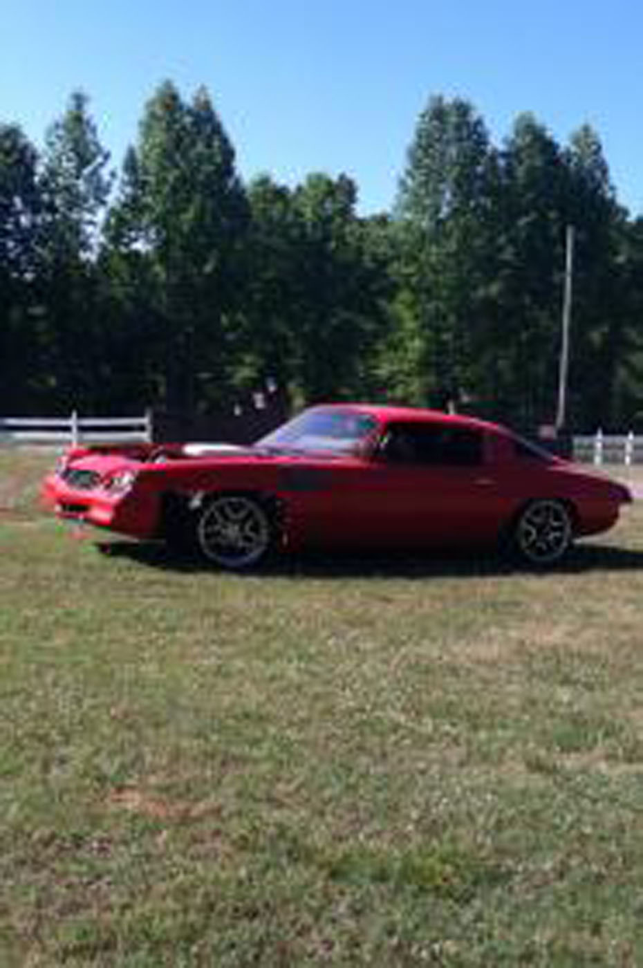

Well, I have good news.
After 10 months of work and money spent, I finally drove the car under its own power.
Feels awesome to finally drive it. It still needs a lot but it's coming together.

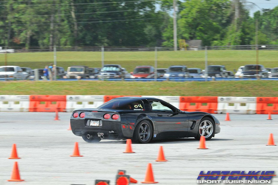

Went and did some autocross down the road at the Chevy High Performance Nationals for the 3rd year. Hotchkis put on a great show that was really a good time to be at.
I was hoping to have the Camaro here but she wasn't quite ready. But the Corvette took its place well.
