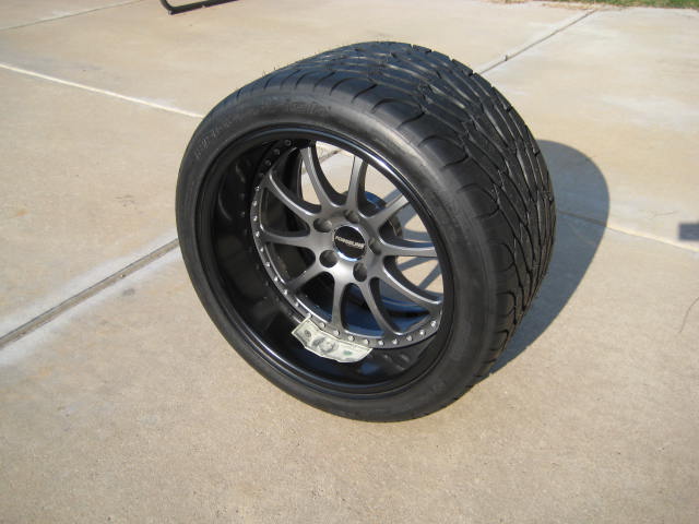

> Forgeline 18” 3-piece billet Wheels

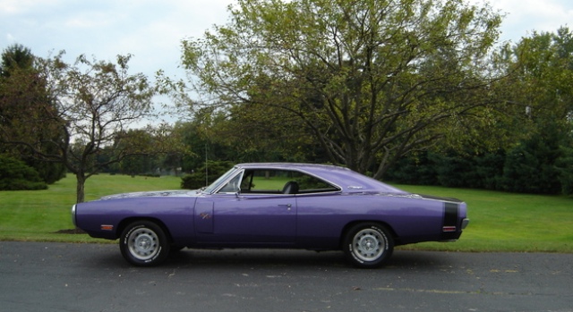

The car will look essentially like the attached pic - except with the Forgelines. Haven't decided if I will do anything special with the paint yet.
1970 Dodge Charger: Viper Gen III V10/6spd, RMS Alterkation, Moser 60, 4x14" Wilwoods, RMS Street-Lynx triangulated four link. Currently mocking up...
