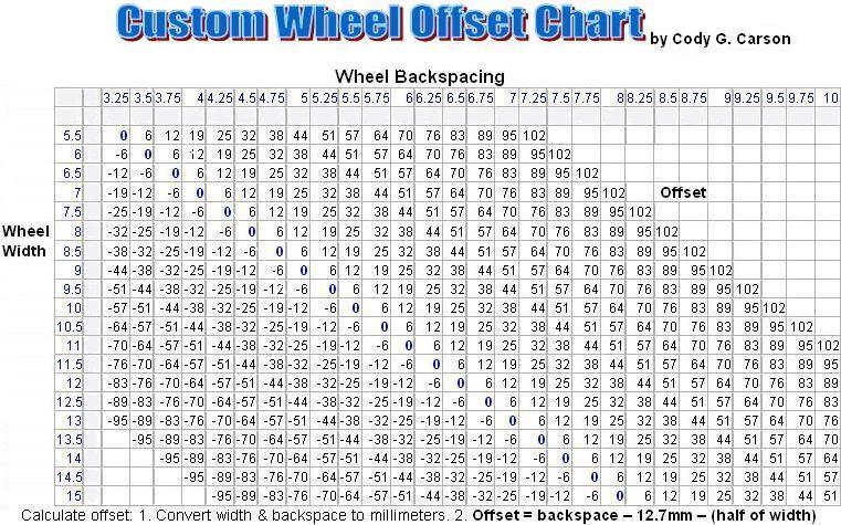

I'm still trying to figure out how to convert backspacing to offset.

I just need to know what offset and sizes will work?
I have a 67 camaro. I know I need to get a 18x8 4.75bs in the front and around a 18x9 5''bs or a 18x10 5.5bs in the rear.
Would the 18x8.5 +56 offset work in the front?
And what about the 18x9.5? 56+ offset or something else.
Any wheel/gurus feel free to help me out here. I still haven't moved on my build since Nov. because I'm still trying to plan it out.

just figured out those offsets won't work.
can someone please help me convert BS to offset?
18x8 ---- 4.75''bs
18x9 -----5''bs
18x9.5 ----- 5.5''bs
18x10 ----- 5.5''bs
-Dan

https://lateral-g.net/forums/atta...4&d=1251483251

WOW.... thank you soo much!

5.5" bs with the 18x10's to gonna be a bit to much. I would go 5.625 or 5.75.
