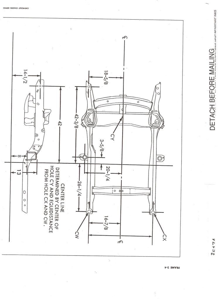

Does anyone know the dimensions of the OEM subframe? I'm getting ready to clean mine up, weld the seams, etc and wanted to take some measurements to make sure it is square. Might even use them to build a jig for it.

Here you go!

Awesome! Thanks. When I blew the other up it distorted some. This is much easier to read.
Seeing as though this thing is 40yr old I'm guessing it might be a little out of spec anyway.
