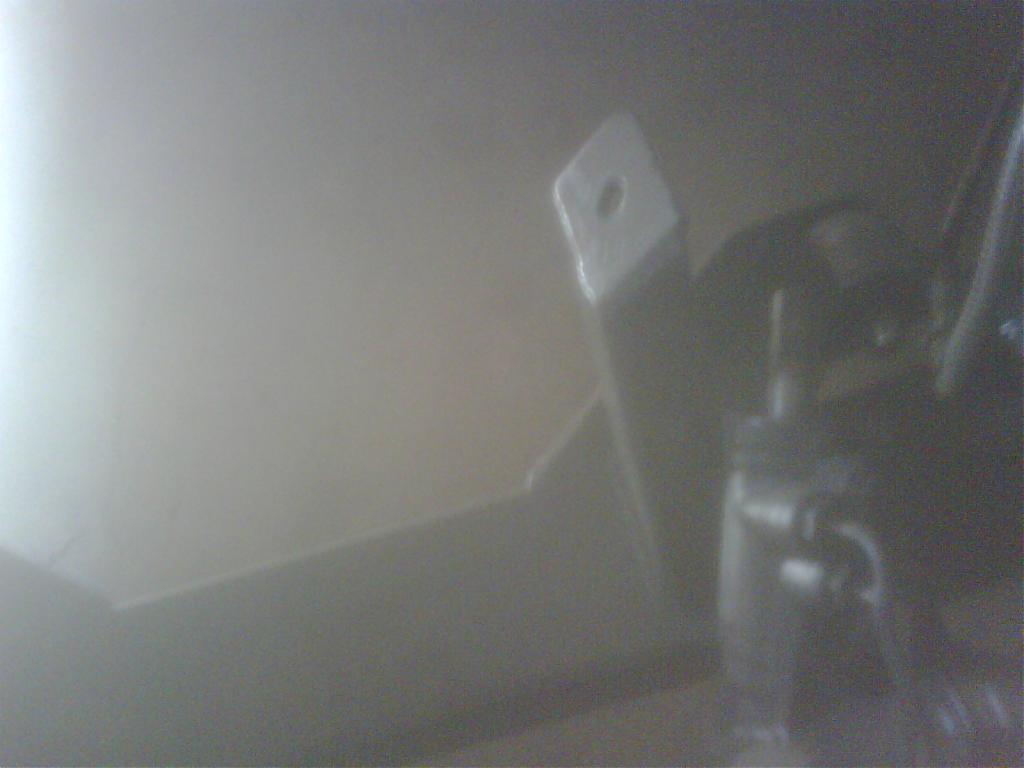

Hello, I have a 67 Firebird with a Wayne Due subframe that was set up for a Pontiac 400. (frame mounts are welded in, with single bolt Pontiac style mounting) I am going to install an LS engine, and I was wondering if anyone makes an engine mount kit that will bolt to the single blot style Pontiac frame mount. All the ones that I've seen are for a 3 bolt style Chevy. Any help you guys have is appreciated.
Thanks,
Rob

I am running the same subframe, but I cant quite tell from your pic how yours is set up. Email me some better pics to [email protected]. If its like mine, you can make your own ends and use the chevy style motor mounts with adapter plates. I had some postiac motor mounts in my swap meet parts which i sold, but they had 4 bolts i believe. Cant quite picture your setup. Scott
