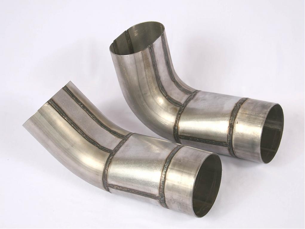

Originally Posted by speedjohnston View Post
If you have ground clearance issues, you can check out spin tech. They have oval pipe for added clearance. They also sell mufflers, bends, transitions and made to order custom pieces.
Thats exactly what I did. 4" oval pipe headers to mufflers, 3.5" tailpipes. Several custom pieces made by Spintech. One was a pair of 4" round to 4" oval transition bends. And the angle of the bend was specific to my setup. Thats how we got oval collectors on my custom headers. Spintech was great to deal with. Stuff got made right the first time and turnaround was very fast. I never would have gotten the car as low as it is without the oval pipe.
