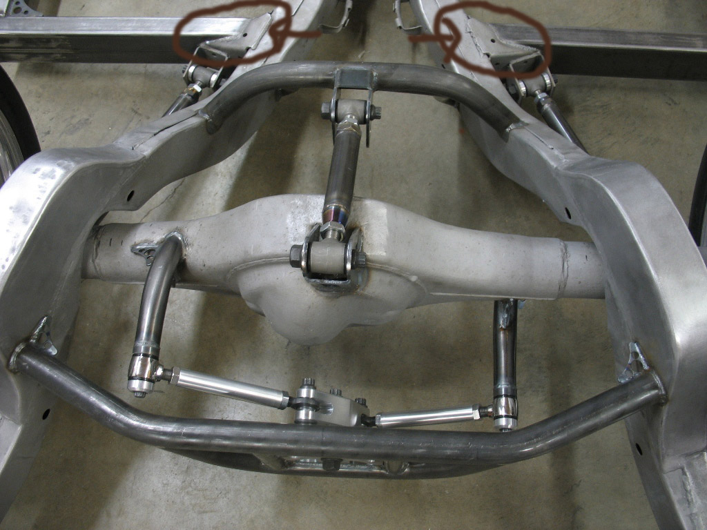

I designed a 3 link for it around the stock lower suspension points, but it is fully adjustable and designed to work (thats what the computer says) Even all the adjustment points are on arcs so you dont have to lengthen or change the bars!
Watts this???? an adjustable roll center and watts linkage!!!
the front suspension is based on stock, with air ride lower arms modified for newer b body tall spindles, with custom upper arms with delrin bushings and offset shafts to set some nice camber. The upper control arm mounts were also removed and welded on on an alignment machine at "ride height" so set the base geometry.

Awesome start.Chassis work is really nicely engineered.Can't wait to see more. Scott

I LOVE your build. Subscribed! I have always wondered why no one pro-tours Falcons. Now I found one! I like what you have done. front suspension is cool too. Nice take on a watts linkage mount, its different and cool.

Do yourself one favor, re-weld the factory welds where the lower control arms meet the frame. I once jammed a beautiful second gear in my old '61 Impala and yanked one of those bracket right off the frame. A very scary ride after that as the lower arm dug into the asphalt! The factory didn't always get good weld penetration on those it seems!
