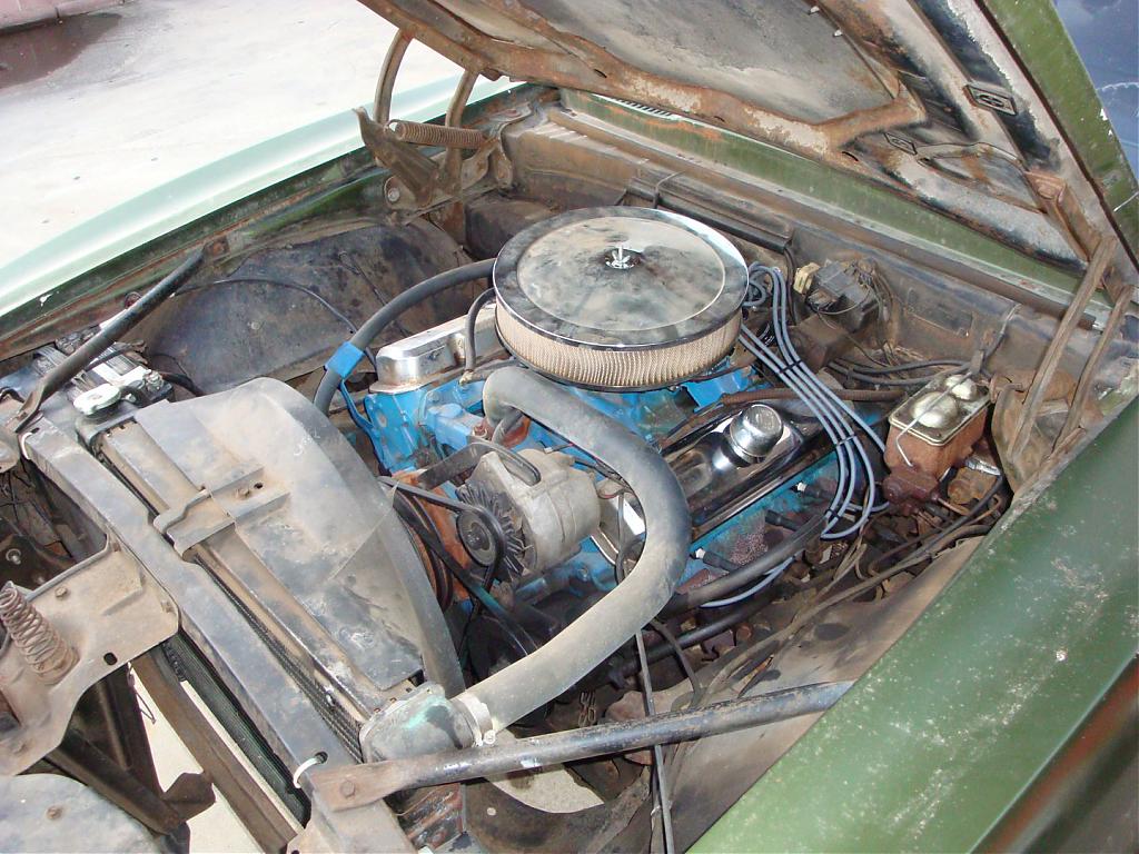

My '67 Firebird. I bought this a little over a year ago up in San Jose. It was an unrestored car, which I liked, but it was obviously rusty. I bought it because it was an original verdoro green '67 bird with manual trans and was well equipped. It appeared to be a 400 car, but as I later learned, I misread the body tag and it's a 326HO car. A '67 Verdoro green 400 4 speed car is my holy grail of first gen firebirds. It is what I ideally wanted to work with. This car is close enough.
I drove it locally for a year or so until I was able to sell my previous project and generate the necessary $$ and space to start this build. I've since been collecting parts and have disassembled the car. The car body is currently at the strippers (hence my other thread "went to the strippers")

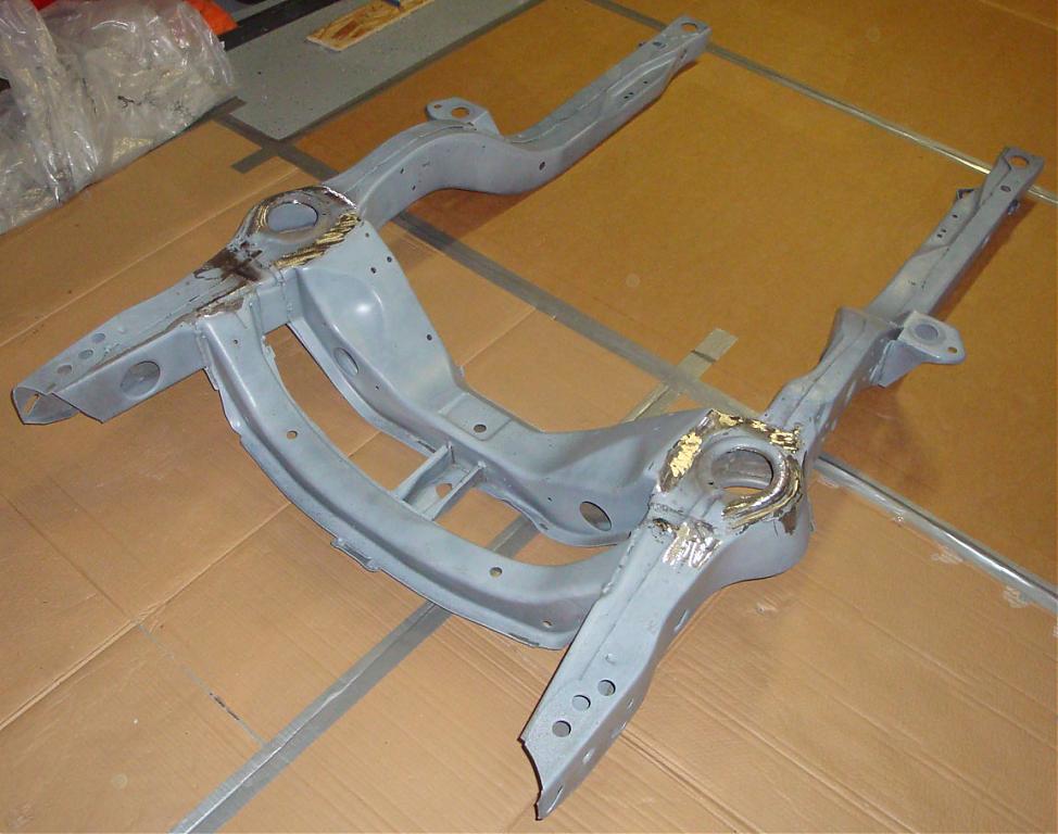

Today after work I started chopping the subframe for the DSE Stage 3 front end kit mod.
I'll add some pics with description below:

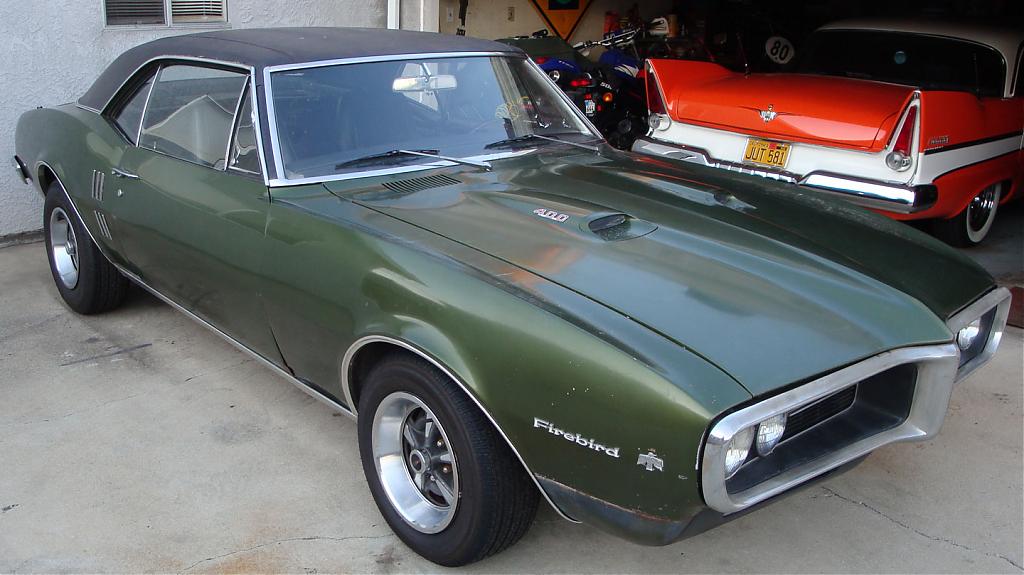

This is what the car looked like when I bought it. Not too bad from 10 feet, but that 1969 camaro spoiler had to go.

Default DSE Front End part 1

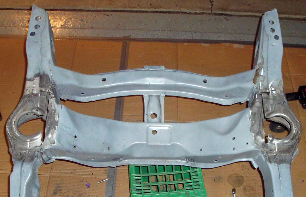

I posted pics of the chemical stripping in another thread ("went to the strippers") so I wont repost those pics here. However, today I started the DSE subframe mod by chopping off the old suspension mounts and widening the holes for the shocks. I don't have a real shop to do this work- just my neighborhood garage. As we're new to the neighborhood, I'm sure my neighbors will quickly grow to dislike me and my Firebird for all the noise I'm going to make as I build this car.

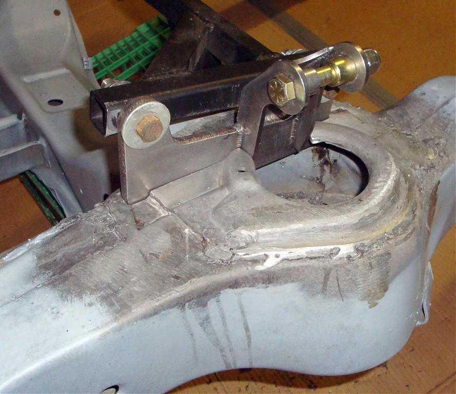

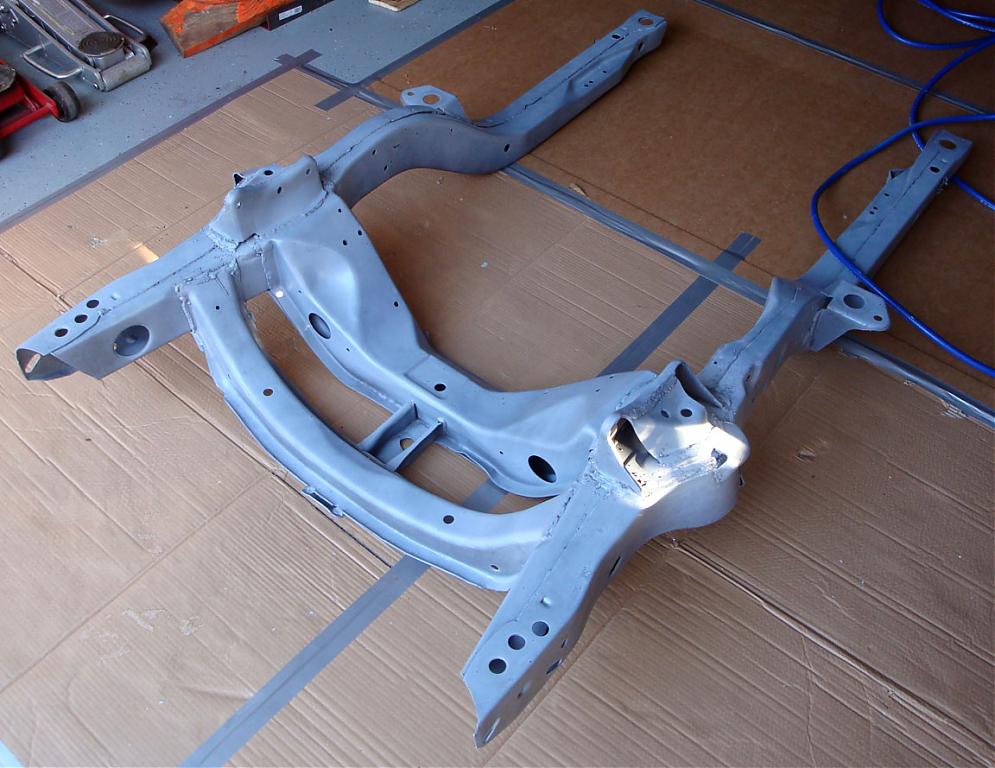

Default progress on the DSE front end

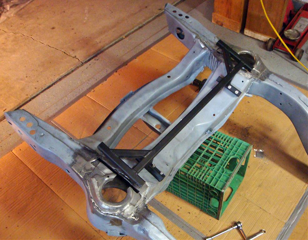

I was able to cut the holes in the subframe for the new suspension components. It's now ready for welding- which my neighbor will be helping me with later this week.

Its looking good. Are you going to have him weld up the eams on the sub frame?
Hi Wayne:
Yes, those will eventually be addressed. My neighbor tack welded the brackets on tonight. (in turn I'll be designing a logo for him) The plan is to get the subframe on the body, measure and locate where the wheels will be, then we can measure and confirm everything is where it should be, and modify/ adjust as needed. Once we know it's all square, then final tig welding.
He built his own '67 camaro, and this is how he said he did it, so I'll trust him.

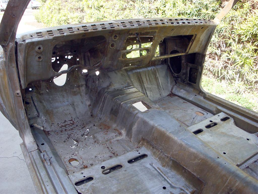

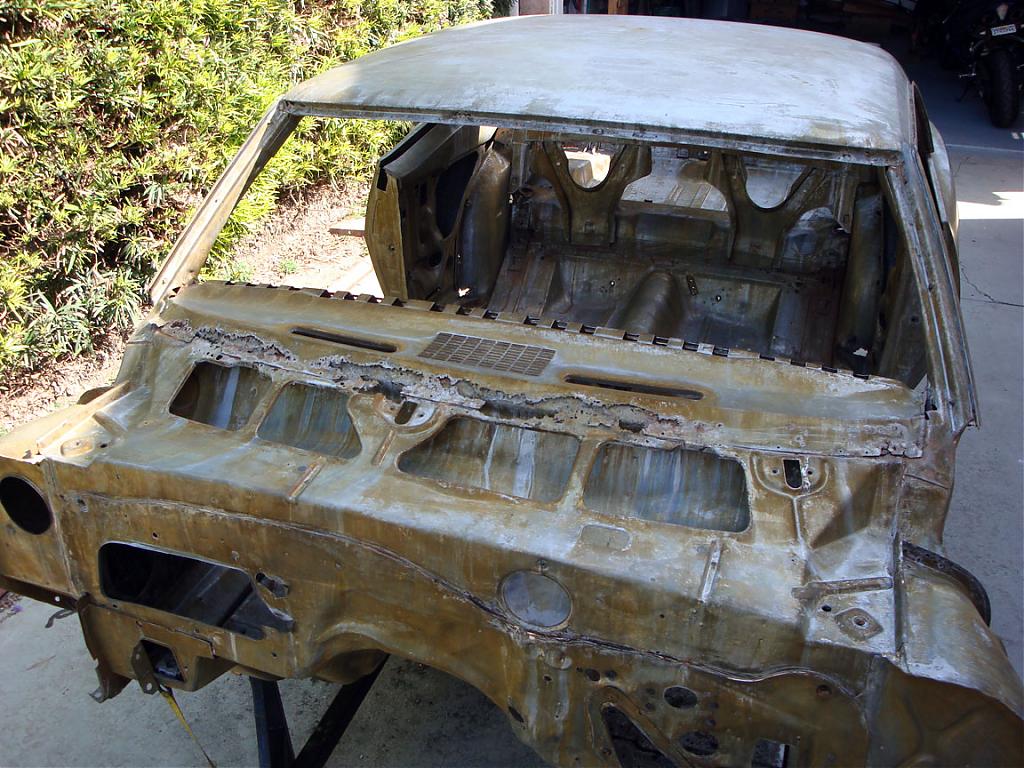

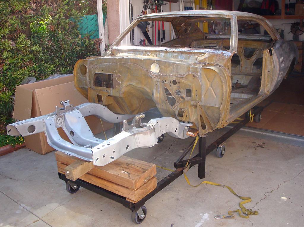

This Friday I brought the car body back home from the strippers. I was a bit disappointed that I could still see rust on the car despite 2 dippings. I was expecting the body to be void of all rust- like all the sheet metal seemed to be. Apparently, my car was really, really rusty. They did offer me to bring the car back for one more dipping after removing some of the rusted panels.
Attached are some pics from the weekend. We tested out my neighbor's new plasma cutter by chopping out the rear wheel wells. I spent Saturday cleaning up those cuts/ drilling out the factory spot welds. I also had time to remove the top dash panel. I still have to cut out the inner cowl panel.
I also installed the subframe. I need to align it so we can start measuring and create the subframe connectors, as well as the inner tubs.
