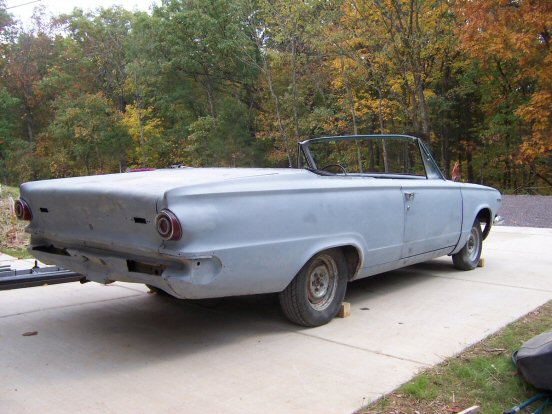

anybody running one? im trying to think of things to lighten up my 64. ive found an aluminum case, and im considering a lighter weight drive shaft. ive been told depending on the track your at they may not be legal, any reason way? i assume there as strong if not stronger than stock shafts. for anyone runnung one, have you had any issues?
