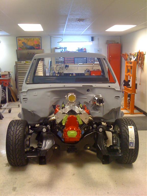

I would like more control than the basic Avenger system does. Thats why i was choosing the dominator cause it has it all in one box. U dont have all the add ons. IDK will have to talk to somebody that runs one and see. I already have all the stuff( intake, throttle body, etc) just need the computer and wiring. Thks
