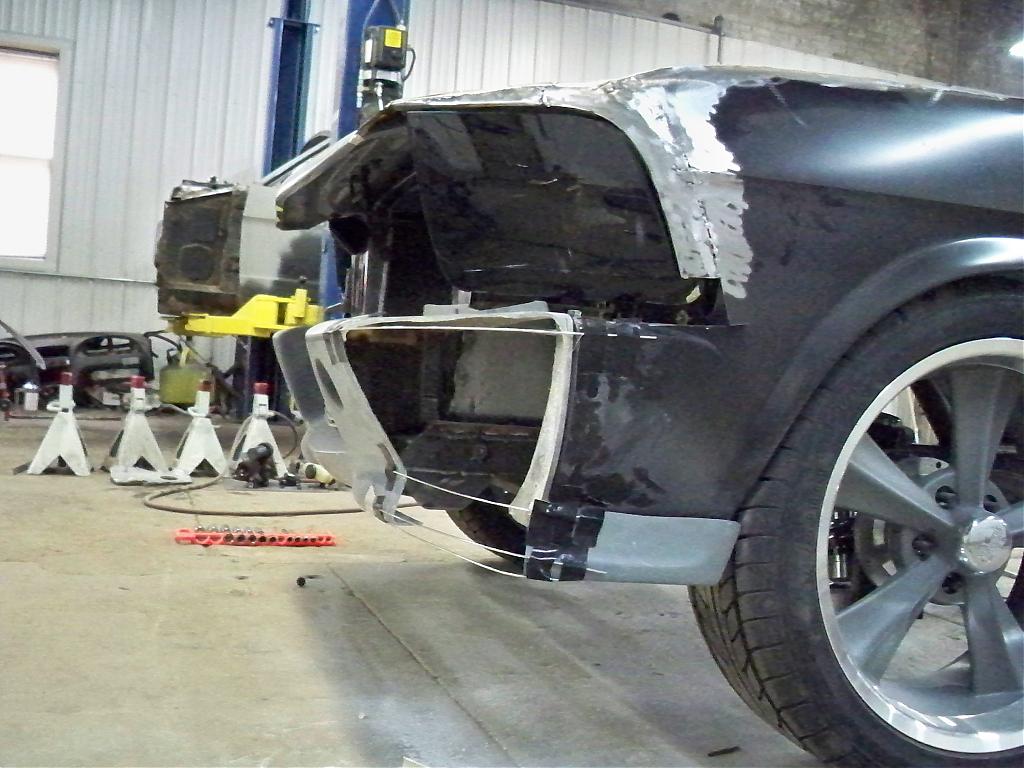

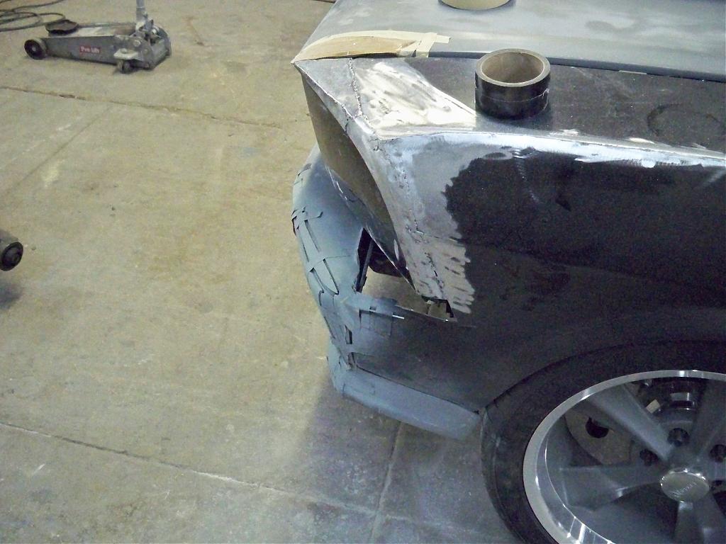

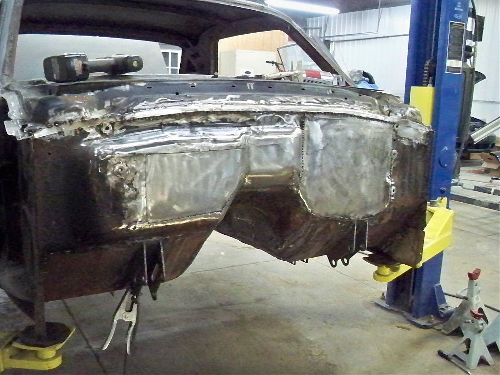

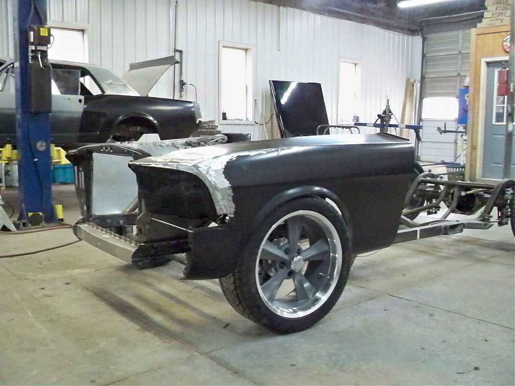

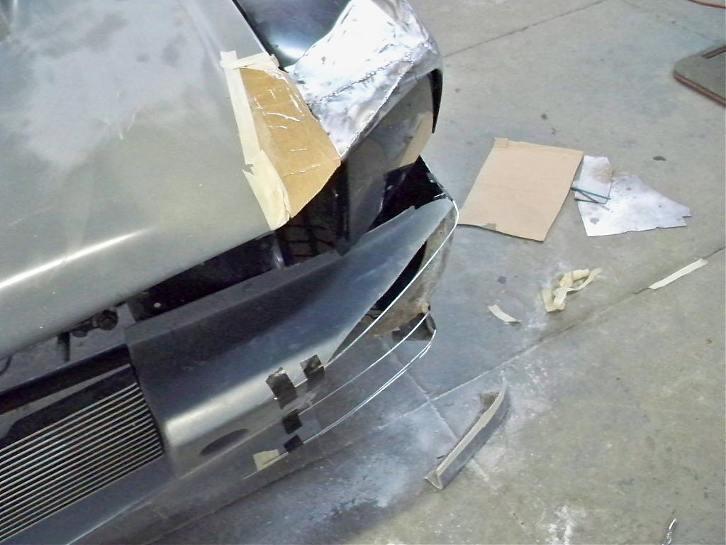

I've had some alone time with the car... finally got the proportion figured out with the late model GT headlights..... Thankfully the facia is 'glass and is easy to mock and rework. New firewall, more welding, and general dinking around to make everything work together. Brian Finch gave me the great tip to remove the distribution block from the side of the Hydroboost and tap the return line, giving me tons of extra lateral fit. ( not tons, less than an inch, but that's all it took. ) Now it looks like it'll fit between the cam cover and the hood hinge. Thanks Brian! One day per weekend is not enough... I feel a tickle in my throat... gotta call in sick a couple days! LOL!

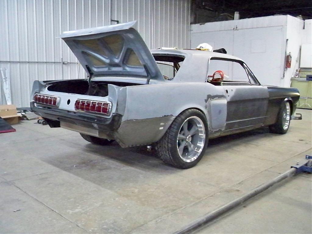

I gotta ask about the frame rails. Those exhaust cutouts look like they really compromise their integrity. Are you going to reinforce them somehow? Or are you leaving the rocker panels intact to support the car?

Thanks for the kind words! The exhaust cutouts are made from 1/4 inch thick tubing, which is substantial, and yes, if the frame was the only thing giving the car strength I'd opt out of creating weak links at those welds, but the unibody is still intact and gives extra support. I'm going to reinforce them at some point when I figure out exactly what I'm doing with exhaust routing, maybe plate with steel above and below the opening.... something for my peace of mind, although Muscle-Up says it's fine. I'm using the side-exit Spintech mufflers since they're lower profile and will give the look I want and not force me to weave exhaust tubing through the four link... that's a few weeks down the road if everything goes well.

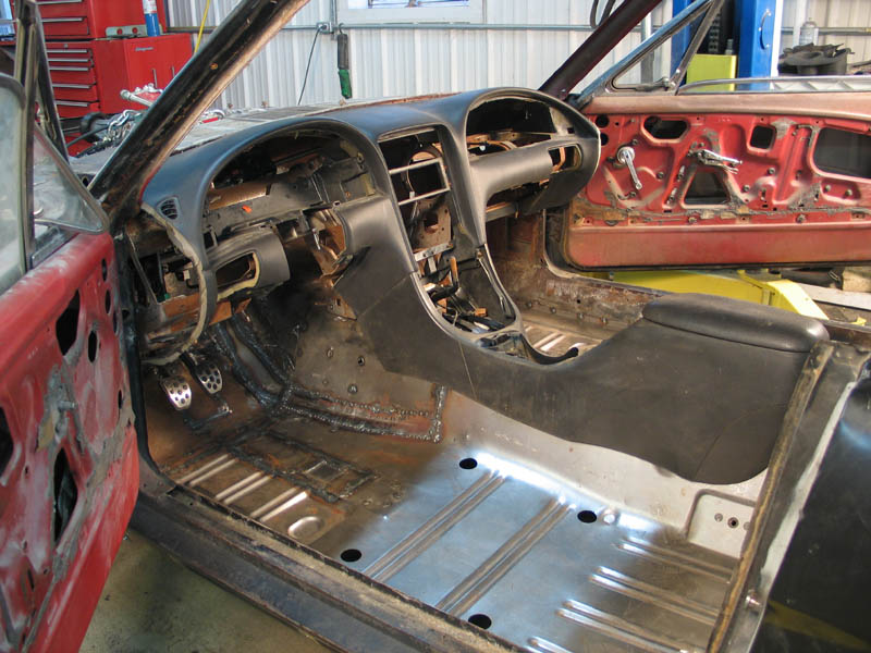

Default cobra dash in 66 Coupe
Had a chance to work on the interior..... got the donor car (04 Cobra) dash fit into the 66 Mustang's seemingly tiny interior. It's one of those things that seems like it wont work until you get out the cutoff wheel and sawzall... I had to trim about 6 inches off the front edge, and an inch off each side, alter the main support bracket, and trim the side mounting tabs to squeeze it into the factory cowl space (after the OE dash was trimmed out and sacrificed). Since I'm using all new electronics, this is going to give me a way to access the main harness and dash connections, as well as a cool look that still looks "Mustang"

Posts: 112
Wow!
I love the way this car is going!
I check every day hoping for an update, love the headlight idea, and now the interior! I cant wait to see this one finished!
