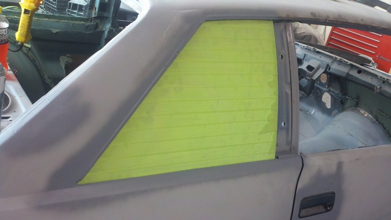

The metal fab on the body is mostly done except for the bumpers and head lights. I plan on making mirrors from '88 Buick Stationwagon mirrors. They are plastic so i will just copy it in metal so the base doesn't look funny. THe headlights are from the new Ford trucks and Colorado headlight lenses. Flush mount glass all around. The quarter windows were really easy to do since there it had a thick moulding. I just made an 'L' channel for the bottom and the glass fit nicly where the moulding went. He didnt want shaved door handles. I had a set of Honda Crx Doors laying around so I used the flush handles from that. I'll use the rear handles from the '91 civic 4 door so there isn't a key hole. Sorry all my pics wouldnt load. Of course they are the fab pics.

Fab Pics
