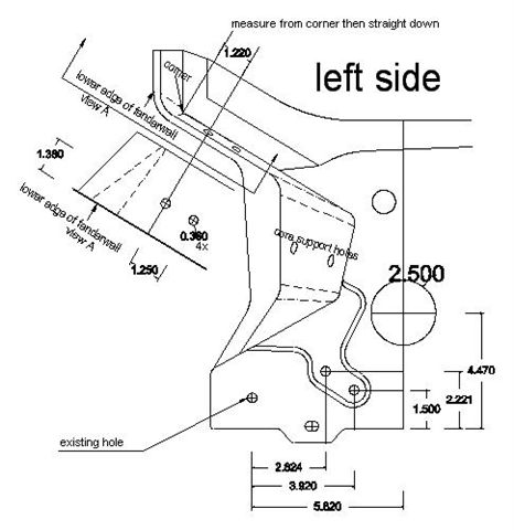

I have a set of non-RS fender wells and need to cut holes for a DSE RS Electric motor conversion. Does anybody have a template? Heard that it is in the Camaro assembly manual. Or does anybody have photos?

stock RS left and right side

Awesome, just what I needed, thanks Vince!!!!!
