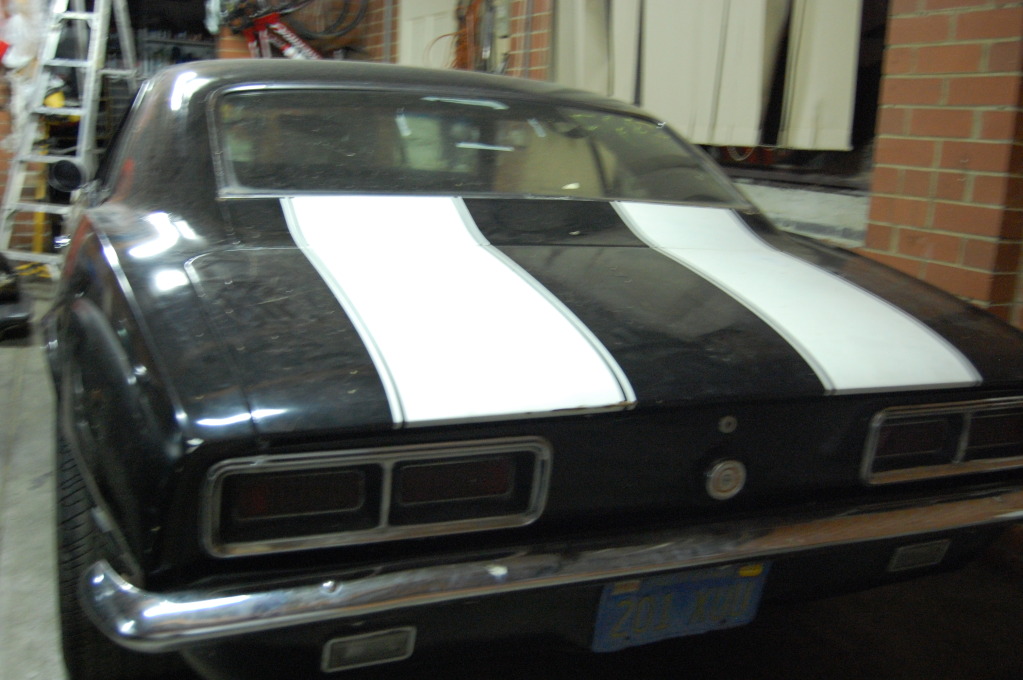

I have been lurking around in the background for a while and thought its about time i started a build thread,i am no stranger when it comes to Camaros having previously,owned around 8 or so 1st gens
this time i thought i would build something along the lines of a pro tourer
what i am starting with is a typical basket case that needs a fair amount of work panels.paint trim drive-line,
these are the plans i have for the old girl (XP836 BUILD NAME)
IT IS A 1968 RS SS

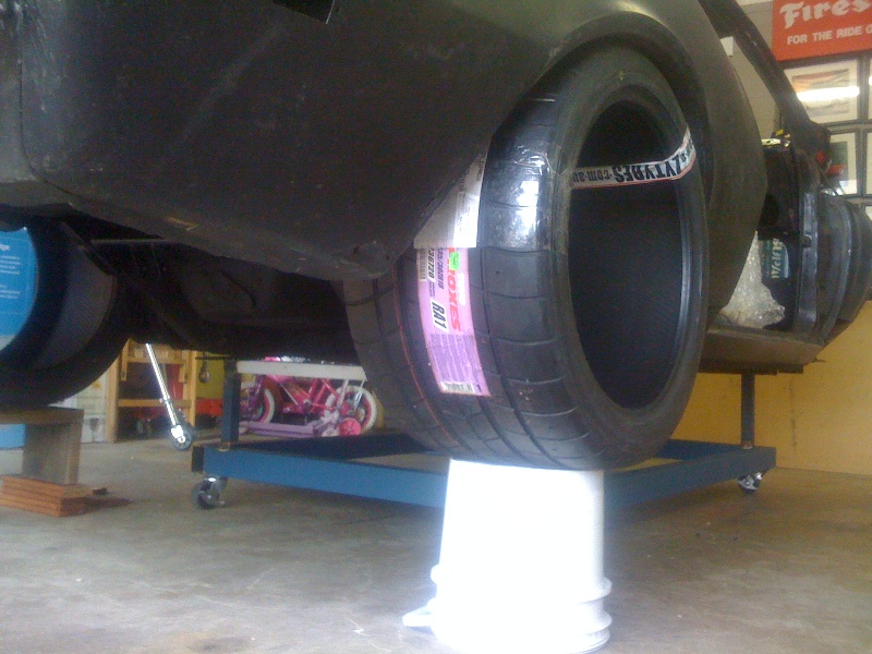

for the rear i have already purchased an air ride complete coilover setup
ihave purchased my wheels which are vintage wheel works V45 in sizes
front 18x8 with a 4and3/4 backspace tyre toyo proxy ra1 245/40/18
rears 18x11 with a 5 and 3/4 in back space toyo proxy ra1 335/30/18

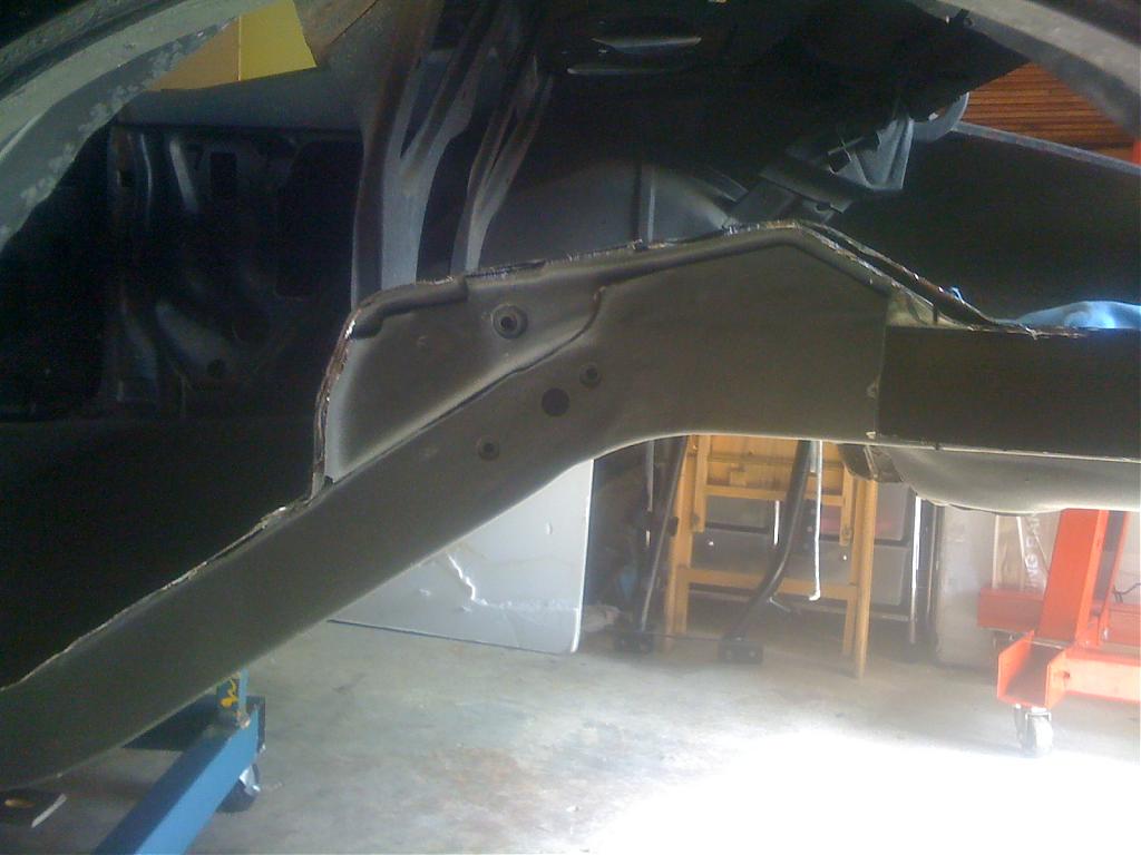

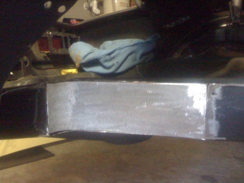

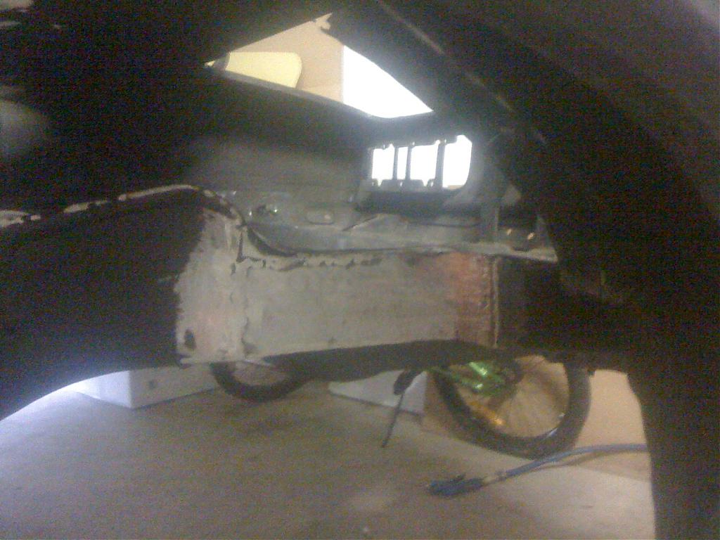

ihave completed the mini tub install (tci setup just clears)
here a few pics of the old girl sorry about picture quality iphone
