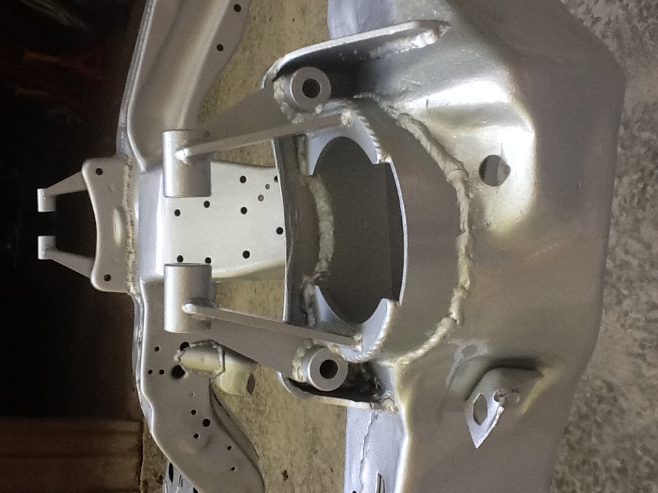

Thanks guys! Here's a chassis pic. Enjoy.

Great work! Thats one way to stiffen up that Chevy frame.More pics please!
