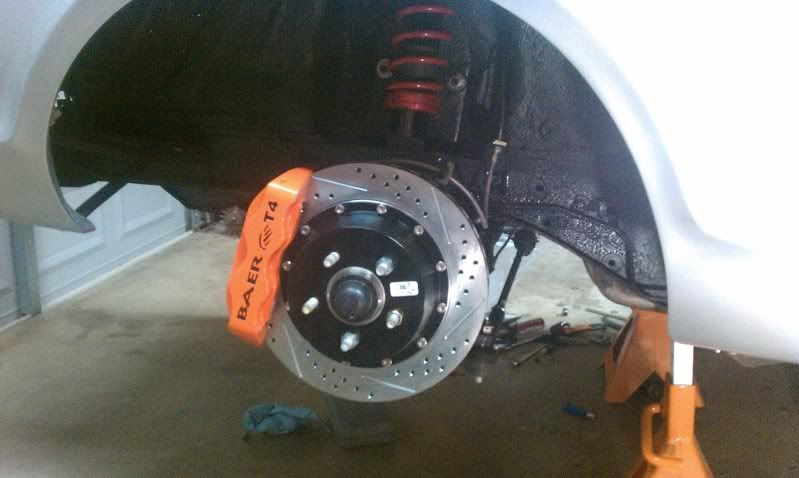

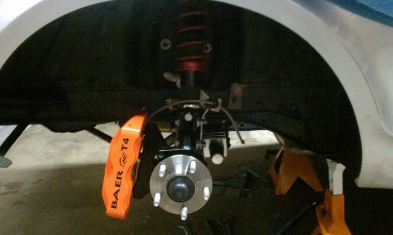

used my cousins 331 from a foxbody he had to do my front accessory mock up
bottom end of the 302 I will be using, kind of like putting lipstick on a pig, the area the mains bolt to are weak and not really convinced these girddles work but it was on there and im just going to go ahead and leave it.
used 6 piston w6A kit re-drilled and now fits my spindle/hub setup

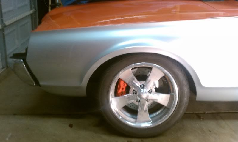

Used a Mustang Quadralink that had to be modified to accommodate the extra wheel base length of the cougar.
Went with a modlite floater from speedway, I actually was in the area heading to disneyland and Ken gave me a tour where I got to see my rearend housing being done.
A friend of mine who has a paint shop performed the install of the quadralink, there are a few little spots where added gussets need to be finished , I will have the task of finishing the tubs and doing the subframe connectors.
This is a 17x8 with a 255/45/17 mounted and I have about another 1.5" on each side of tire clearance.
