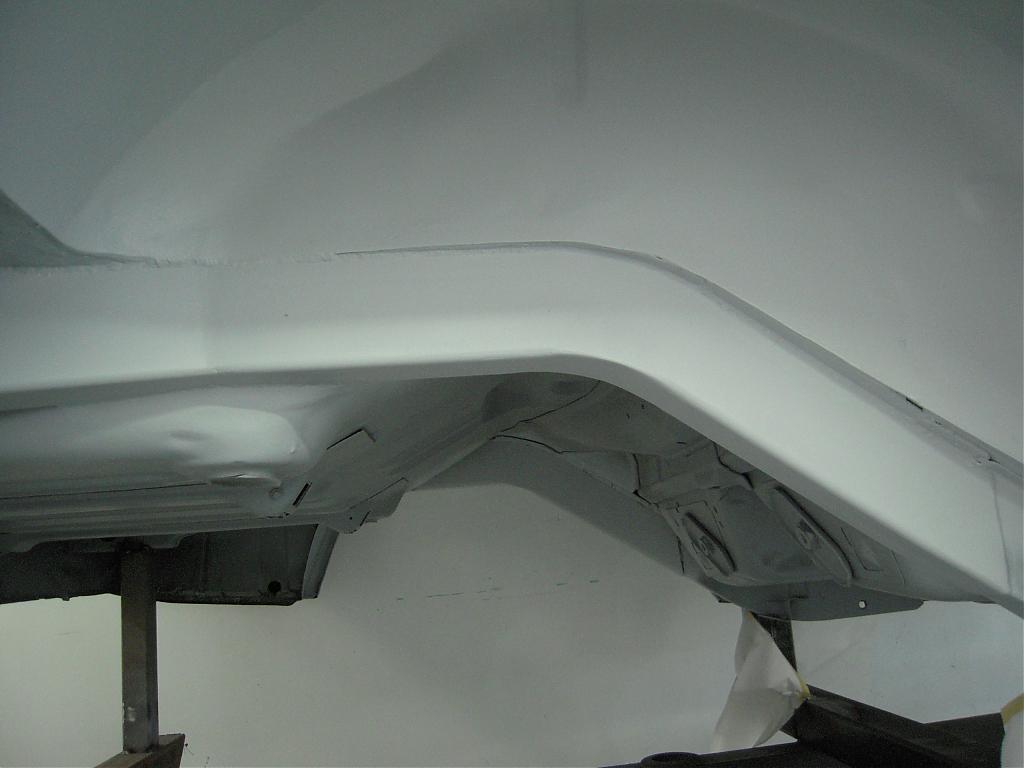

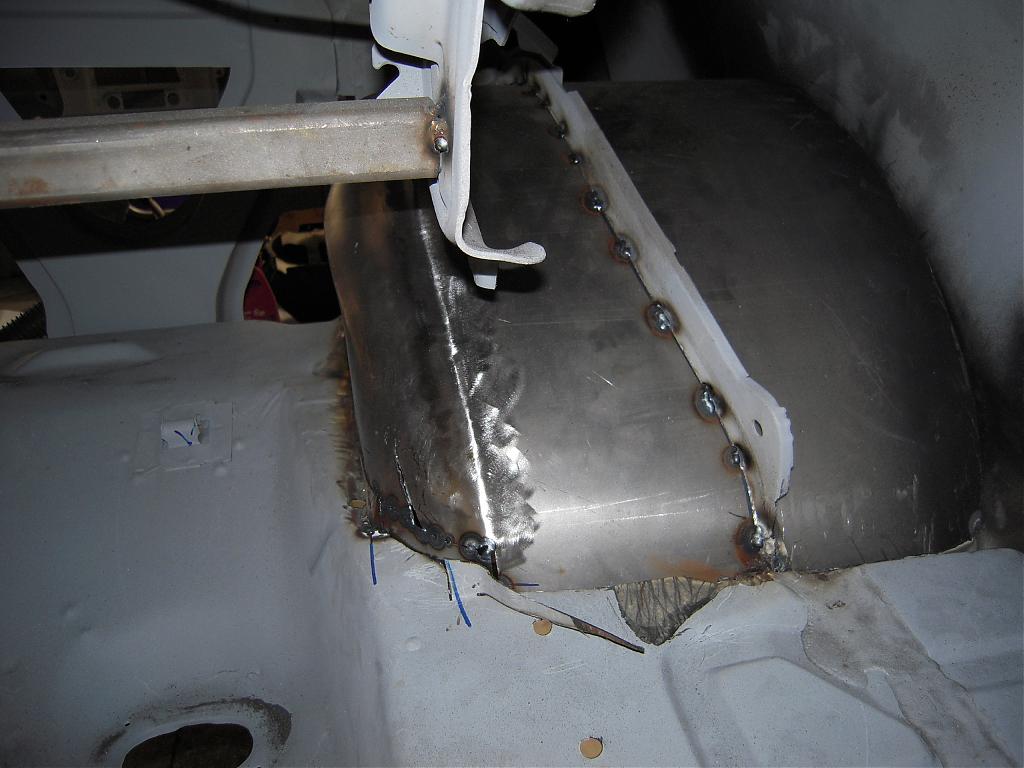

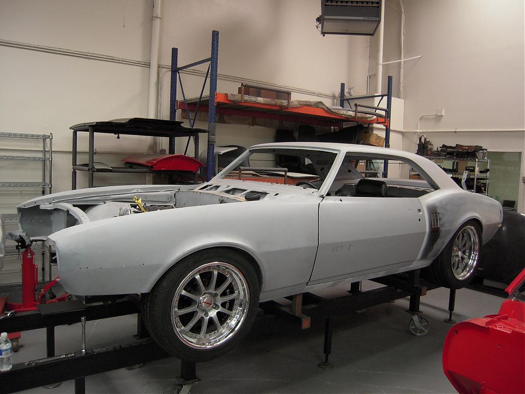

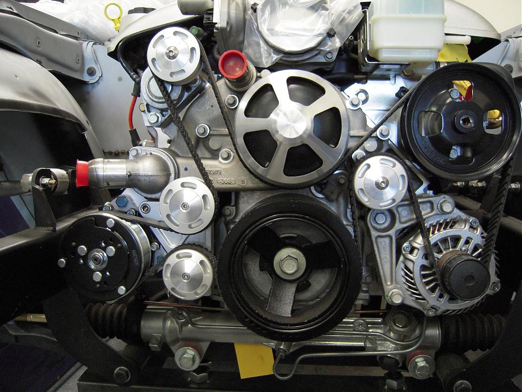

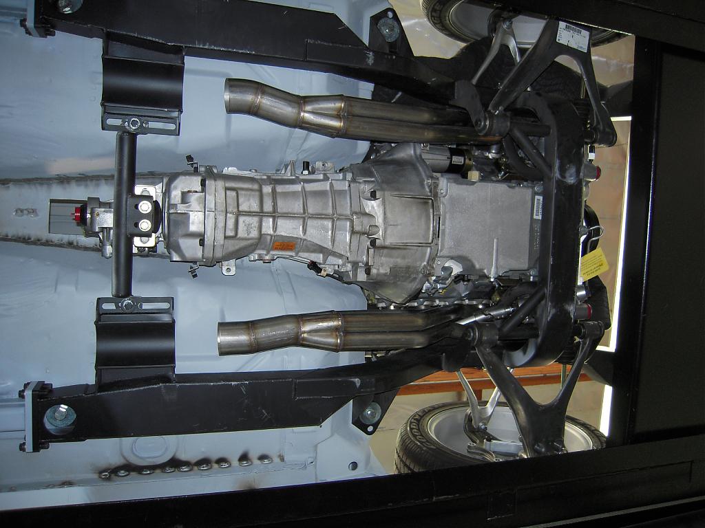

Introducing 68 Firebird build to Lateral G!
Art Morrison Sub-Frame
LS2 out of 2006 GTO with six speed manual transmission
Wilwood W6A with 14.25 rotors, pedals, & Master cylinders
Forgeline Wheels with Goodyear tires
JCG Mini tub, body modifications, stretch rear qtrs, removable dash, rear suspension with Art Morrision 3 link suspension & Watts link
Custom headers with exhaust
Lots of cool one off machined parts!!!

Love the stance - what size tires are you guy's running.
marty-mj
Old 09-15-2009, 07:11 AM
Cris@JCG's Avatar
Cris@JCG Cris@JCG is offline
Join Date: Apr 2009
Location: Oxnard, CA
Posts: 1,915
Thanked 4 Times in 4 Posts
315 40 19 tires with 19x12 in the rear.. 255 40 18 tires with 18x9 in the front
Old 09-15-2009, 09:16 AM
syborg tt's Avatar
Posts: 8,449
Thanks: 5,669
Thank you - looks perfect

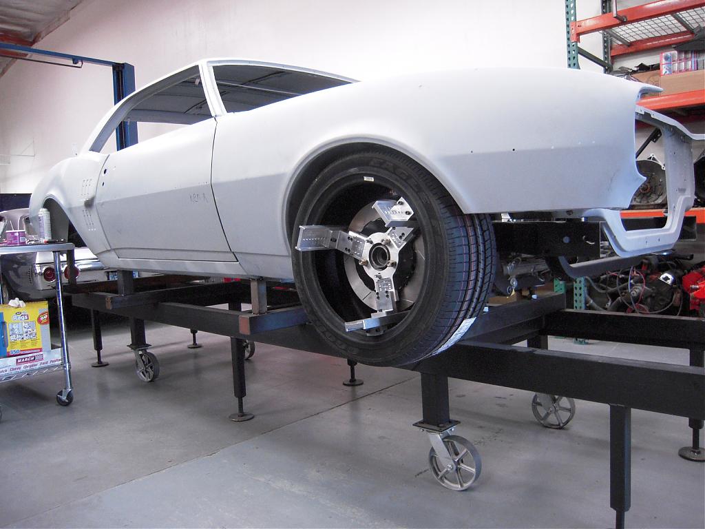

Here are some pics on the suspension on this build & finally got it off the jig & rolling on wheels!!
